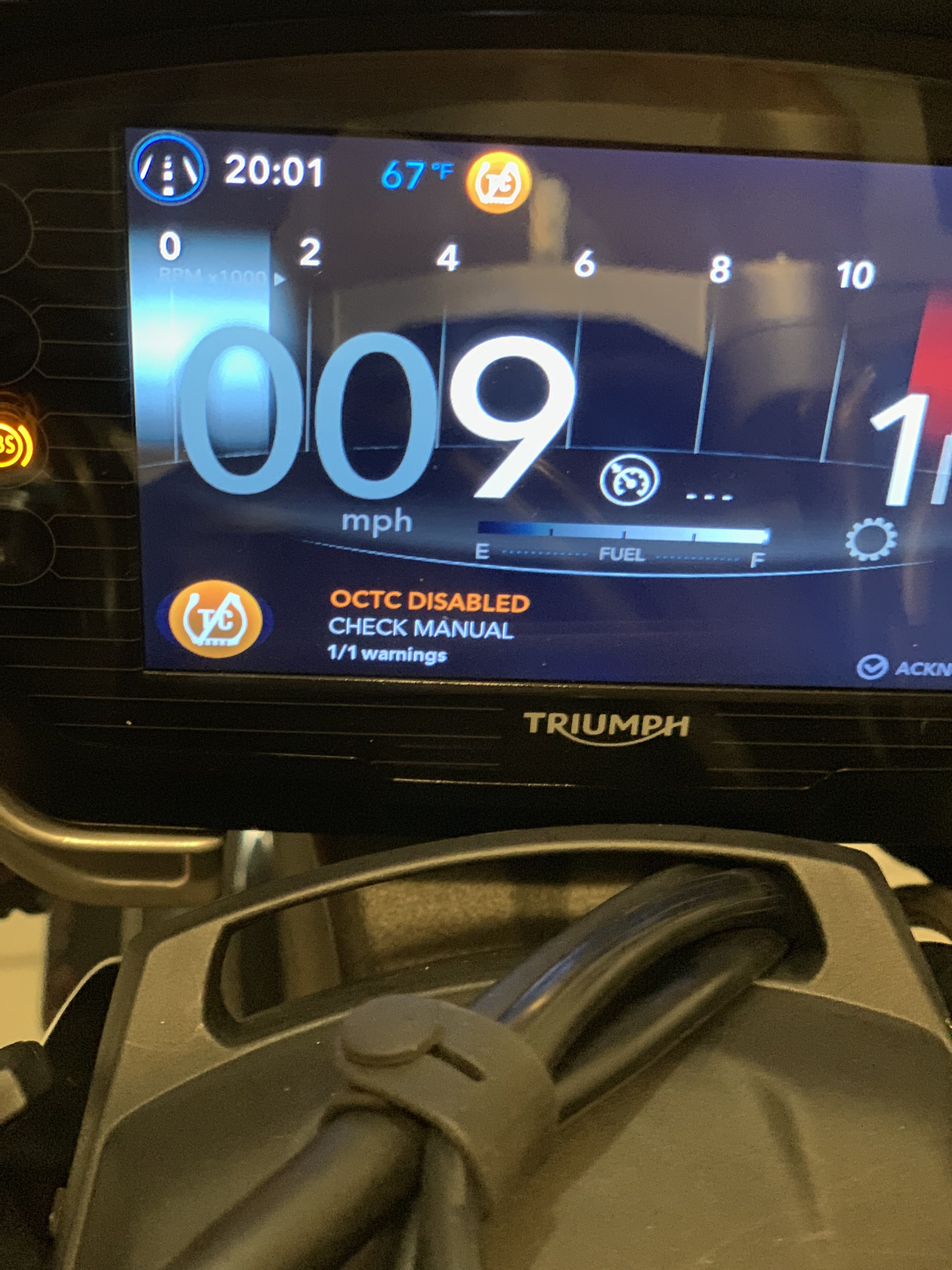

    Hi I just got an error message OCTC disabled. What does it mean?

    Oil change Traction control.

    Hi Mohammed and welcome in. Re the OCTC message do you have your bike's owner manual? It might be listed in there?
    My guess would be it's something to do with the traction control function.

    i did check the manual and didn't find anything other than TC. The bike is on a front and rear pitbull stand running and it's on first gear and in about couple of minutes I get that message.

    That will be almost certainly why you are getting the error message. The back wheel will be turning - even only very slightly - whereas the front is stationary. The TC and ABS systems work by comparing front and rear wheel speeds.

    There was something posted on this a while ago. It’s “possibly” something to do with an oil change.
    “Triumph have established that the cause was a vacuum created in the oil distribution system which blocked the oil flow. There is now a correct procedure to follow when changing the oil and filter - done in a specify order to prevent the vacuum occurring.
    Triumph will be releasing a service bulletin to its Dealers within the next 48 hours to address this NOW KNOWN PROBLEM which has also manifested itself in several other oil changes on different 2018 Triumph Speed Triple RS motorcycles. If you have a new RS going in for an oil change, make sure the Dealer has the bulletin and is aware of the vacuum problem“
    This is the link to the previous post. https://www.thetriumphforum.com/threads/octc-fault-code.14390/#post-194431

    Welcone aboard Mo. Yes. oil change and traction control. If they don't go off in normal operation get along to a dealer tofix it for you.
