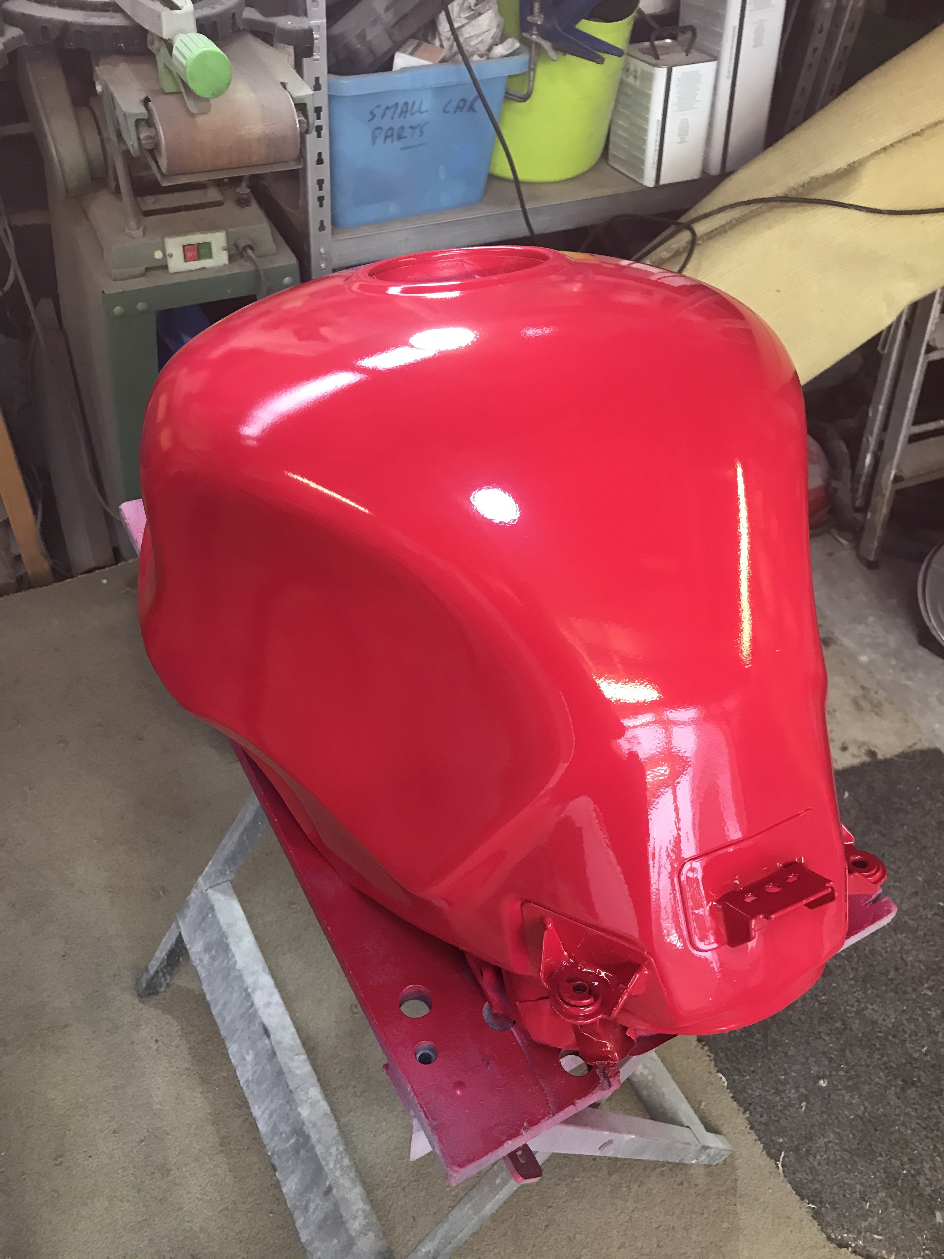

    Had the first stage done yesterday and it’s looking great! A bit more red at the minute but the pink effect will come in with the Pearl metallic once that goes in. It’s bloody lovely! Just a sample so far.

    Looking good!
  11. dilligaf
    Looks like it’s gonna be a smart finish when you’re done mate :cool:
