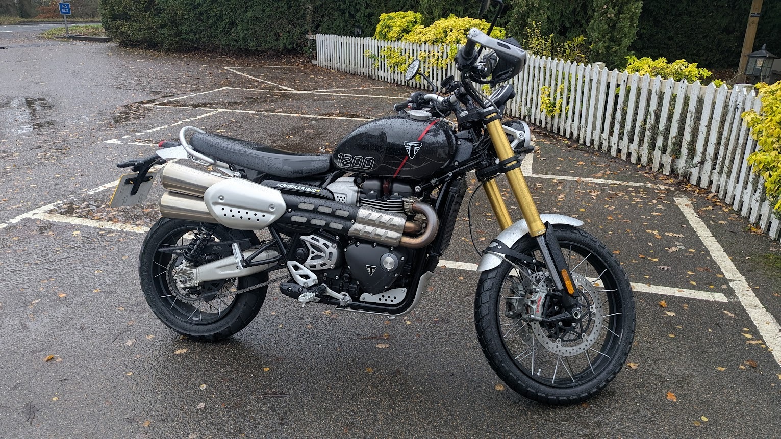

    Hi there,
    UK-based newbie in all respects - only had license a couple of months - went straight out and bought a 73-plate Scrambler 1200XE (fully aware this is a mid-life crisis, a mate has convinced me it's better called a mid-life BONUS though...) I fricking love this bike and want to do some serious distance on it in the summer (into Europe I reckon). Was hoping to get some advice on luggage and security...
    - Trackers. Worth it? Get the official Triumph one or an aftermarket one? Or am I just better off spending the money on locks and alarms? Better to stop the bike getting stolen in the first place than having to retrieve it no?
    - Luggage - rails and bags. Trying to find something with decent capacity but that I also like the look of. Think ideally I'd like three bits of soft luggage, so probably not the official Triumph stuff as they don't do an exhaust-side option that I can see. Going round in circles to be honest looking at options and it's not cheap! Would like to keep the pillion available ideally. Confused that Triumph's own "grab rack" only has a 2 or 3kg (depending where you look) payload!??? Surely their own 35l tail bag - which according to the "configurator" on triumphmotorcycles.co.uk you can put on the grab rack - weighs more than that before you've put anything in it?
    Been looking at Renntec rails (and engine bars). Their website's not clear if they'll fit this bike though (have messaged them - awaiting reply). Anyone on here got them on a 73 plate 1200XE?
    And then there's rackless systems - the Mosco Reckless 80L looks pretty cool. I dunno, as I say I'm going round in circles. Any advice greatly appreciated! Thanks for reading.

    @Rupert de Renzy-Martin Welcome to the family. Nice bike. Thanks for the great picture's There is so much out there that you can pick up. As for locks i use the oxford screamer disc alarm locks.
