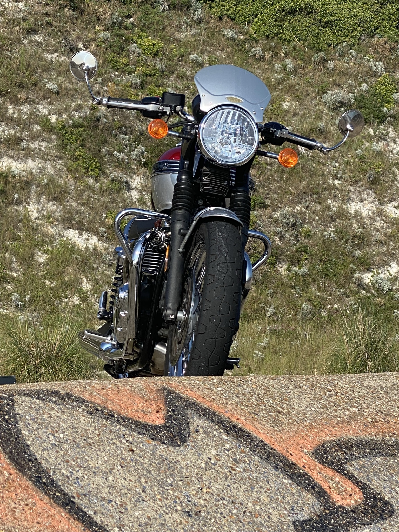

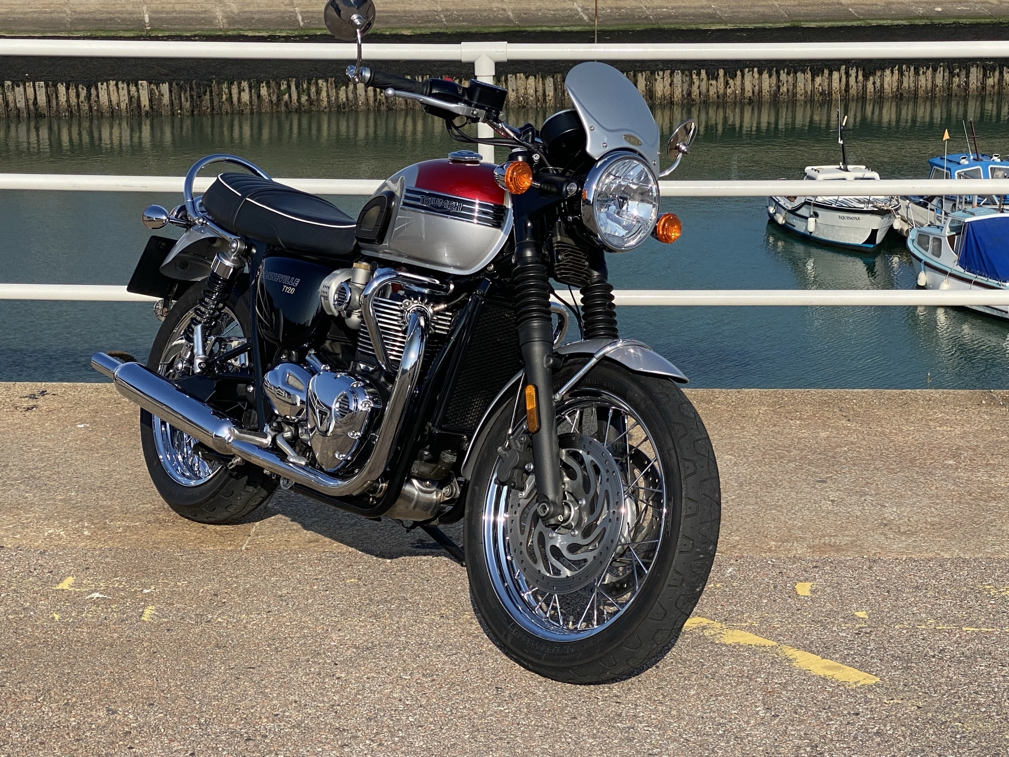

  5. tim scott
    tim scott Well-Known Member
    Aug 30, 2021
    72
    As promised
