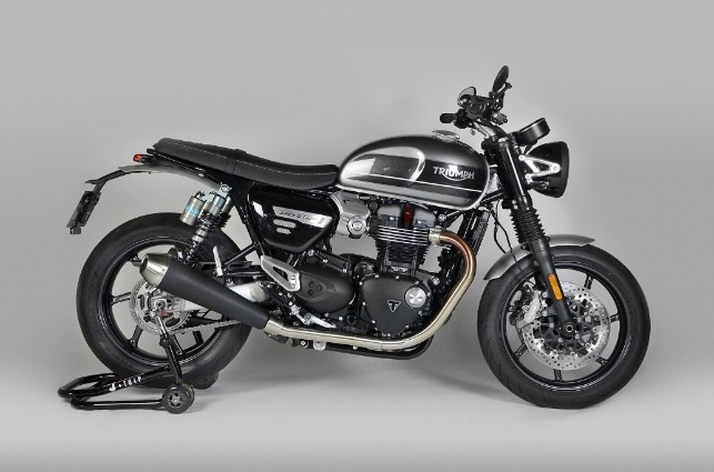

    Good news for those that find the stock suspension not to their liking. What we need next is somebody to sort out something for the front end.
  3. SpeedTwin1200
    SpeedTwin1200 Senior Member
    Jul 21, 2019
    261
    Hampshire
    I emailed Nitron and asked the question but they said, at the moment, they haven't got a cartridge kit to match the shocks. They might be hinting that something's in development?

    I know, but I prefer the look, quality and price of the Nitron NTR R3 dampers to the Swedish Öhlins, plus Nitron are in Oxfordshire. It would be nice not to mix'n match that's all.
    Because I'm at the lower end of the average rider weight (75kg/11.5 stone), I'm finding the springs are too firm and my rear shocks are on the softest setting. I know from the comments of heavier riders that there is nothing wrong with the stock suspension but I'm not getting the same connection with the road. I guess Triumph set them up for an average 200lbs/90kg rider.
    I had 80kg of son riding pillion the other day and didn't bother to change the rear preload to see the difference which was obviously too soft and wallowy and used most of the available travel.
    The cheapest route would be just to change the springs front and rear as the damping is okay but ideally the valving needs matching to the springs so I'm calling Steve Jordan near Leatherhead to sort something out.
    I love the simplicity of the Triumph but perhaps I'm somewhat spoilt by the electronically adjustable Ohlins that were on the Multistrada I had last. I would like to have the confidence in the handling and grip that others find, so refining the suspension to match the performance of the brakes, tyres and engine is my aim.
    It might not be that long before Triumph release the Speed Twin R as has been suggested in the press as the current model leaves room for an Ohlins specced bike and price.

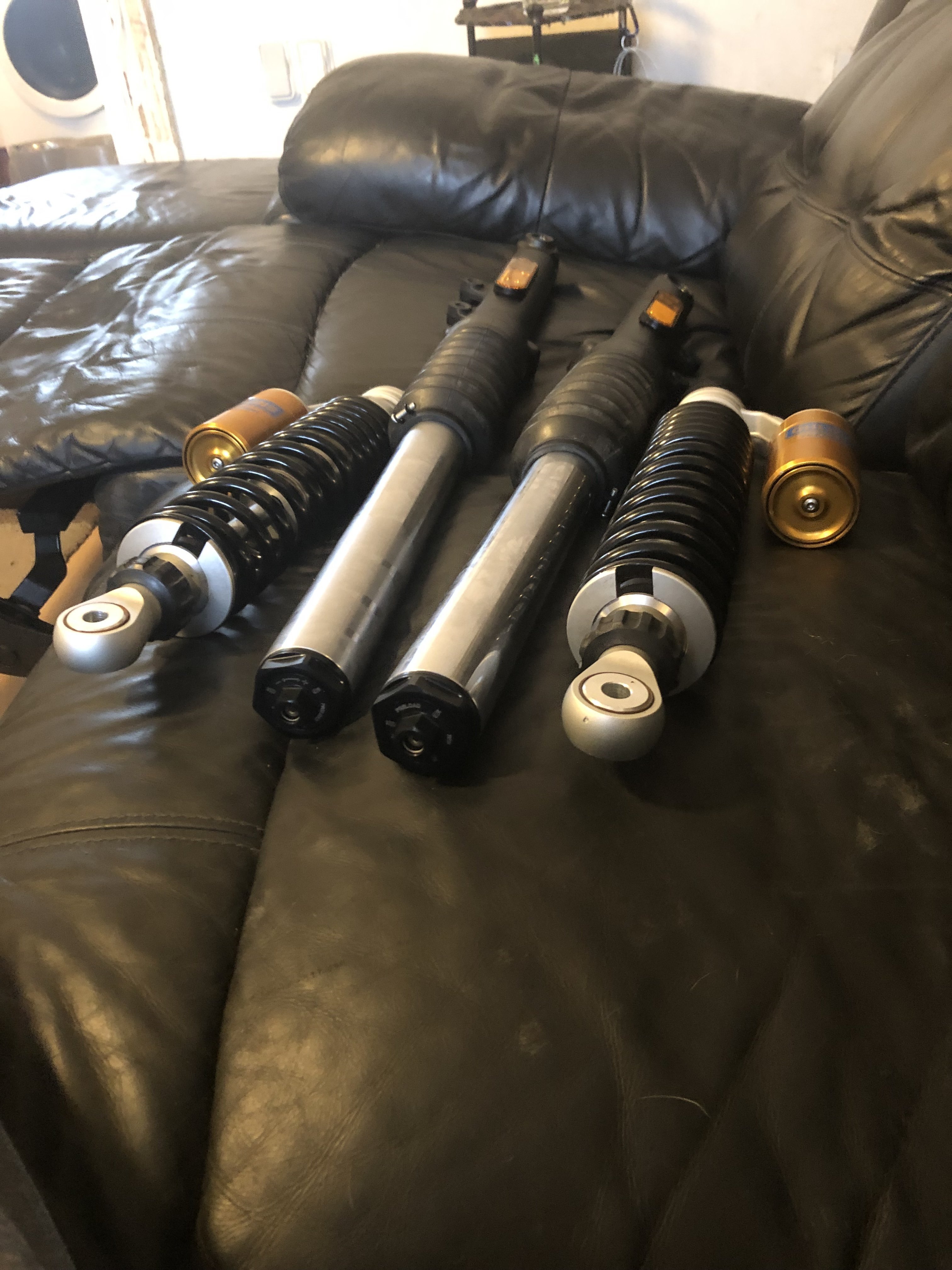

    52DD22AF-F8F3-4794-9FC9-F38BE0B308D7.jpeg I don’t know if this is helpful for this bike, but i purchased a second hand set of Thruxton R rear shocks and had them revalved and sprung for my weight and Ohlins internals into the forks on a Thruxton S this in total was just under £1200.00 but transformed the bike
