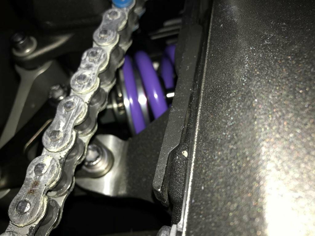

  8. m4ppy
    m4ppy Well-Known Member
    Aug 7, 2013
    52
    hopefully you can see a Maxton shock fitted. Cant really see the purple

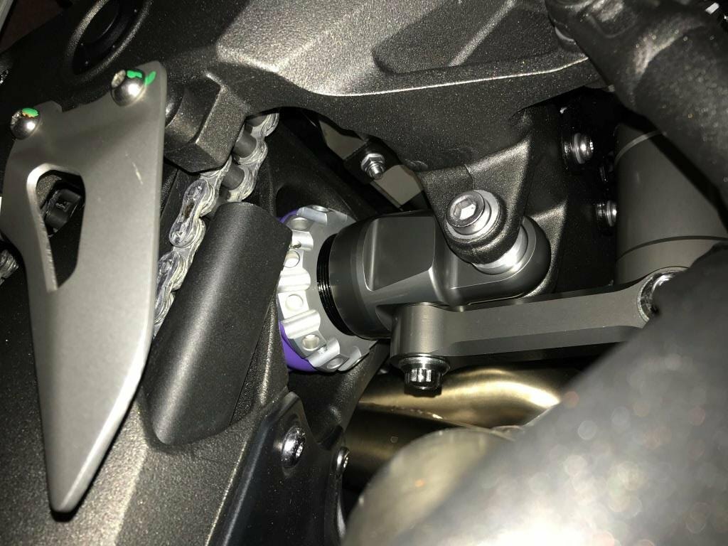

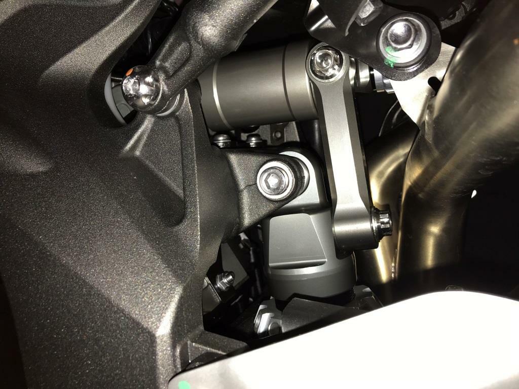

  9. Speed Fr3ak
    Speed Fr3ak Member
    Jul 12, 2018
    36
    Wiltshire, UK
  10. m4ppy
    Aug 7, 2013
    52
    Yes I fitted myself and had my forks revalved at the same time, the shock was £630 plus vat, they also do one with out the remote resiviour for £460 plus vat. These are built for your weight and riding style. They are top quality and Maxton are very helpful and knowledgeable.
    The fitting is very easy especially with front and rear stands, when changing the rear, I used for tie downs on the front stand and an axel stand under the frame behind the engine, with the exhaust off and a helper it's easy.to raise the rear wheel and have some one pop the bolts out.
