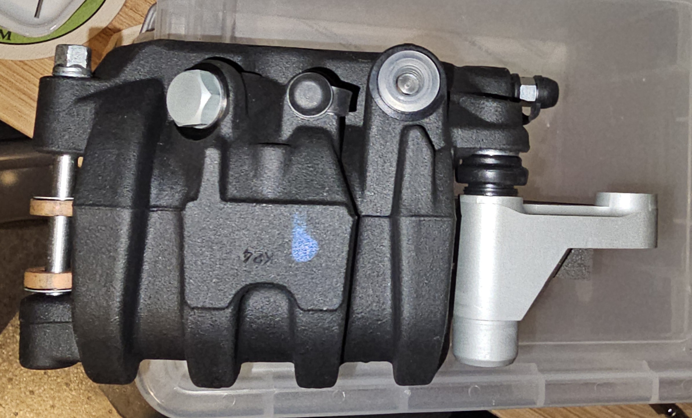

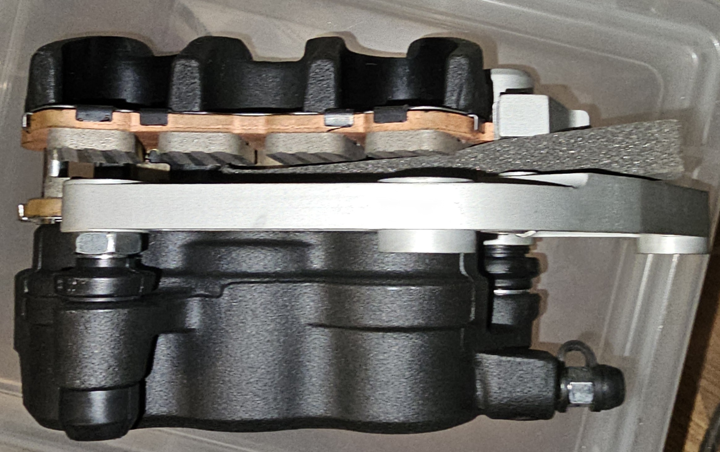

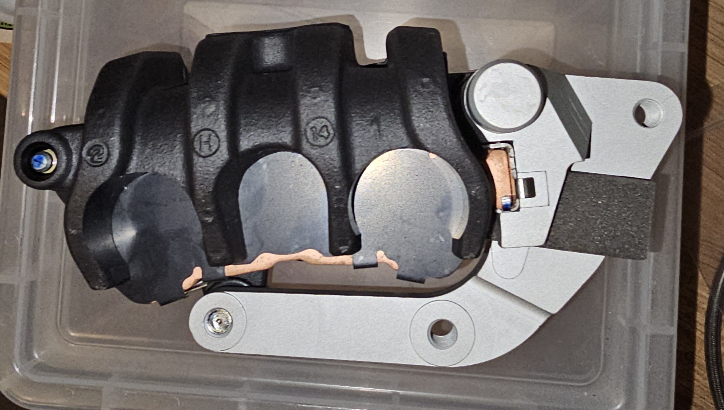

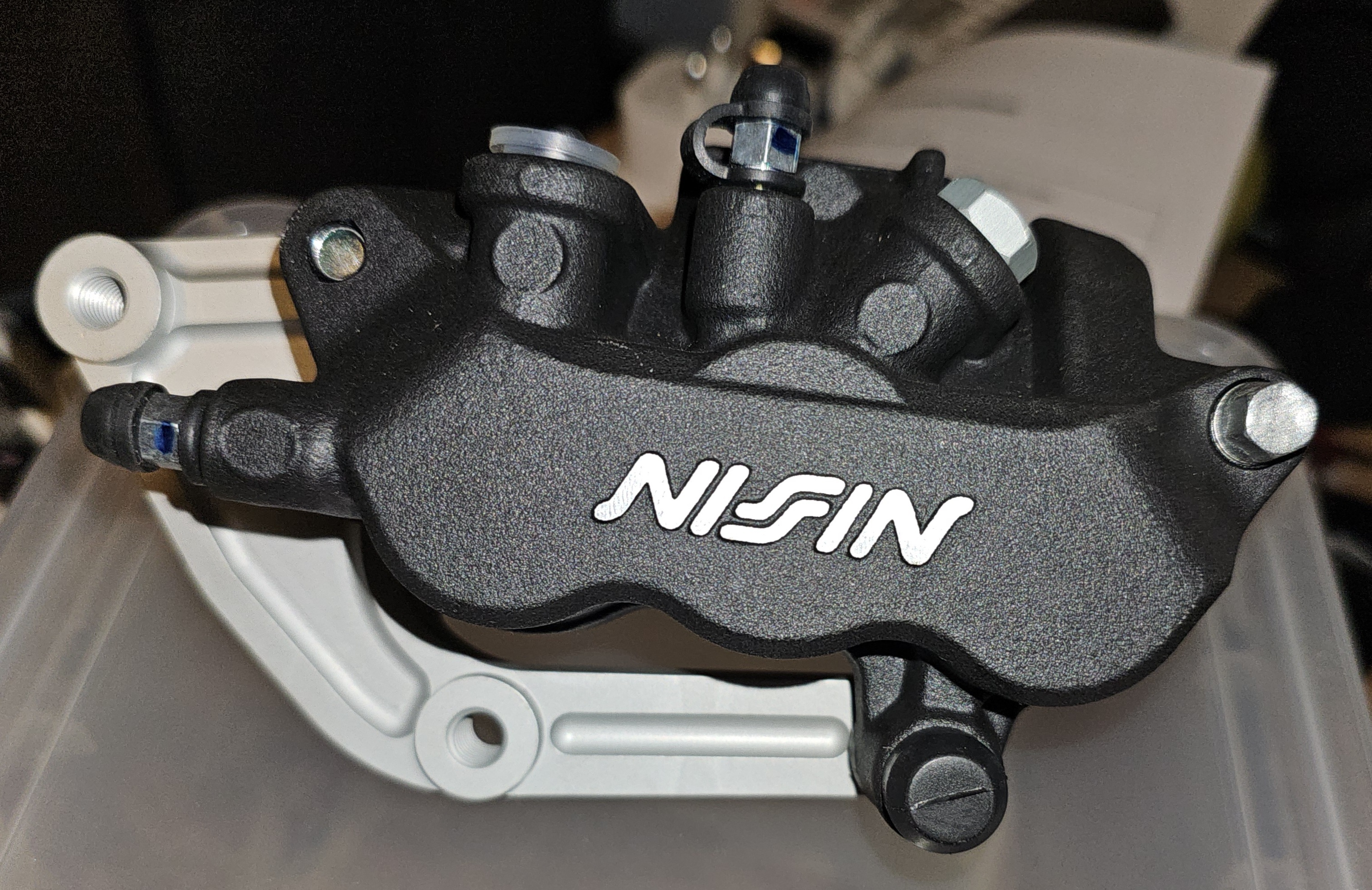

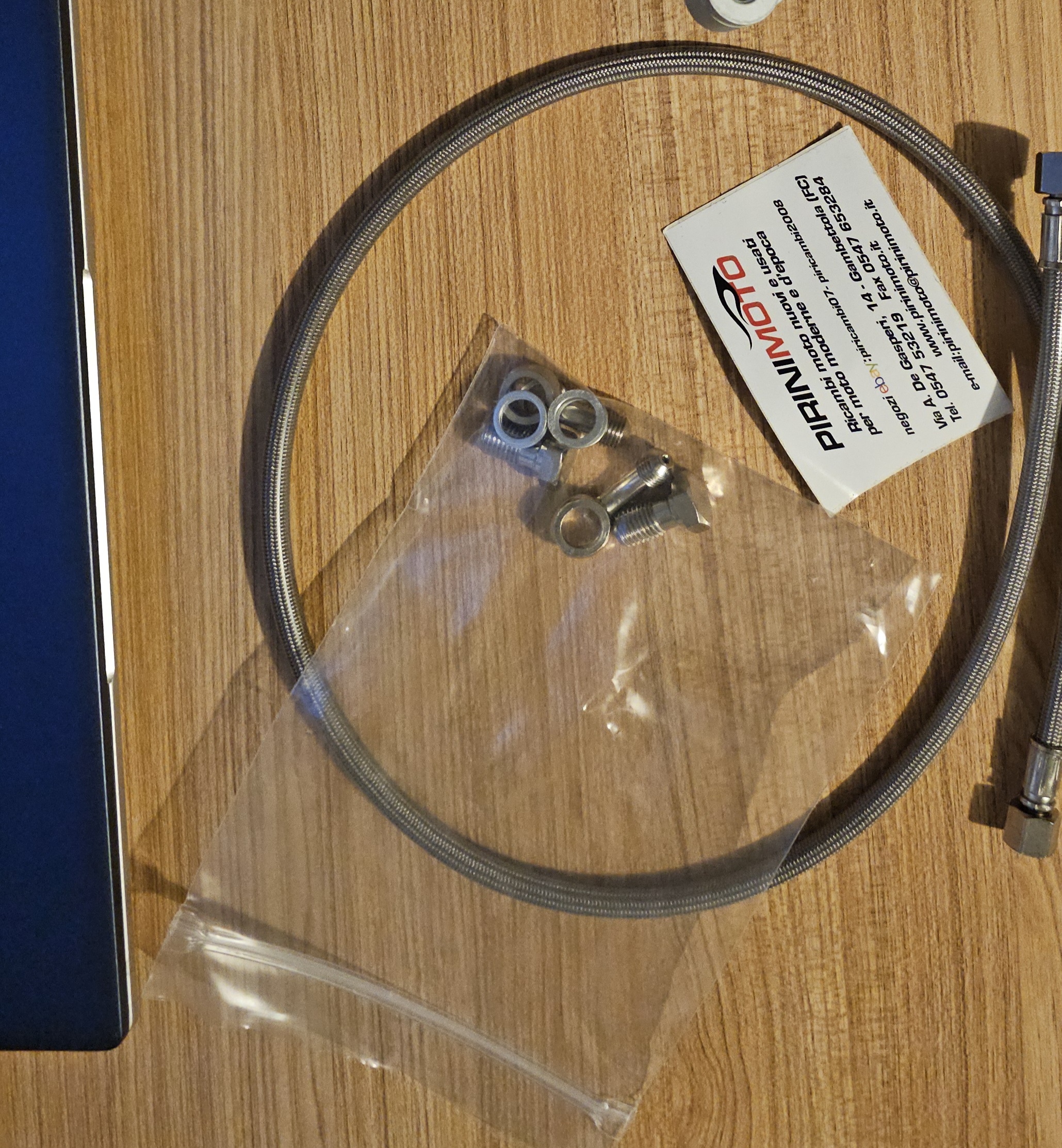

    I've got a new complete kit including caliper, I never got around to fitting to my Bonnie, it might not be what you want as I'm guessing you're just after the mounting bracket?

    Here's some pics of the one I have.
