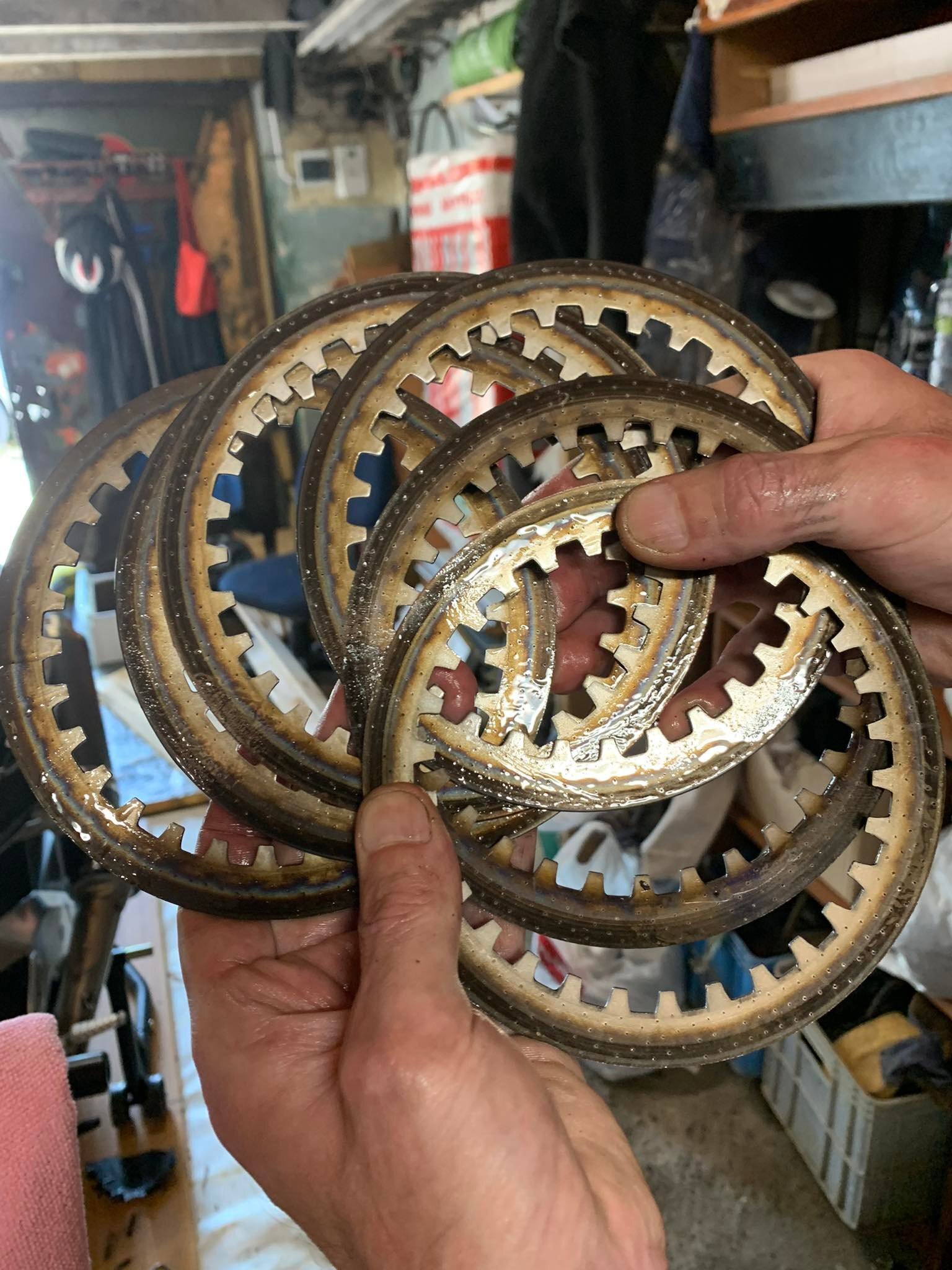

  12. Hi All, changed the clutch plates after soaking for over 12 hours...New clutch plate springs ...rubbed cage edges down as edges a bit sharp to aid movement...back together ran fine briefly.. Still getting clutch drag difficult to get in neutral..adjusted cable..no difference....now lost as to what could be ..anyone else had this experience?

    Hey @Andrew Boulstridge , I feel you are more mechanically adept than I am, but just in case useful; after my clutch replacement as mentioned above I also had a fair amount of drag to adjust out...
    Make sure you have a couple mm of free play at the lever, you need the system to be able to fully "unload".
    I played around for a good while to get a balance between little/no drag, and enough throw of the lever to fully disengage the clutch for a smooth gear change...
    I put the bike up in centre stand, and tried, in neutral, to have the rear wheel still - ie zero drag. However then I didn't seem to have enough lever pull to fully separate the plates to give a smooth gear shift.
    I found that the real wheel moving a little was fine, when on the stand in neutral. Although the wheel was being driven round, it looked more driven that it actuay was. I could hold it with my hand/foot. And it certainly wouldn't move the bike if wheel on the ground... So that "drag" was fine, and gave enough lever throw to fully use the clutch and give the smooth gear changes I was after...
    I won't lie, this took a fair while (an hour) adjusting both the engine end and the lever end to get a decent balance between perceived drag and clutch disengagement... I even went out with a spanner...and played around as I rode ..adjusting here....adjusting there...
    To add a further layer if confusion I had adjustable levers ...and, although I wanted the lever close to the bar,.I simply couldn't as it didn't give enough pull for the clutch ...
    Trial, error and patience is your friend. Good luck, keep us posted!
