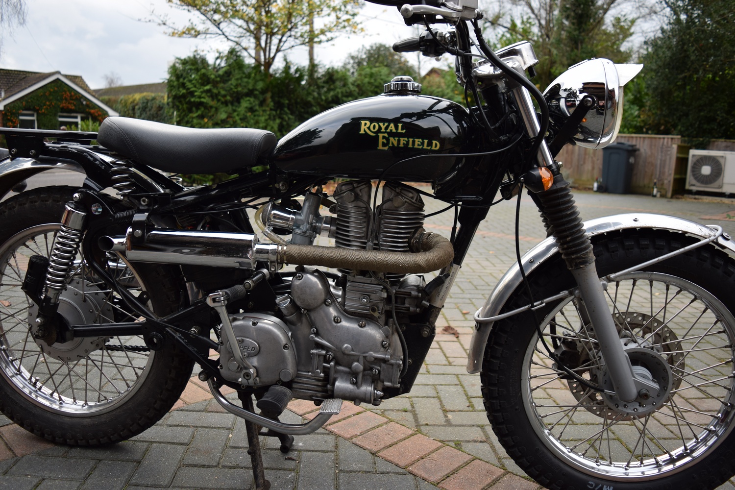

    Agree with Mischa, soak the wrap first and start at the silencer end so that the overlap is the correct way.
    Depending on what wrap you buy, you should bet some form of fastening with the kit. Mine came with steel cable ties that were very easy to use and neater than wire. Some people use Jubilee clips at each end for extra security.

    It has a separate heat shield which I left off when I wrapped it - but I wouldn't want to wear biglads shorts!

    Looks a good job you have done on that enfield Steve

    That Enfield is bloody beautiful !!! I'm very envious Steve

    Thanks mate. Started life as a blue 05 plate Electra X, but previous owner had the full Hitchcocks Trials conversion done and removed the electric start. All I've really done is replace the CV carb with an Amal Mk I concentric one. The bike runs much better with it.
