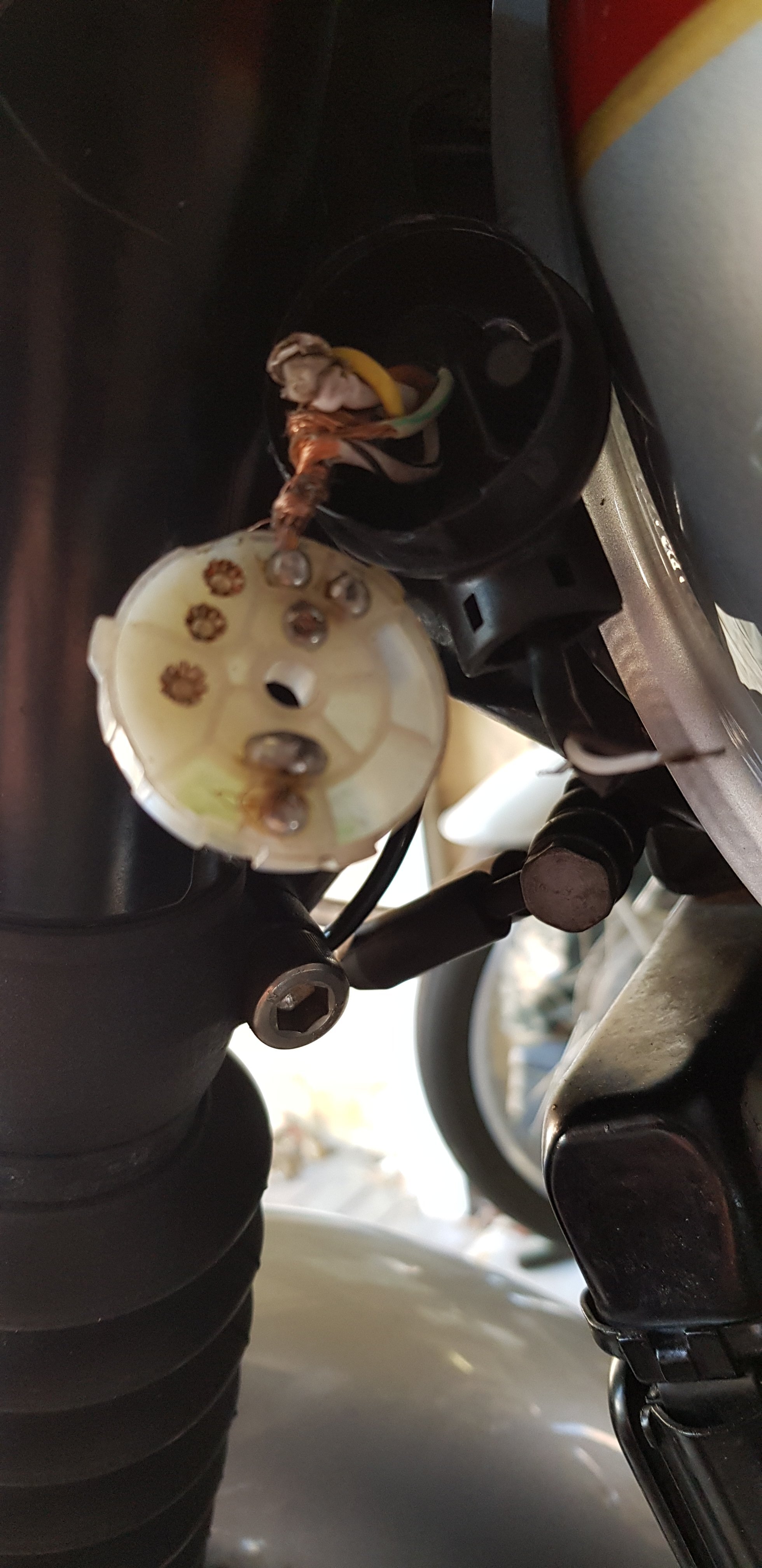

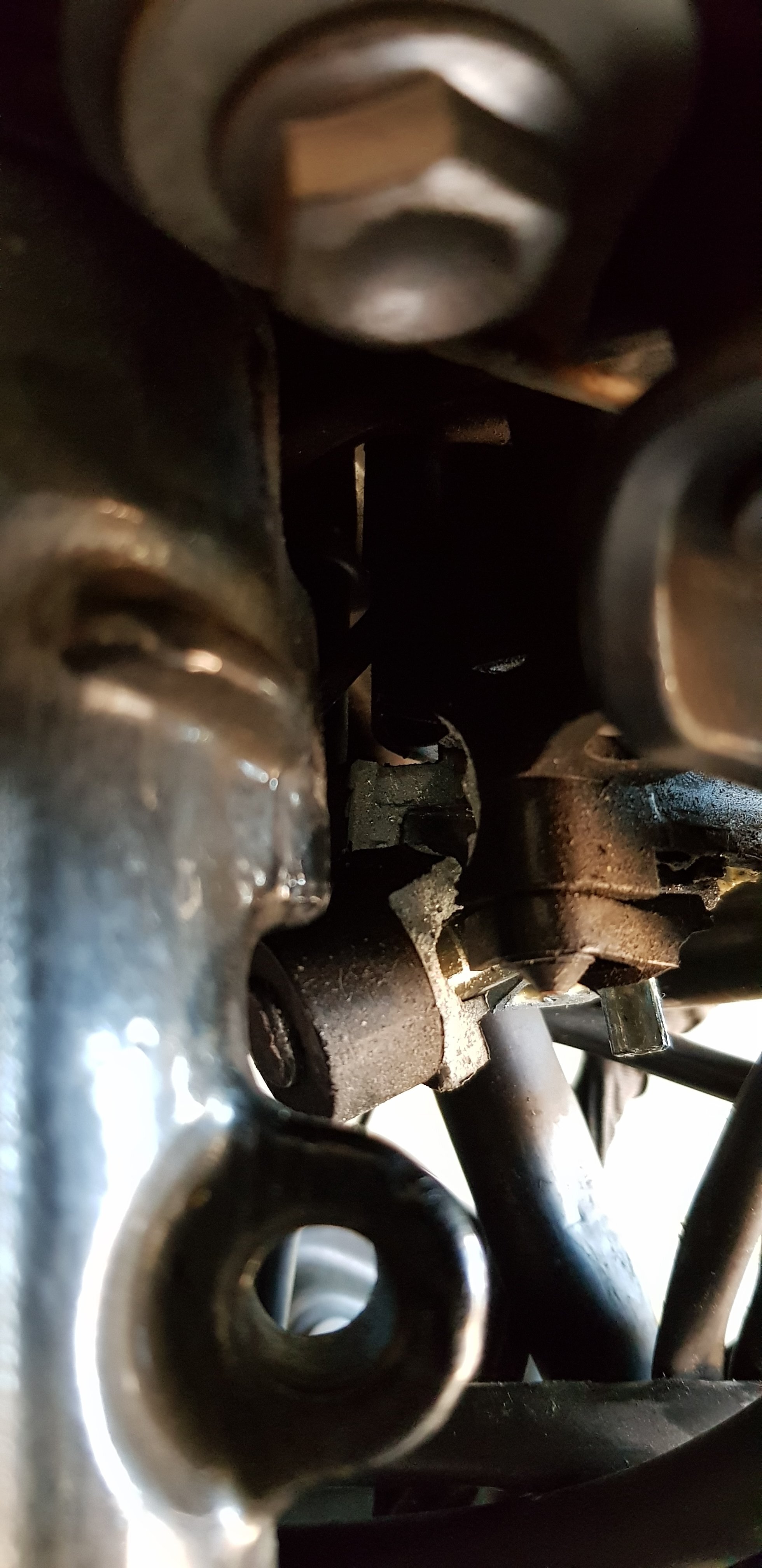

    The cast steering lock was just smashed to bits, switch cables pulled down and twisted together. The seat was removed by simply pulling the lock cable to get access to the ECU.
    Luckily my bike was later recovered with little obvious damage except some cut wires etc but couldn't be ridden.

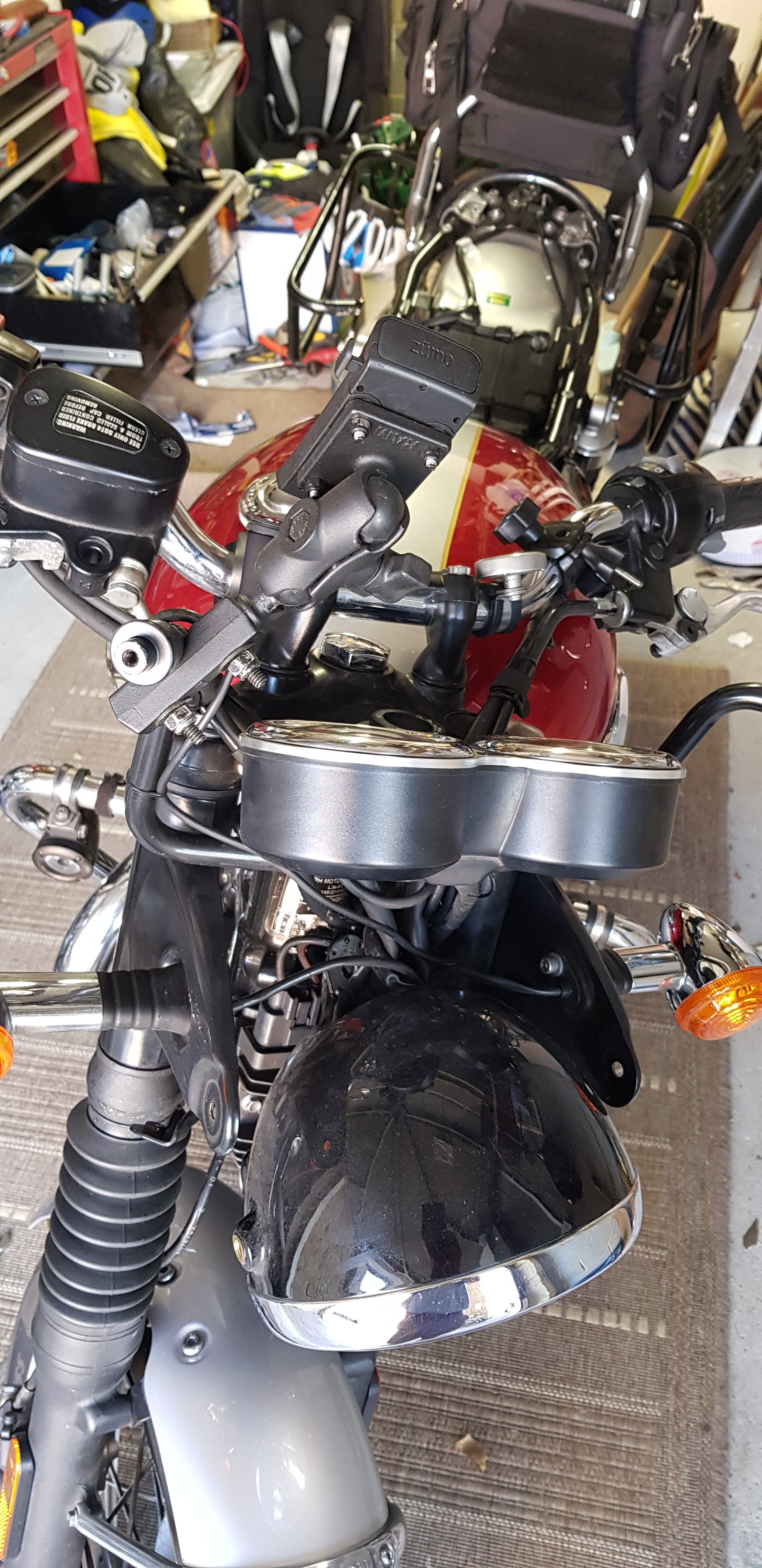

    However, when finally taken to a triumph garage to be fixed, a bill for over £4.500 was received due to both clocks having their cables being pulled so hard the damage is unrepairable and damage to the ECU.

    Speaking to local mechanical engineers, their view is that the shattered steering lock mechanism is made from cheap cast metal which breaks so easily "it's almost like it's meant to break". Which isn't what I'd hoped for. The subsequent damage caused is unbelievable!!

    I am a mechanical engineer and the steering locks on most bikes are easily broken, they are a only useful for the stoopid local teens.
    Any more serious criminals will overcome them easily and either drive a bike off or throw it in a van.
