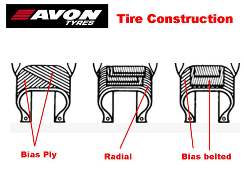

    Hmmmm all to do with the weft and weave! Time was when all bike tyres were crossply (AM26s) because a bike rolls round its carcase and you want the tyre to maintain its shape. The internal structure is like a normal weave at 45 degress to direction of travel. Radials started in cars with radial strands at right angles to the tread and 90 degress to the contact patch. On cars this meant the contact patch stays flat on the road and the distortion is in the tyre wall enhancing grip.
    Superbike tyres now distort too but the Bonnie does not generate enough power/heat/load to really benefit. The Avon is perfectly well up to the job.

    Piccy worth a thousand words....

    That's good to hear, I like to have a good if not basic understanding before making a decision.
    Thanks for the help !

    I'm keeping that, it's a subject for the pub I feel !

    Brilliant description Callum!
    The tyre manufacturers should come knocking on your door.
