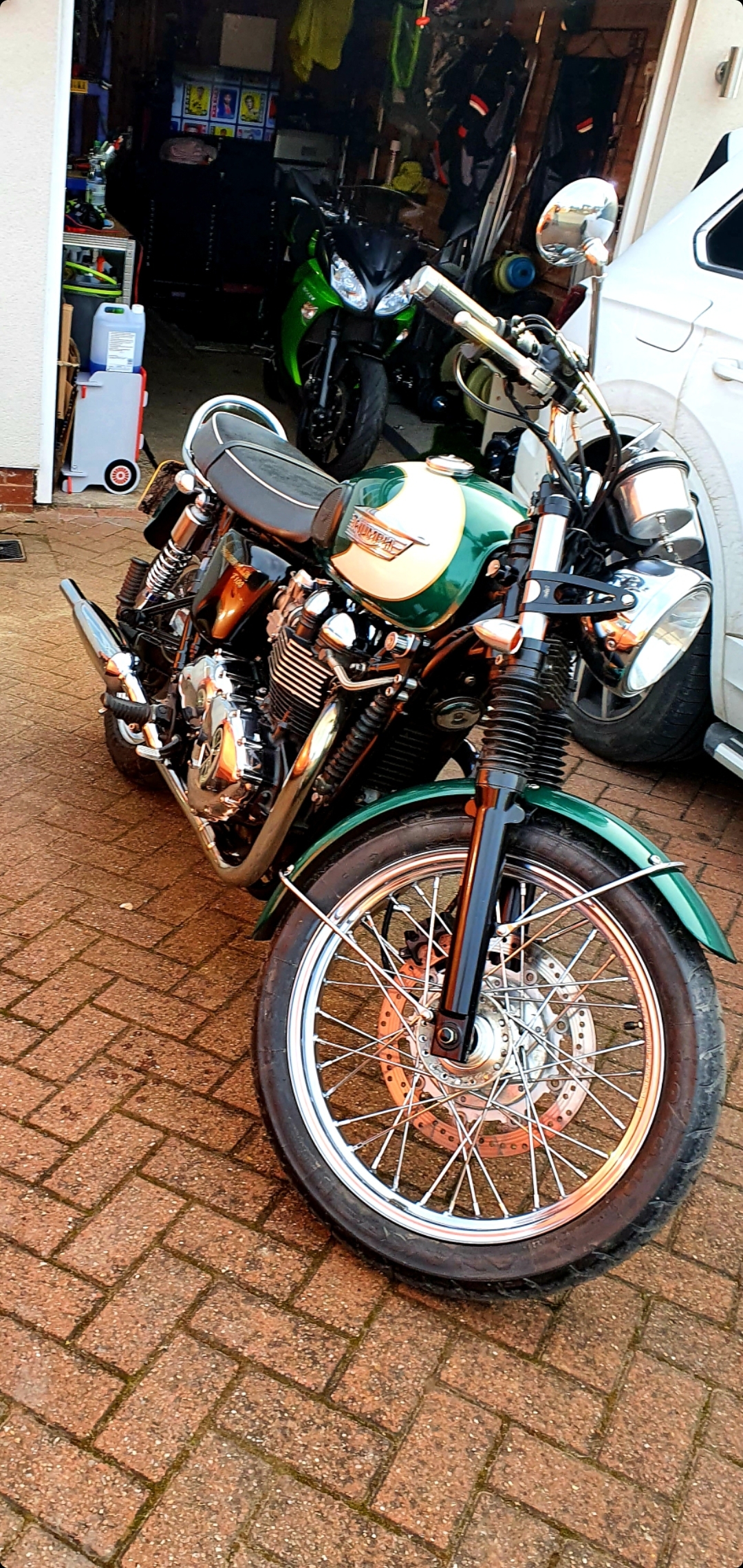

Hi - just purchased my 1st Bonnie from a dealer. Its a 2008 T100 with 23k on the clock. I took the bike for a 20min ride today, initially started ok despite being very cold but then stuttered/backfired for 5-10mins before settling down. I had the choke half way out for approx 2 mins. After the ride, the bike turned over fine but failed to start until the 5th or 6th attempt. I I'm not sure if it's related, however despite perusing the manual and forums, I've noticed a filter of some description (not sure what it is) under the tank is dripping a pale/cream oil. (Pic below). I'll obviously ring the dealer on Monday but in the meantime and clues as to what wither of these issues might be would be welcome. Many thanks.

The crankcase breather pipe would originally have been connected to the air box, any water or oil vapour would have then passed through the air box and then through the carbs before being burnt off in the combustion chambers, the water vapour comes mainly from atmospheric moisture and condensation that forms inside the engine cases whenever the engine cools, someone has removed the breather pipe to the air box and fitted a filter to the end of the pipe, so now the water and oil vapour collects on the filter and forms an emulsion, that is what you can see dripping out of the filter, it’s not a problem other than it causes a mess, people do this mod thinking that it will give the engine more performance, technically it does but it’s so little as to be virtually undetectable, so it’s a waste of time, if I were you I’d restore the original system and therefore not have messy emulsified oil dripping onto the engine. Regarding the poor running it’s possible that your carbs iced up, the ambient temperature is very low at the moment and there’s a lot of moisture in the air, perfect conditions for carb icing, my Ducati M900 is prone to this, sudden throttle openings cause a pressure drop in the carbs, this leads to ice forming instantly, dropping back to tick over and allowing the bike to idle for a minute allows the ice to clear, after which slower and gentle opening of the throttle goes a long way to avoiding carb icing. Some set ups are prone to carb icing some aren’t, my M900 does it easily, my 900ss doesn’t, same engines, same carbs, go figure!.
Regarding the oily discharge... What Mark9 said. As for the poor running, it's unlikely the carbs would ice up on a fuel injected bike. There is a guy who advertises on here with a company called TTP, triumph twin power, he can do remapping of the ECU so it runs better with open pipes, thoug it wont do any harm to not have a re-tune. Nice looking bike, it looks like the previous owner has done some other tasty mods, like neat headlamp brackets and indicators, also ignition relocation. You're going to enjoy it I'm sure. Could you post some more pics on the "Post your Bonneville pics here" thread?
Nice colours - like my old 2004 T100. Looks like it has after market indicators, headlamp bracket, and instrument binnacles fitted. The ignition switch has also been relocated from its original position on the left side of the old headlamp bracket.
Tons of upgrades on that Bonnie: led indicators front and back, headlight brackets, chromed engine cover, Hagon rear shocks, aftermarket pipes, locking fuel cap, heated grips, instrument cases... She looks gorgeous, previous owner obviously loved her. The breather upgrade is mostly for looks. You should be able to just reconnect the tubing to the original hole in the air box, if you want to undo it. However, it could very well be that the filter is just soggy and needs a good cleaning, before being refitted. As for the starting issues, maybe the aftermarket pipes are the culprit (and I can't tell exactly from your photos on the other thread, but looks like the secondary air injection has been removed as well). You may need a different fuel map, although I also removed the SAI and have aftermarket exhausts (TEC), and yet use the "standard" map (although I did remap to the latest slightly improved version). It can also just be that the bike hasn't run for a long time, and may need a bit of an overall (oil, spark plugs, throttle body sync, etc).
