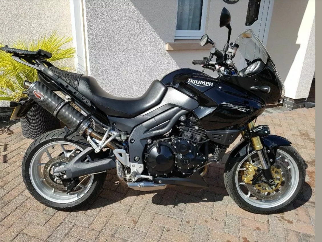

Hi all, new to the forum, just bought (a month ago) a 07 tiger 1050. Loving the pokey plant, but have been struggling with bottoming the front end. Found this place really helpful and thought I'd join in as I do a lot of my own maintenance Cheers Dave Bell

David Bell. Welcome to the family. Nice beastie you have acquired. Its now time to hit the add a link at the bottom right hand corner and let us all see it. We the inmates here in the asylum like piccies. Ride Safe & Enjoy Joe.
