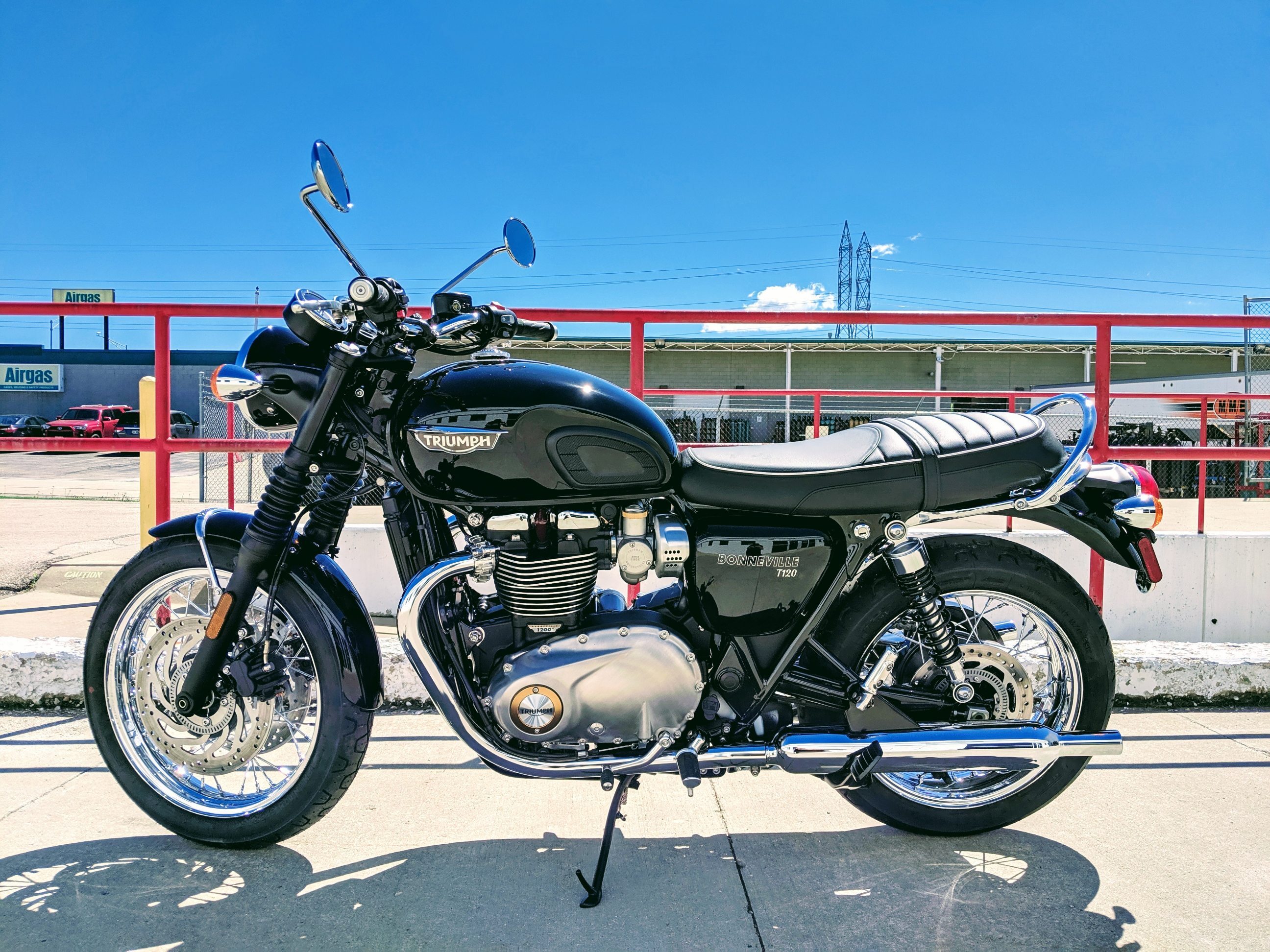

    A picture. Well, it's just a bone stock T120 like you've seen so many times before, but here goes...
