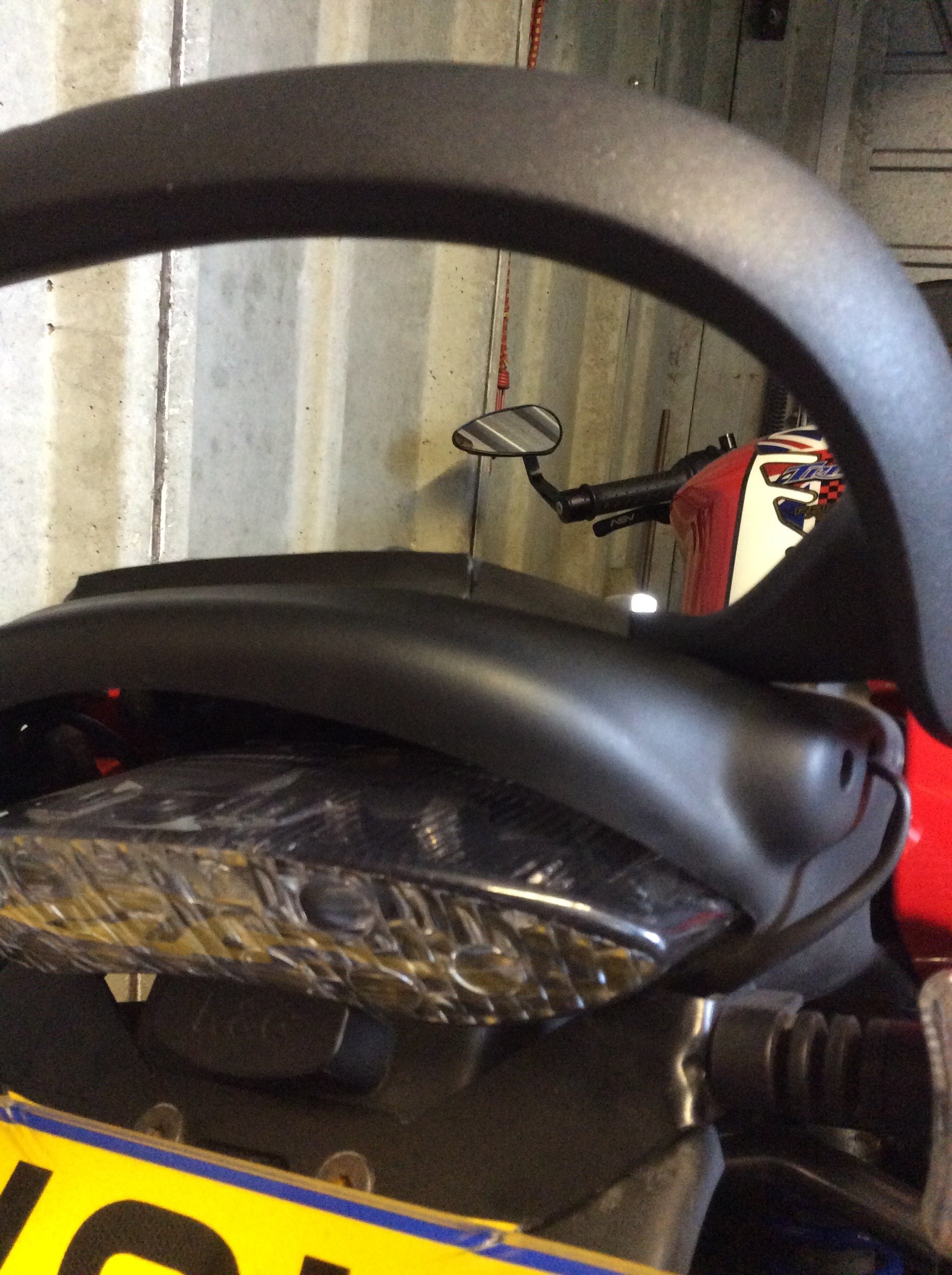

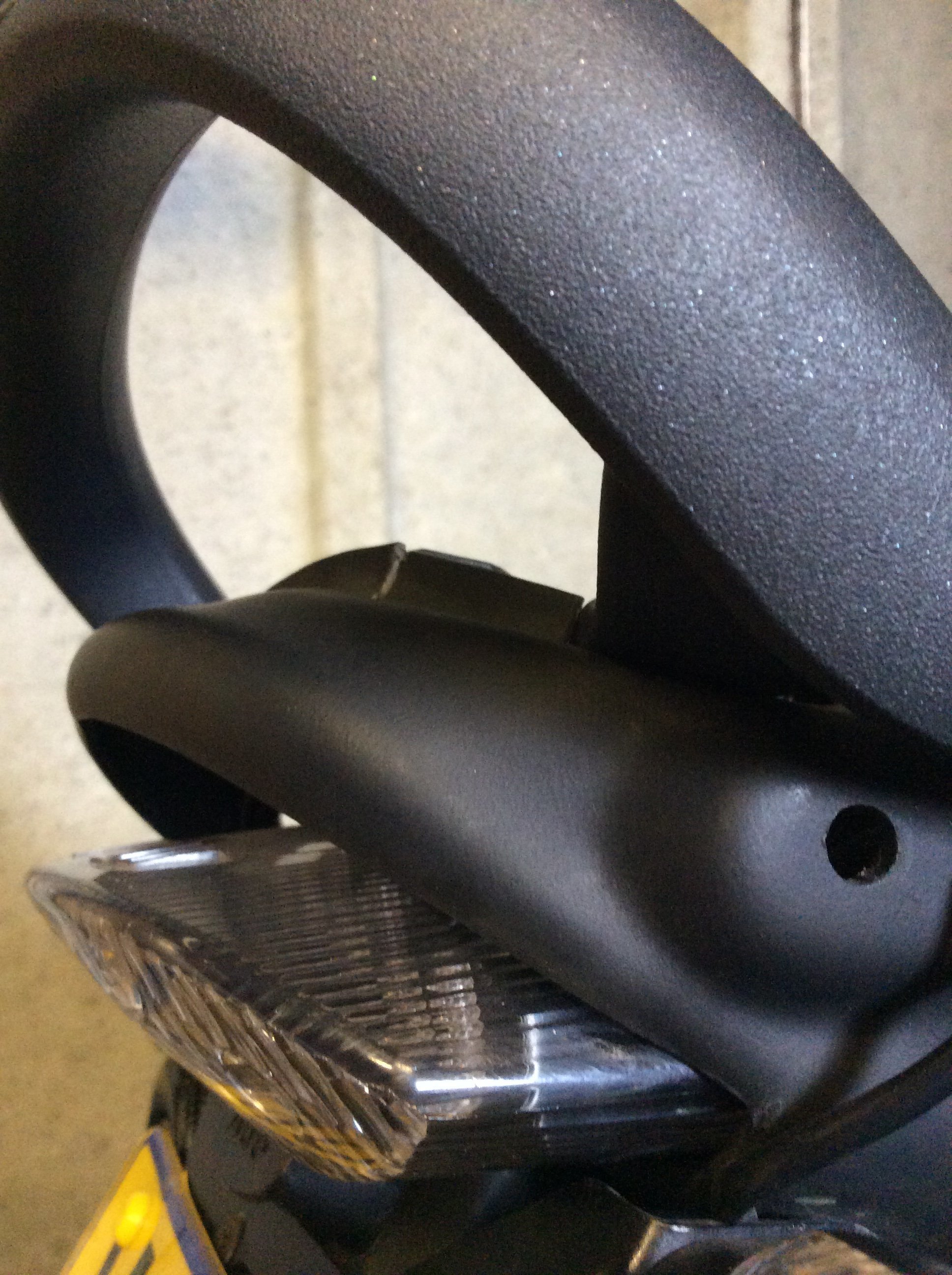

    Loving the SP so far but I have one issue. I notice the back light seemed alittle loose so attempted to tight it up. I took the grab rail off (Triumph part) to get at the bolts for the rear light and nipped them up, all good. But when I refitted the grab rail, tighting the 4 bolts for it seemed to force the grab rail down onto the rear light surround which pressed onto the light causing it to appear loose again. After a bit of head scratching I “packed” the grabrail up using a couple of washers. Bingo! Problem solved. That was until I tried to refit the seat and it wouldn’t click into place The washers raised the grabrail just enough (2mm approx) to stop the seat attaching. So off they came and I’m left with a wobbly rear light.
    It isn’t bad but just annoying. Has anyone else experienced the problem?

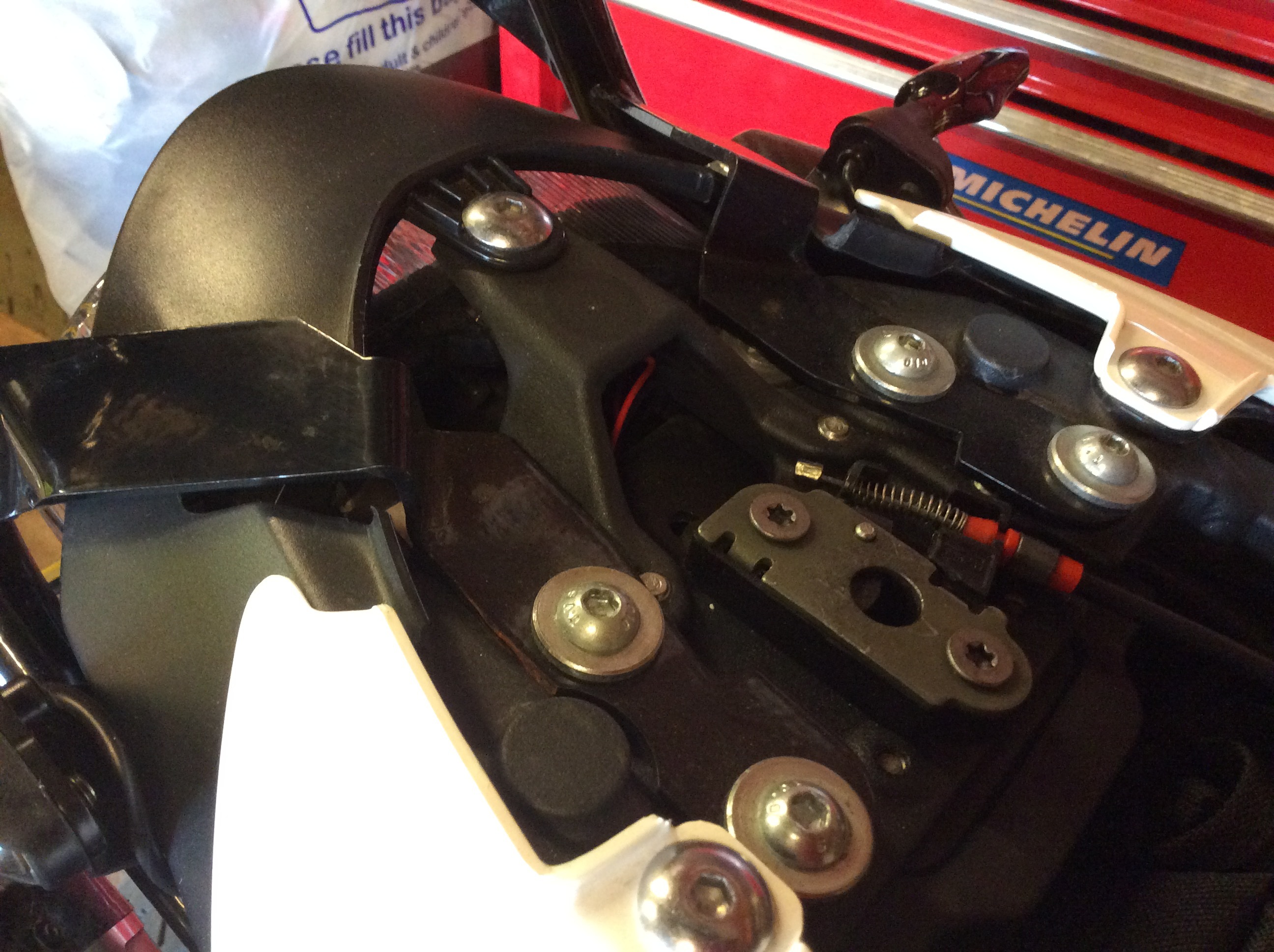

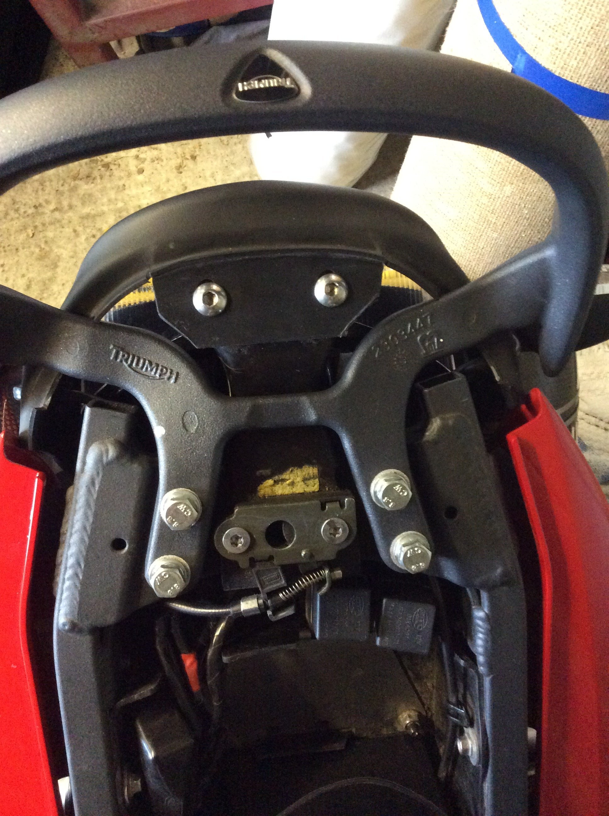

    Hi Sam and welcome to the forum! Could you not space the seat bracket slightly to compensate for the spacing of the grab rail ? Otherwise check to see if anything is bent causing this frustration. Hope you come right

    BEDF2ECE-30D7-43C1-8075-D4EFDA371C5E.jpeg Hi and welcome, I’ve just re-read your post and the issue you are having with the grab rail and rear light and I got thinking. Does the rear plastic section have any cut outs where the grab rail fits. I fitted a Rentec rack last year and it uses the same four bolts under the seat where I believe your grab rail bolts to and the seller also sold me the black plastic light surround which he had modified to clear the rack by cutting where the rack goes under the seat. Neat job, and I have the original light surround to put back when the bike goes if I sell the rack separately.

    Sorry the pics don’t show the issue very clearly. The plastic has been cut to accommodate the grab rail but surely Triumph didn’t design them expecting customers to to have to do this?
    Although it has a tail tidy fitted, I don’t think this is causing the problem in anyway.
    Once tightened down the grab rail is putting the plastic under pressure and has caused it to crack very slightly even though it has been cut. This then pushes on the rear light which then becomes loose and wobbles.
    Not a big problem, just annoying, especially if it is a design fault,
