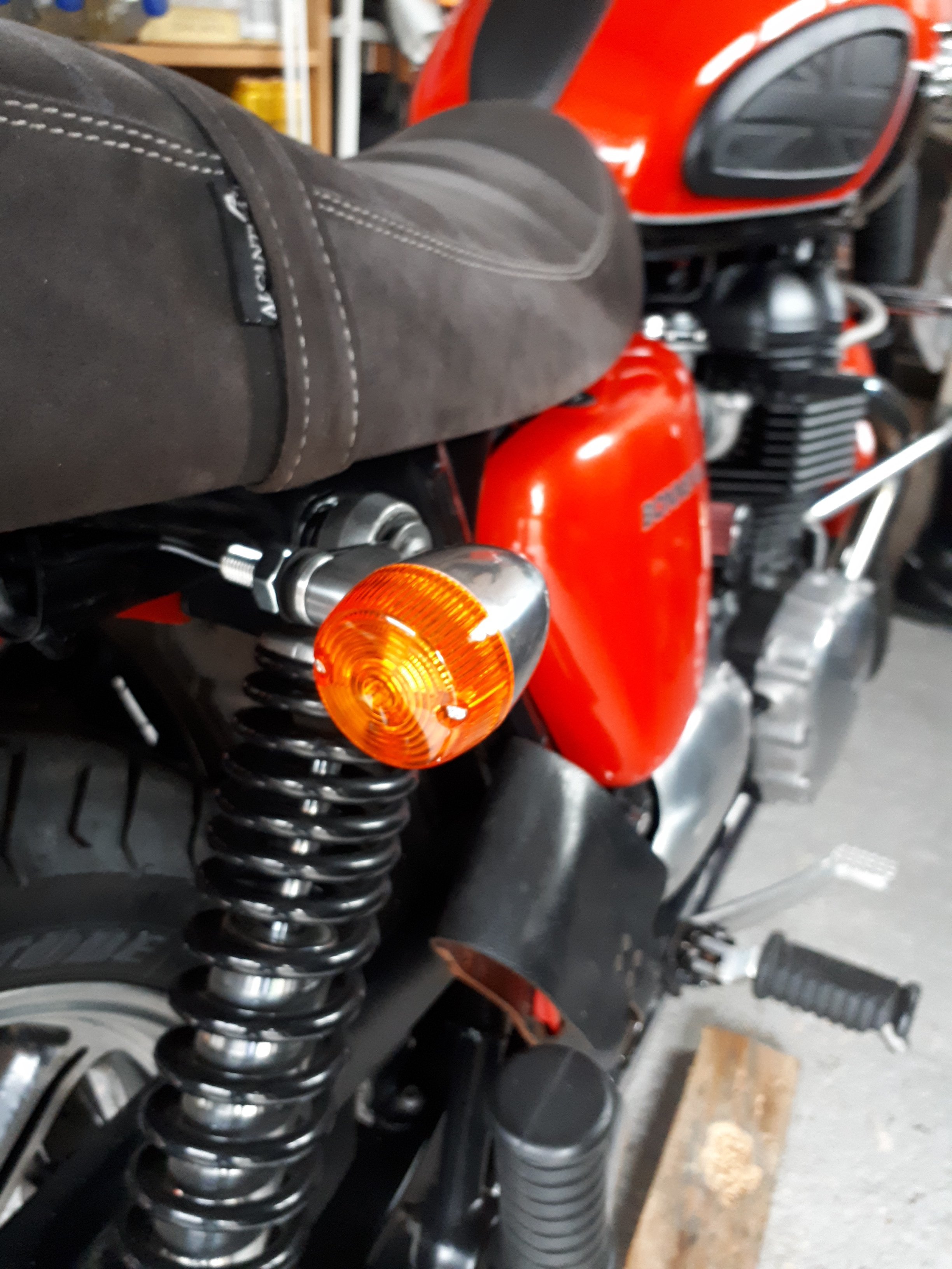

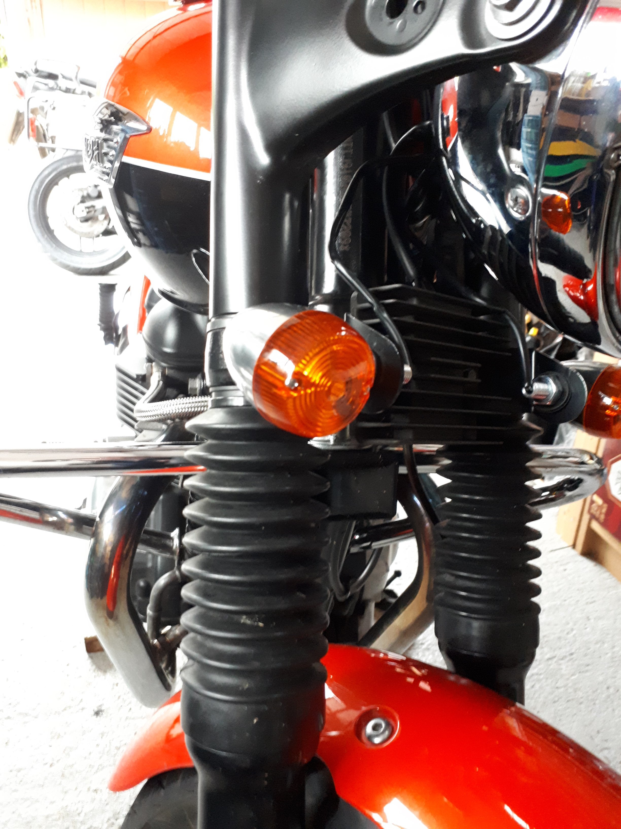

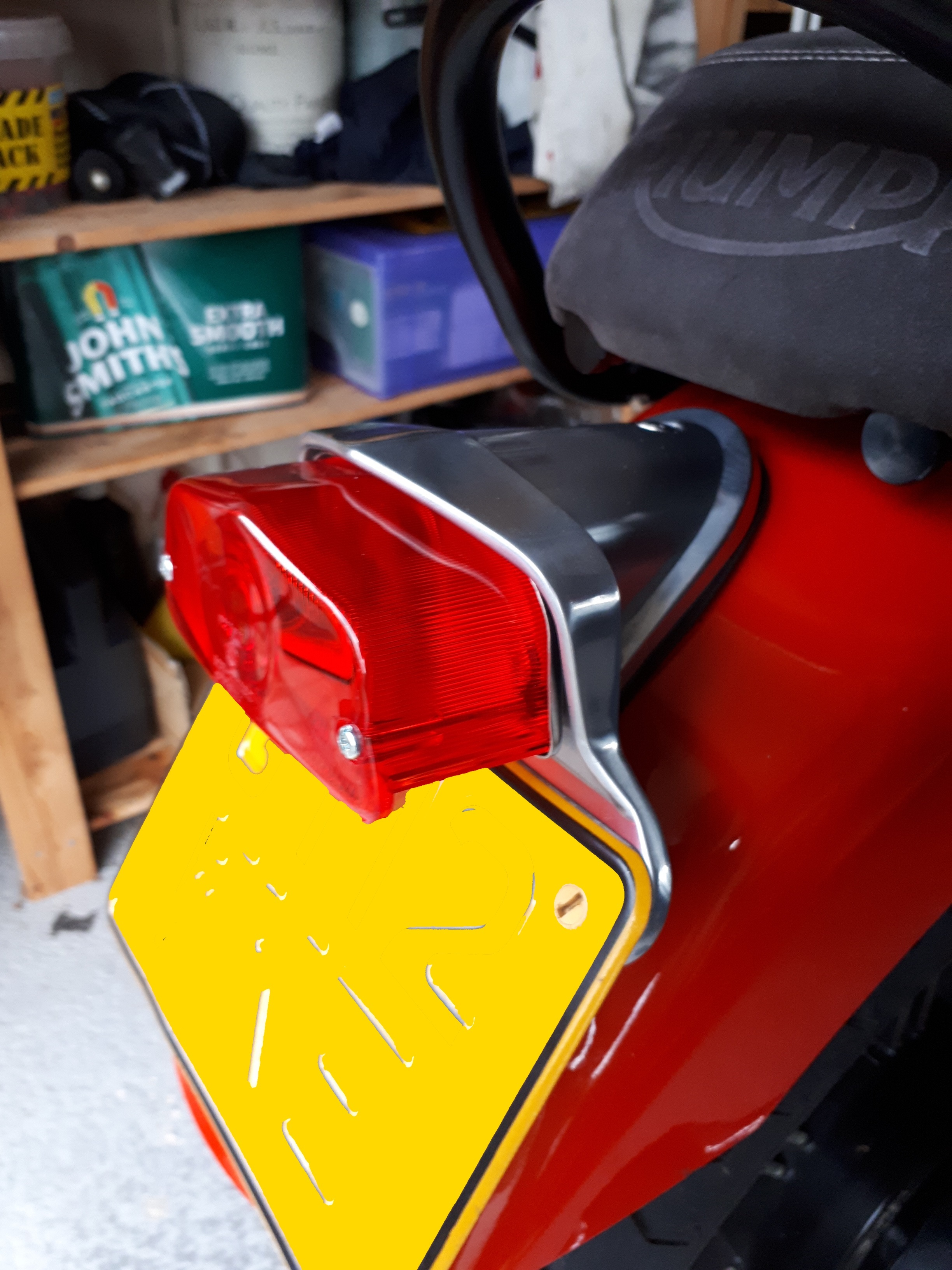

    Finally fitted my new Lucas style rear light from Square Deals (along with their "plug and play harness". Much better looking than the original as are the brushed chrome indicators.
    The relocation brackets were bought from the cheap Chinese site Wish (thanks to Wayne for the heads up on this one). I think the rear brackets were only £3.00 with free postage and nothing I've ordered from there has taken longer than 14 days to arrive.

    much better!! did the indicators come with therearlight or did you buy them seperate? i prefer them to mine as the light is visible from the side, which make are they?

  4. steve lovatt
    9,211
    Thanks! No, I bought them separately as I really liked the style. They are not LED but are brighter than the originals. The make is Lockhart Phillips Aluminium Series Turn Signals - they were came up on one of those random facebook adverts. I ordered them as they were £20.83 a pair, which I thought was a good price but fortunately they come from the States so the postage is about £28.00 plus taxes! :mad::mad: Very pleased all the same though.

    Nice job would look even better with the headlight ears swapped out or just blank off the old holes
  6. steve lovatt
    9,211
    That's the next job. I have the new brackets but just haven't had time to change them over yet.

    That looks pretty smart mate :) I've just fitted a similar tail light to mine but I was doing it on the cheap so raided the depths of my shed for left over parts from other projects, this did mean I had to spend ages on the wiring though and I also discovered that if you fit short stem indicators into the headlight brackets you can no longer get the ignition key in!
  14. steve lovatt
    9,211
    Cheers - Yes I had that problem on my first Bonneville so I had to get the relocation bracket for the indicators, although I don't mind the position off the headlamp bracket I've already moved the ignition to the centre of the instrument bracket on this bike so could have fitted them by the headlamp.

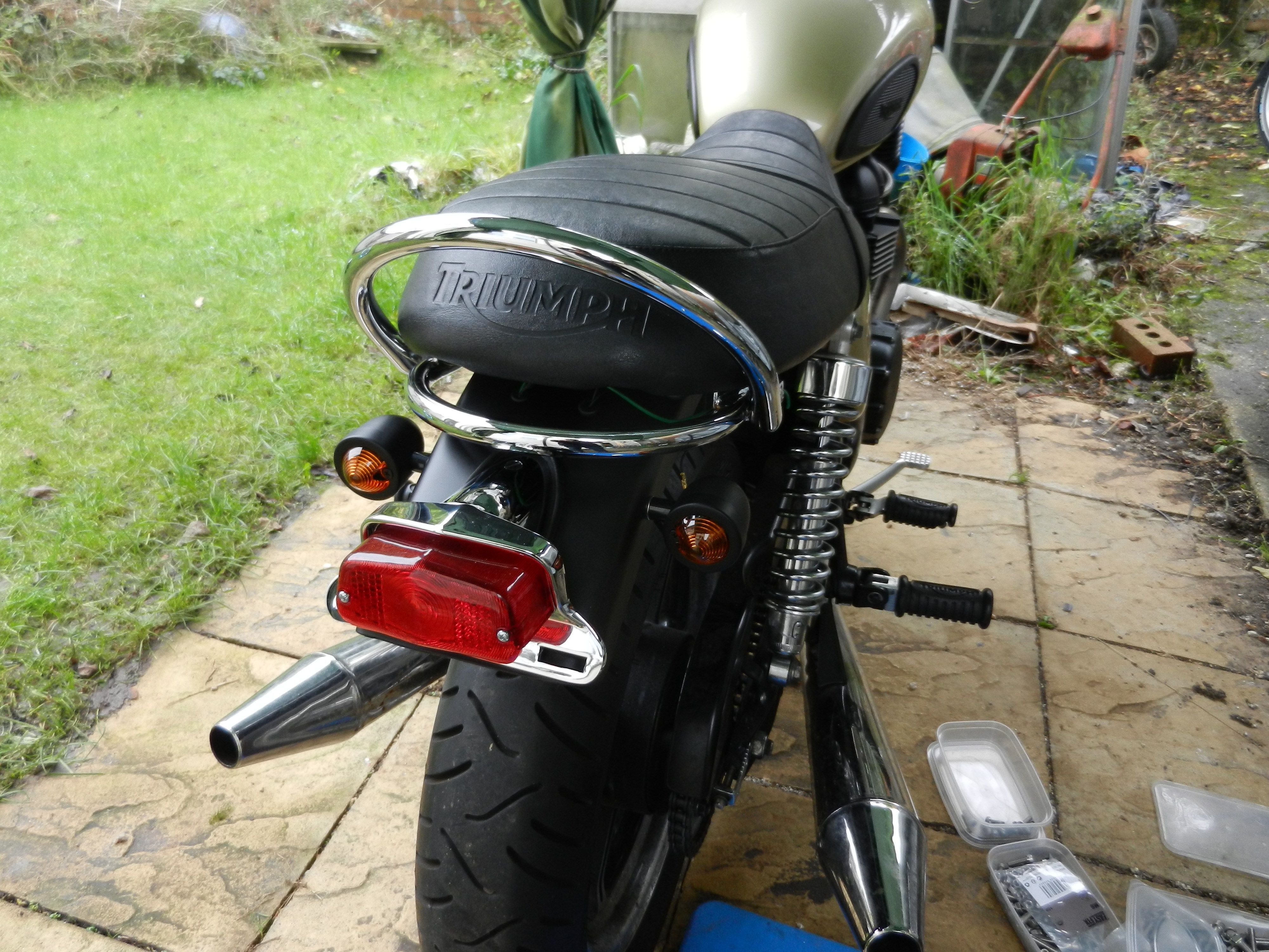

    Here's a pic of the back end of mine, I replaced the rack with a second hand grab rail, the mudguard is a chopped down old trailer one and the indicators are cheapies from M&P.

  18. steve lovatt
    9,211
    Looks neat. Are the indicators bolted directly into the mudguard? Also curious about the exhausts - what make are they?
  19. Essexboy
    Essexboy Active Member
    Apr 16, 2017
    183
    Yes I was looking for somewhere to fit them that would also allow me to use throw over panniers and simply drilling into the mudguard seemed the best place. In that photo they are just straight through but since then I've made up some ally plates sprayed satin black to match that spread the load across a bigger area of the mudguard to hopefully guard against vibration fractures. I also made up some matching ally plates to use on the front to disguise to a degree the indentation where the original indicators fitted. Obviously the wiring to the tail light and indicators is secured and protected where it has to run under the mudguard.
    The pipes are Norman Hyde ones, they are loud enough to sound like a proper bike but have enough silencing to allow me to creep past plod or go out for an early ride without the neighbours kicking off. Personally though I think they splay out too far but I haven't as yet figured how to modify the mounts to bring them in but still clear the swingarm assembly.

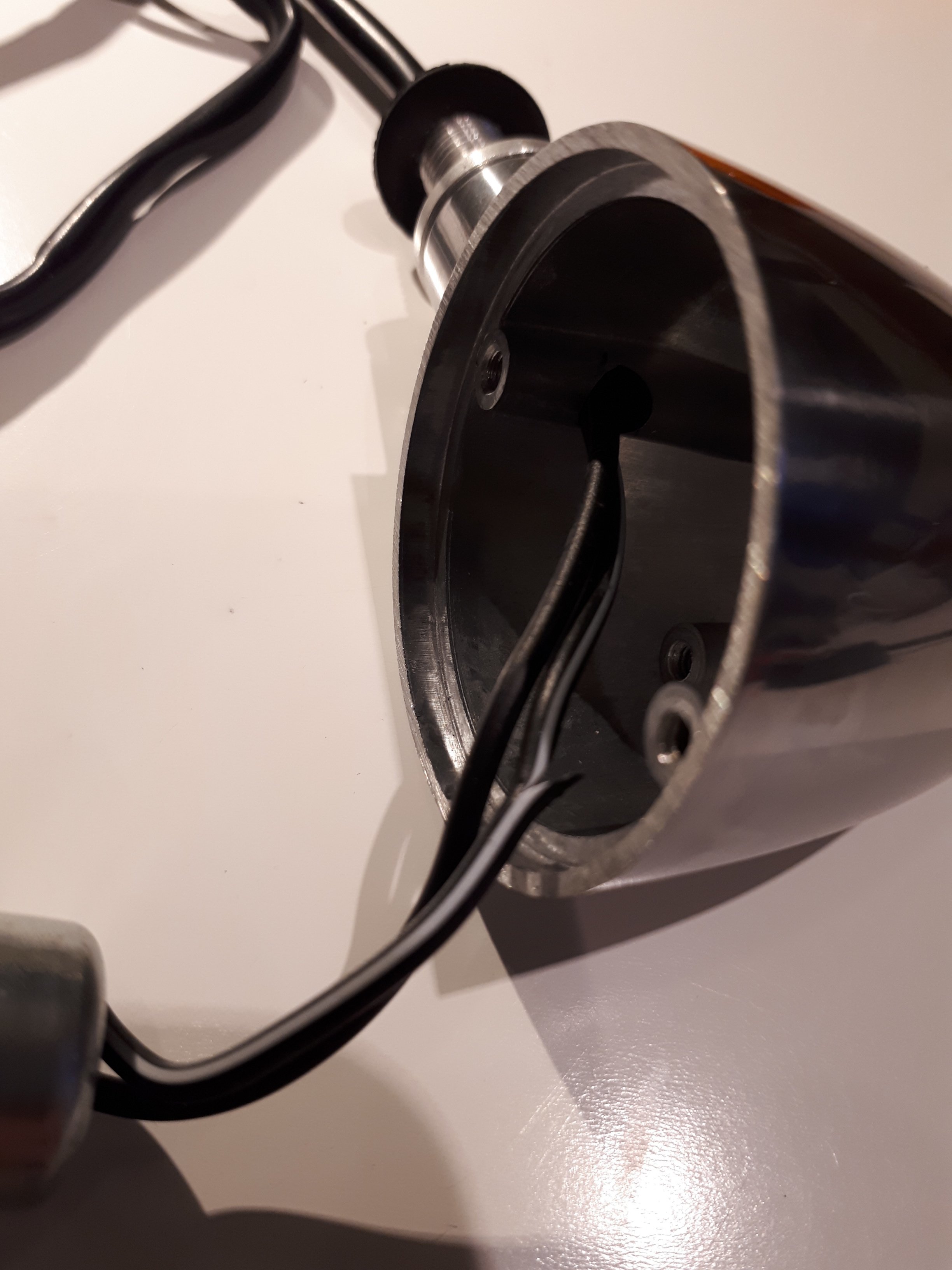

    Well guess what? Half way through a ride and the RH indicators stopped working!
    LH side work OK and at normal speed but both front and rear RH ones don't.
    First job - swapped bulbs across and the RH bulbs work in the LH indicator.
    Second; checked fuse No.7 but as the brake light and horn still work it wasn't that.
    Third; checked the flasher unit - but figured that either works or it doesn't.
    Fourth; swapped indicators over at the front - RH one worked on LH circuit.
    Fifth; unplugged the harness for the rear indicators and rear light and both front indicators work fine!
    Sixth; tried another indicator as the RH rear and it worked.
    Seventh; took the RH indicator apart and found that the insulation on one wire had been cut and was shorting out.
    Problem solved - all working again! :cool::cool:
