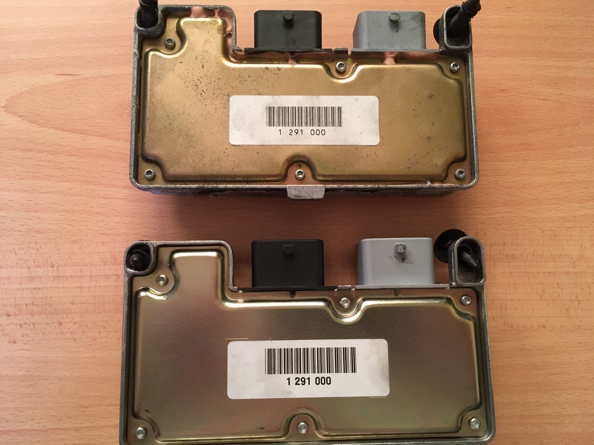

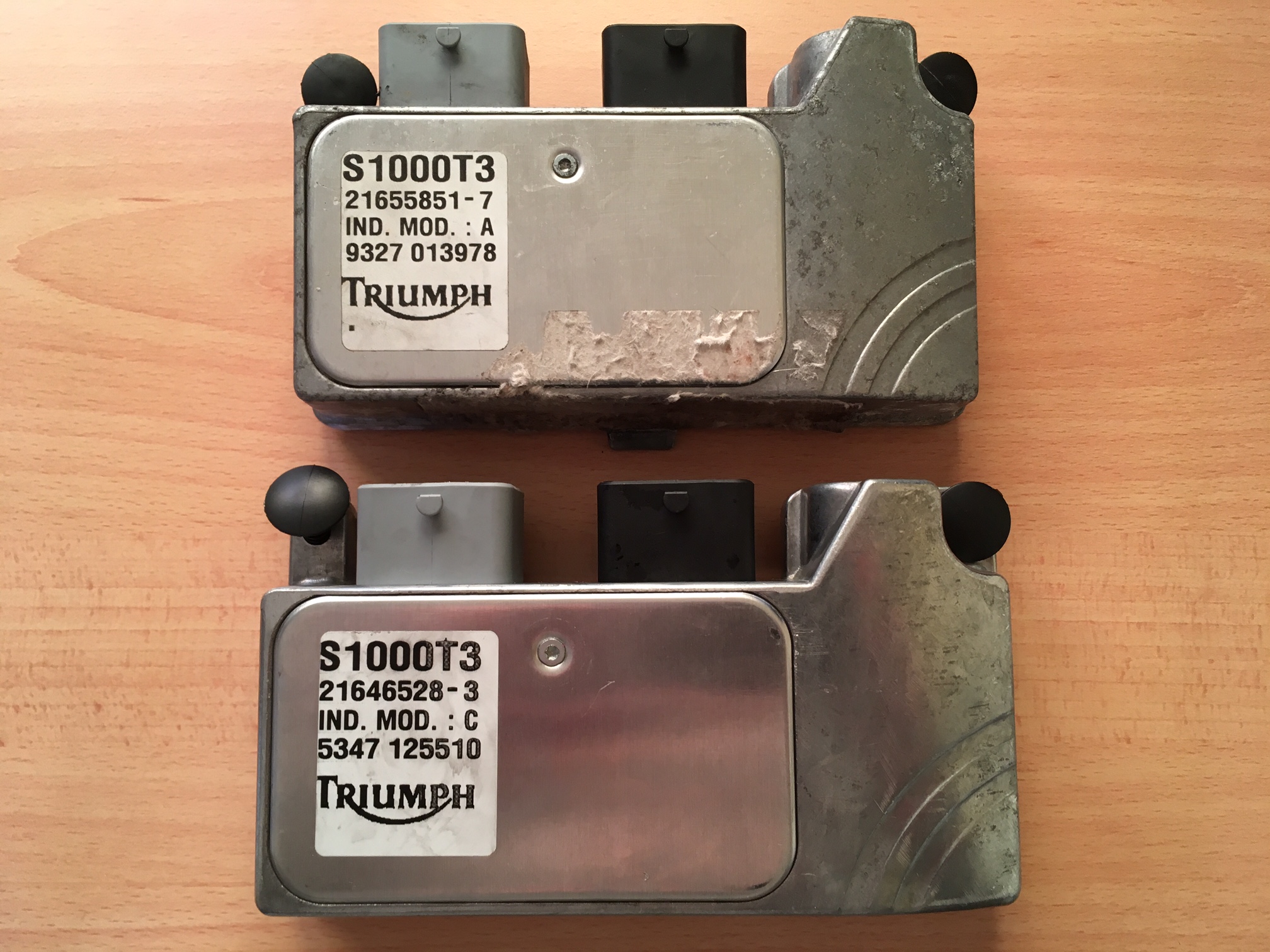

  1. I have today replaced the ECM with a brand new unit supplied by Fowlers using the bike VIN. The bike is a 2000 955i (Mk1 Shape).
    This particular variant does not have a fan relay and my fan is always on, always. Long story short, it is controlled directly by the ECM and I'm pretty confident my original ECM is toast. I have researched all of this at length from several different sources.
    Anyway, regardless of that, the new ECU appears to either be faulty or the wrong one. The bike does not prime the fuel pump and the ICV does not go through it's initial sequence either. Unsurprisingly it will not start. I plugged it in to Tune ECU and the ECU does not respond to the laptop at all - it will not connect. I tried at least 10 times using different ports on the computer and checking the connection, re-starting the laptop etc.
    I re-fitted the old ECM to the bike and the fuel pump and ICV do what they're supposed to and it starts immediately and runs perfectly. I have previously read and re-mapped (for a new exhaust) this ECM with Tune ECU in the last three months with no issues.
    I have re-checked the part on the Fowlers site and it does look correct and was ordered using the VIN. That said, some of the serial numbers on the front labels do differ but even so, I would still expect it to connect to Tune ECU even if it isn't the right module.
    So it seems that I might have a faulty brand new unit, anyone have any thoughts? IMG_1542.JPG IMG_1543.JPG

  2. I have found the issue with this now and its worth noting if you're looking at a new ECM.
    The ECM will not work or connect to Tune ECU because it is in a "virgin state". So instead of just giving you a generic safe map (with relevant warnings) so you can take the bike to the local dealer or connect to ECU software, Triumph just make it so only a Franchised dealer can unlock it.
    So for me that either means fitting it and hiring a van to get it to the dealer and a minimum of £45 to have it unlocked and mapped. Or fitting the old ECM, riding to the dealer and then paying them to swap ECM'S over and then unlocking & mapping. Either way it's at least another £100 on top of the £180 I've already paid.
    I'm not impressed, there's no need for it and apparently it's something that the manufacturers have only started doing recently. Fowlers are going to see if they can unlock and map it without the bike but I won't hold my breath. So it looks like a return for a refund and a hunt for a used ECM. :(
