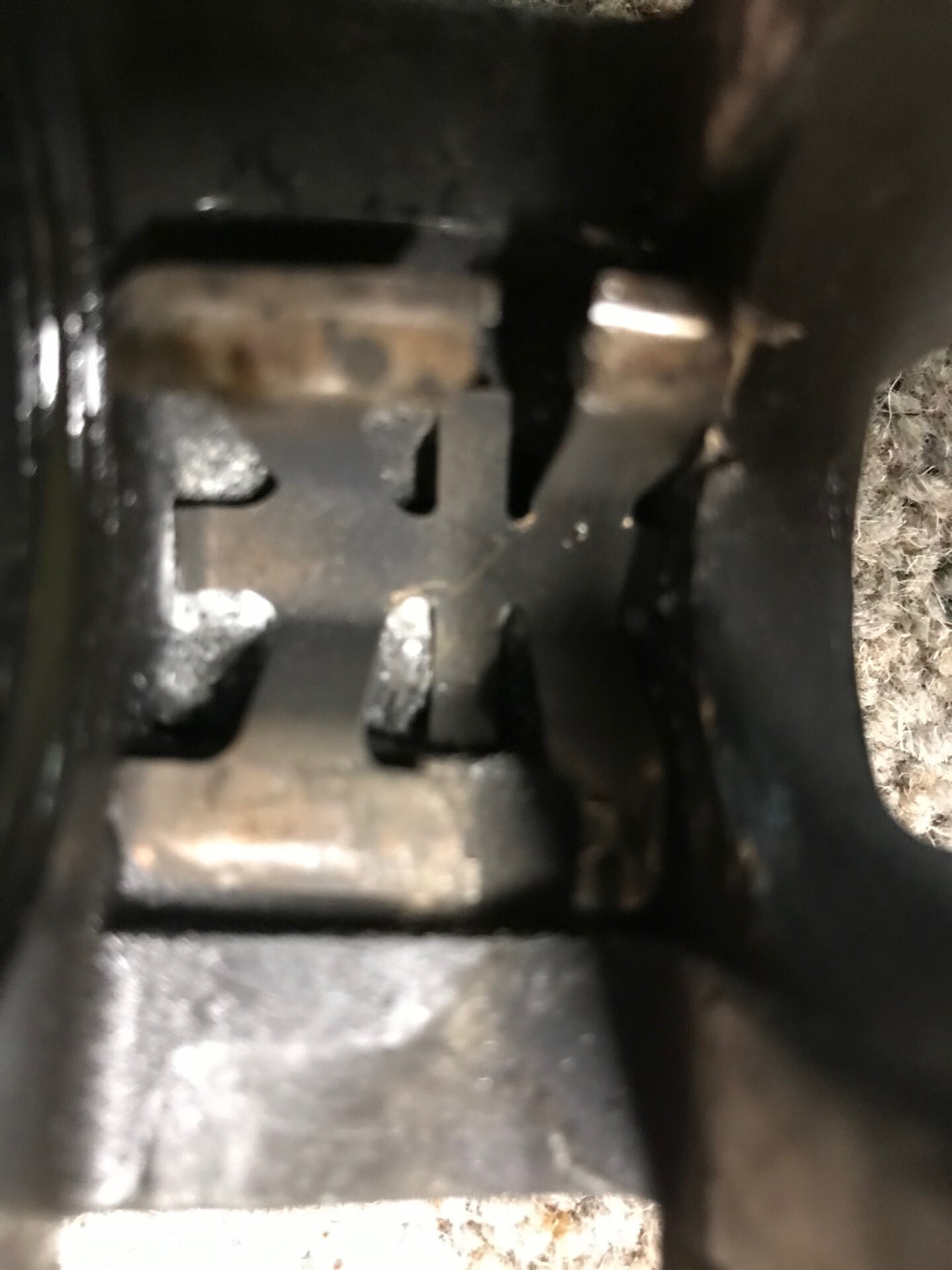

    Talking about brake lines, I had arranged to go for a ride out with my 2 sons and one of their friends, however when the sons friend arrived I could smell the rear brake pads burning the friction material, he said he could not smell anything, I got out a paddock stand and lifted the rear, the disc was hot and clearly the rear brake was binding badly, I told him to leave it with me and I would take a look later on in the week, my youngest son gave him a lift home. Anyway as promised I had a look (his machine is a GSX 650), so off with the exhaust and rear calliper unbolted, I could see the issue straight away, it's not the worst I have seen, but it wasn't great. Anyway a full strip, clean and re paint, a new stainless piston, new seals, new retaining clips and a new HEL Stainless brake line, a bleed and she was as good as new, (all parts supplied by Wemoto)a little issue was thrown up, the new nipple had a different seat so would have leaked fluid out under pressure, luckily I had some OEM ones and duly fitted one. The rear brake had obviously never seen any sort of maintenance, he had not owned it long and it has low miles, a hard life all the same. Original rubber hoses deteriorate over time, they may look and perform alright, but the risk far outweighs the cost/benefit, as we know brake fluid is Hydroscopic and moisture gets in the system breaking down seals and deteriorating hoses, they are also prone to microscopic cracking, not always visible to the naked eye. Anyway the lad was pleased especially as it will only cost him a brew on the next ride out.
