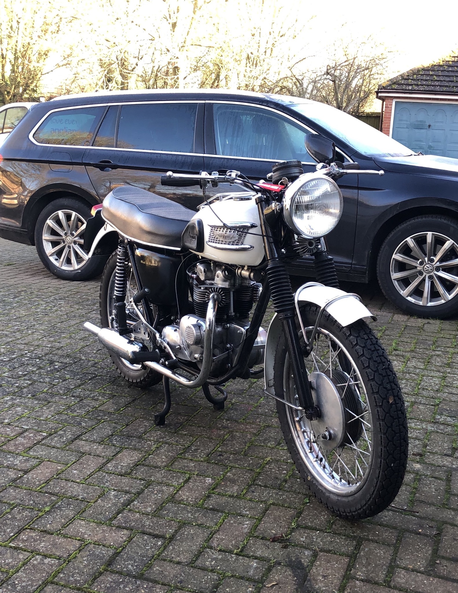

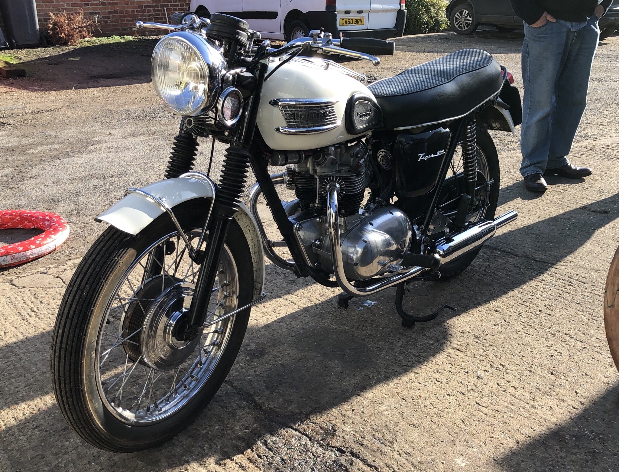

    I picked up a bit of a running resto fun project in November last year. It’s a bit of bitsa with no history to speak of but it was a reasonable price and it rode well on the test. More importantly the bike looked great in the sun from a distance and my body was telling me it was bucket load more comfy than my Zx6r!
    So what is it?... it’s originally a 1959 Triumph 5ta that left the factory in amaranth red. At various points along its10 previous owners its lost its bath tub and been converted into a semi t100c scrambler look. Which is why I liked it. The biggest change is that it’s got a later 1971 engine fitted, good news I think from a reliability point of view.

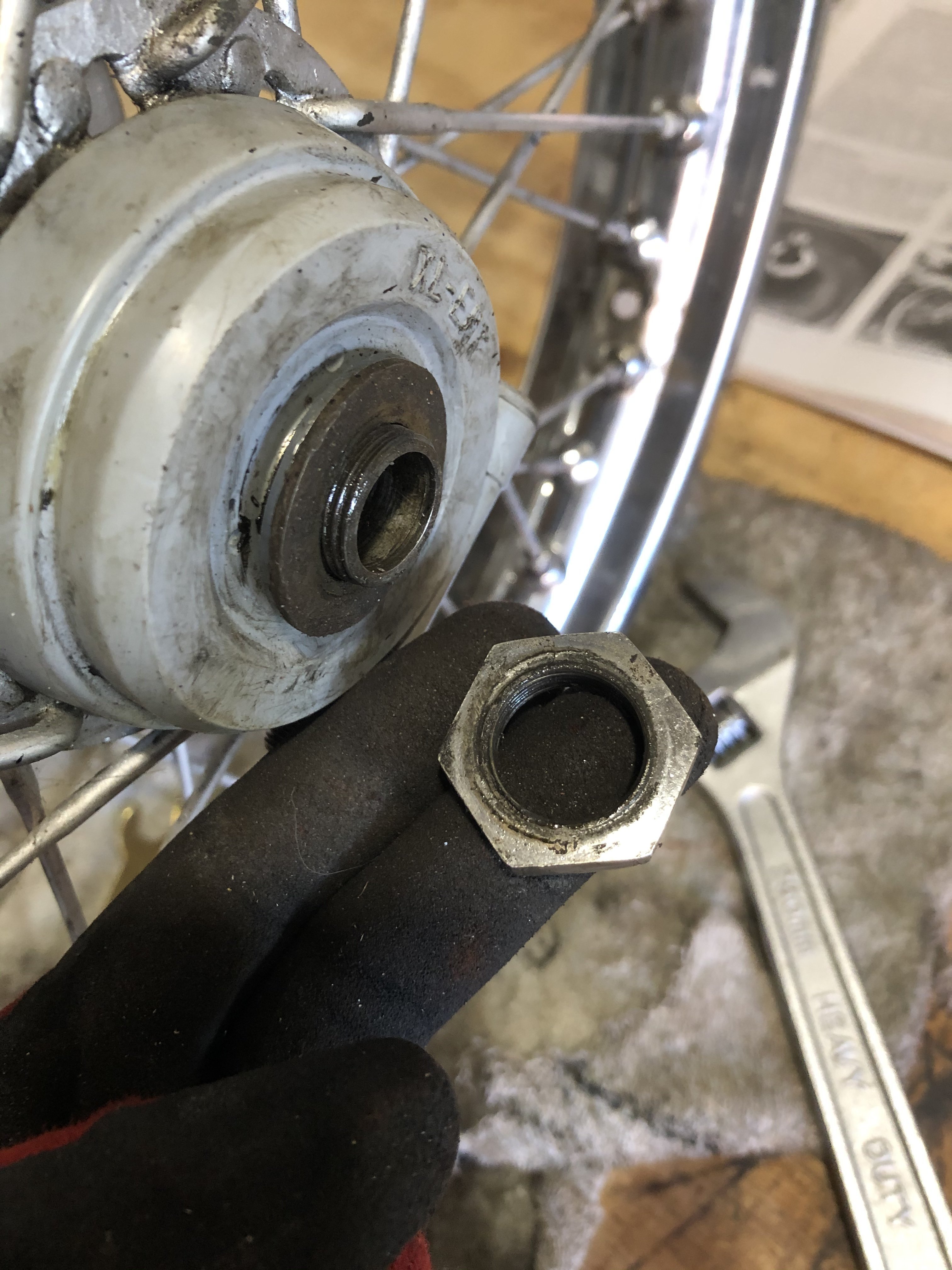

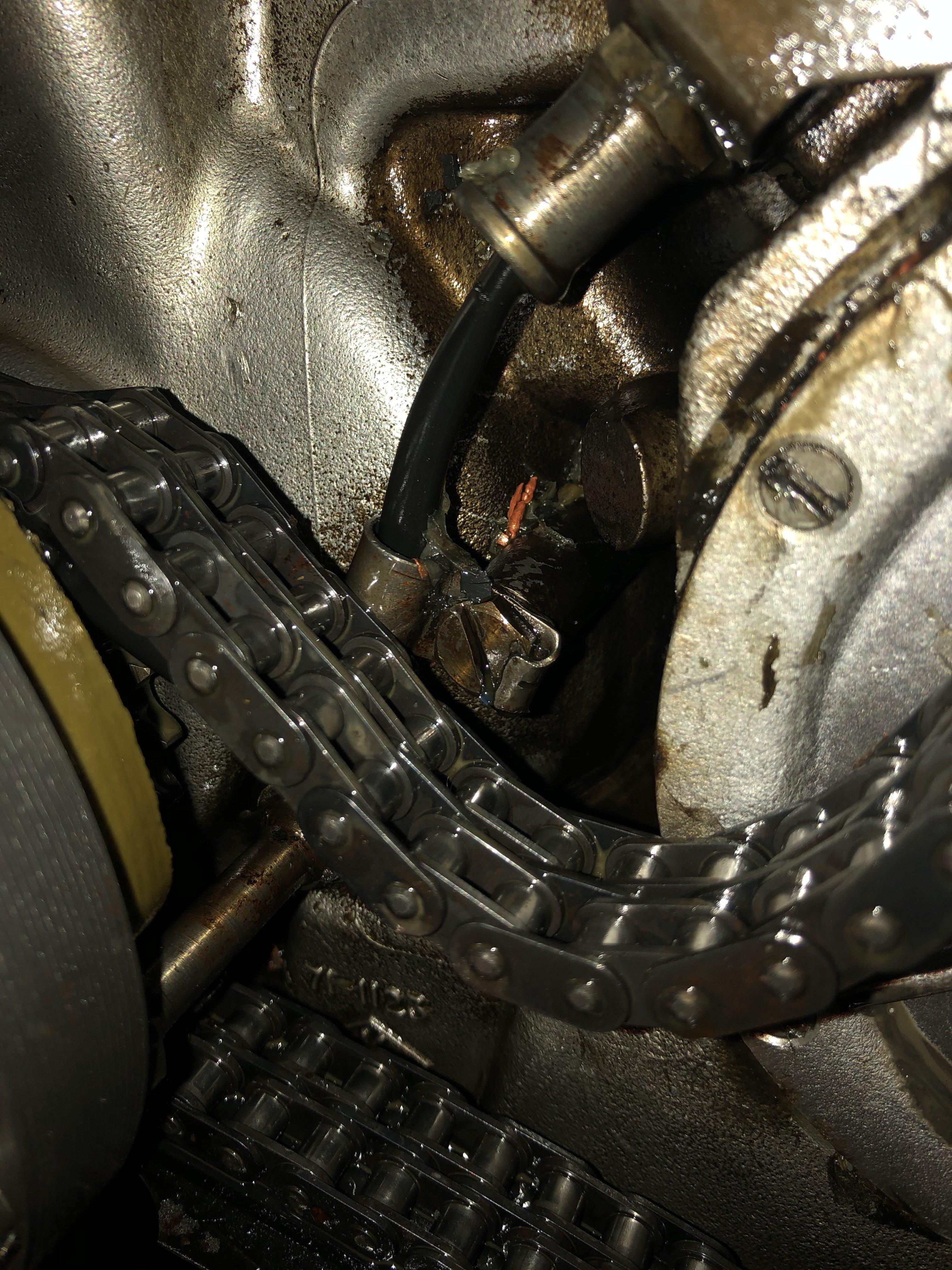

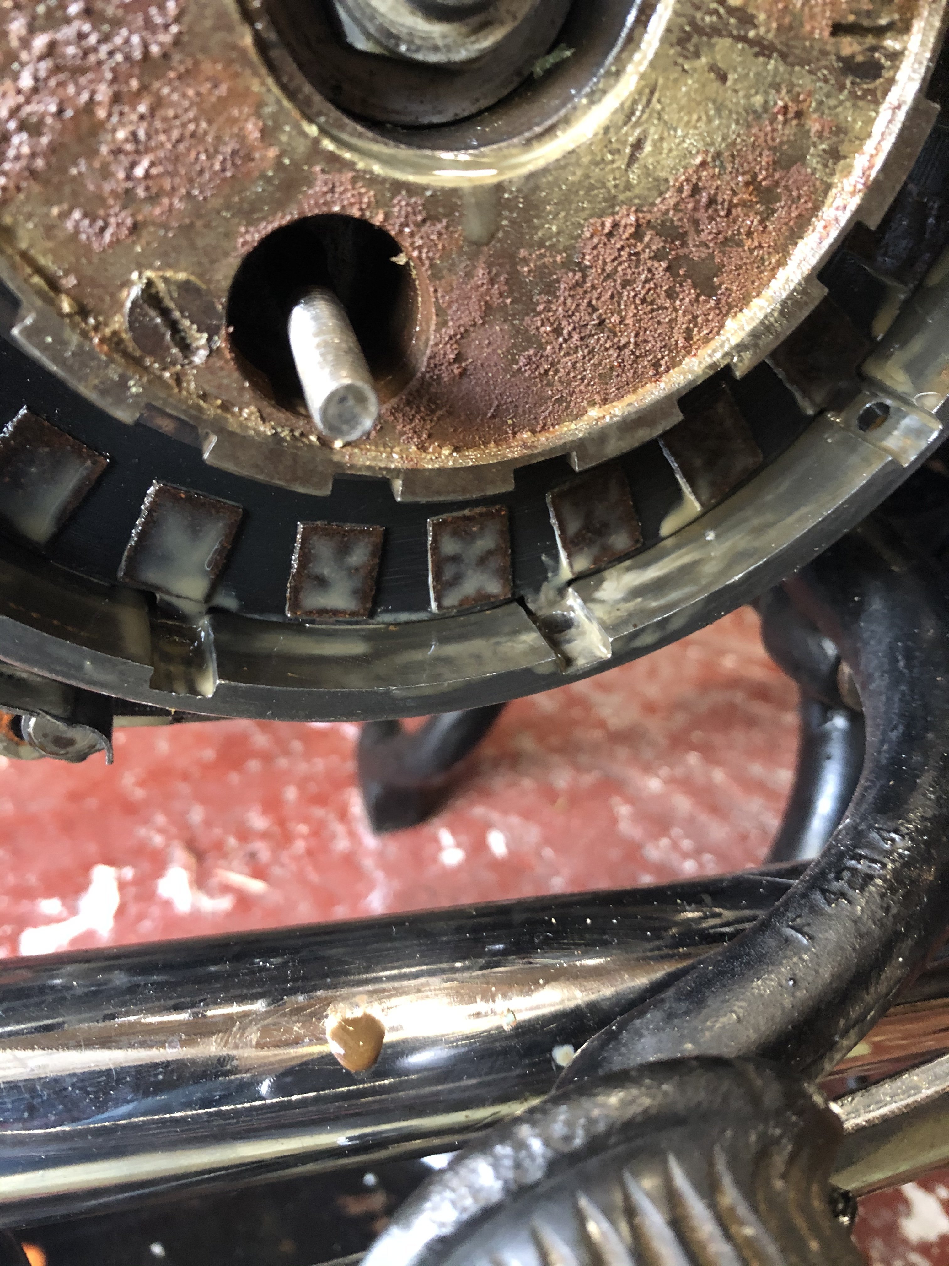

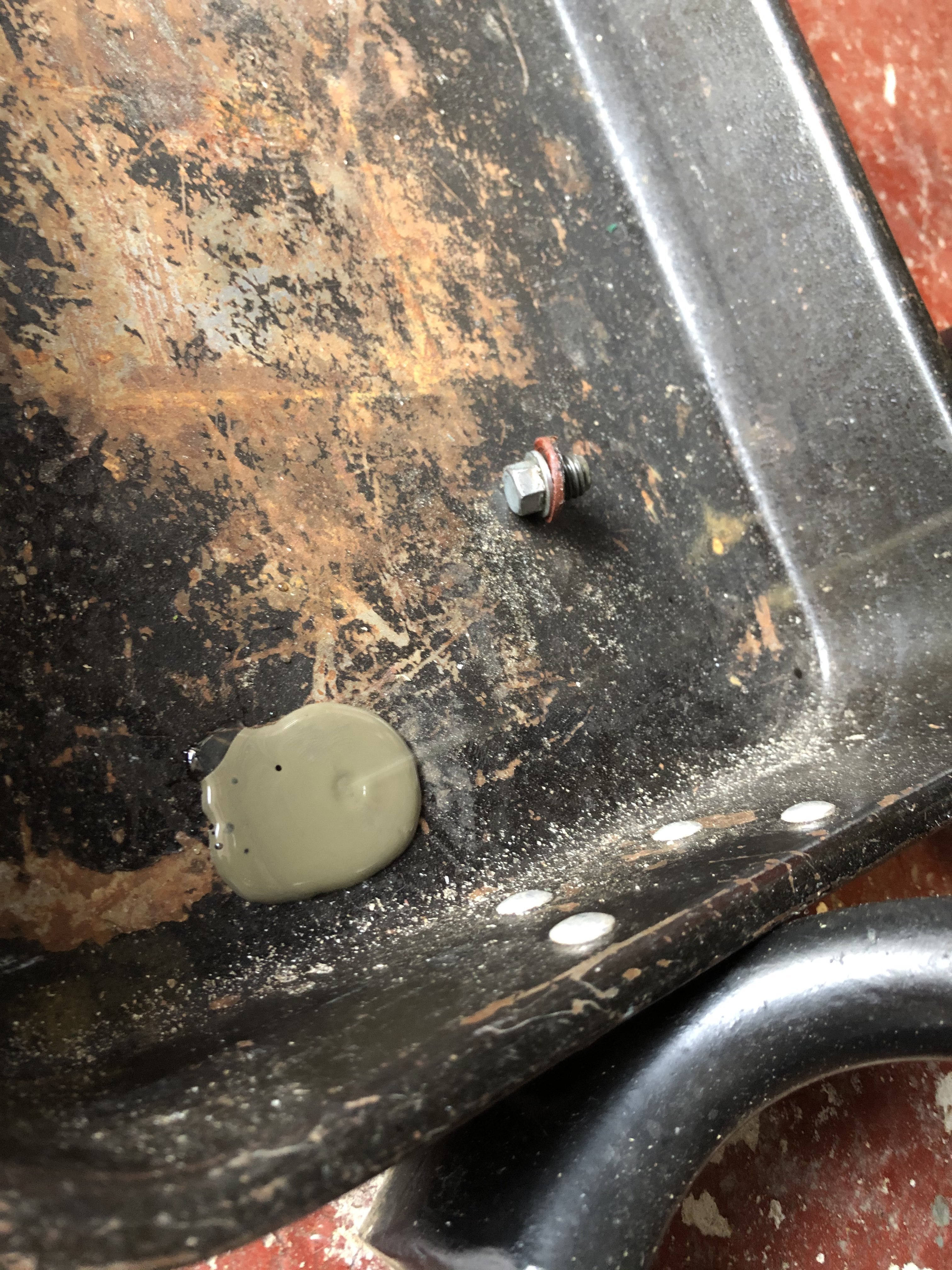

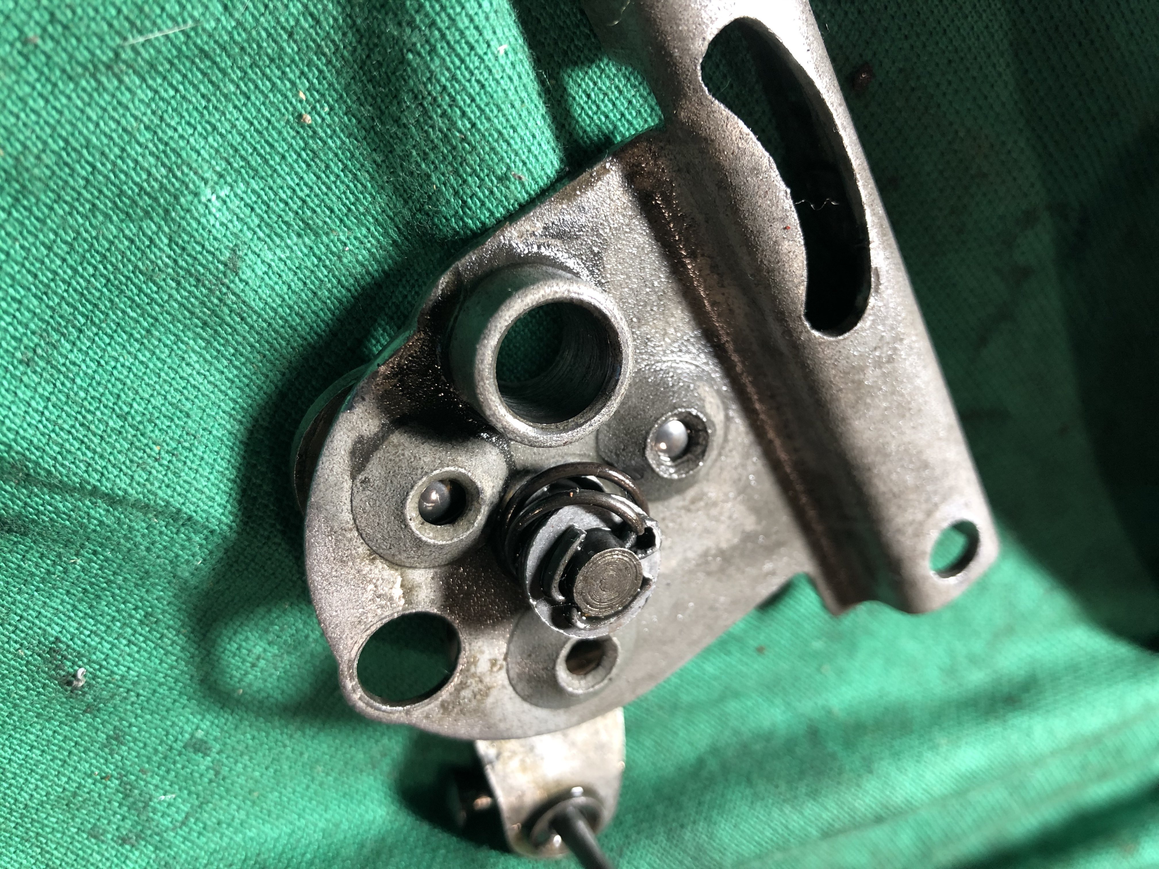

    Current situation is that after changing the front tyre I’ve noticed it has the wrong length spindle so the forks need to be squeezed together about 6mm ish to fit, so need a new Correct one of them. Rear QD hub has the wrong nut on the Speedo/bearing sleeve, previous owner just added an extra flat washer as you can’t tighten properly so need to get the correct nut. The bike was charging on the test ride but now doesn’t so need to investigate that (I’m thinking it’s the solid state regulator maybe?). The clutch kept sticking and then went ping. On inspection the primary oil was like pea soup so Completely stripped the Clutch/primary and discovered not only pea soup but also loads of bits of silicone sealer used on the gasket that was merrily clogging up everything Including clutch plates so I’ve cleaned and sorted that and put a new alternator Cable rubber. Just need to make a new gasket. On the outer gearbox side I looked to check the ping and found the clutch return spring had snapped. At the same time although the oil in the inner gearbox looked pretty good through the filler cap, the outer was filled with a layer of treacle filled with loads of glitter which is a bit worrying. It was also covered in bits of silicone.
    the biggest issue is that I’m building a picture that While the engine feels solid, doesn’t smoke or rattle the last Person in there clearly liked silicone and I can see it has been used on the crank case too. So I’m guessing the crankcase is also swimming with bits and my fear is the sludge trap/oil ways will be blocked... I’m now resigned to pulling it apart and cleaning it out.

    Hello, it looks a nice bike , sounds a frustrating project but certainly has potential
  11. Wessa
    11,343
    Hi and welcome, bike looks fantastic.......

    nice looking bike, have fun

    Thanks for the warm welcome everyone and for the kind words on tge bike. It definitely “looks right” in the flesh. Ive got some plans to do a bit tweaking and tidying to sharpen the looks up a bit once the mechanicals are stabilised. I’ll definitely be happy for some top tips! I’ll get some more pics up as soon as i can if your interested. This is the first forum ive joined so please shout if i “break” any unwritten rules. Im guessing i can just keep this thread updated but let me know if i need to do something different... hopefully might get some time in the current lockdown. Although im trying to juggle work and home schooling my daughter so i’ll see how it goes... below are a few pics of things ive mentioned in the original post such as the pea soup primary oil, orange n blue silicone, broken clutch spring and wrong speedo nut.

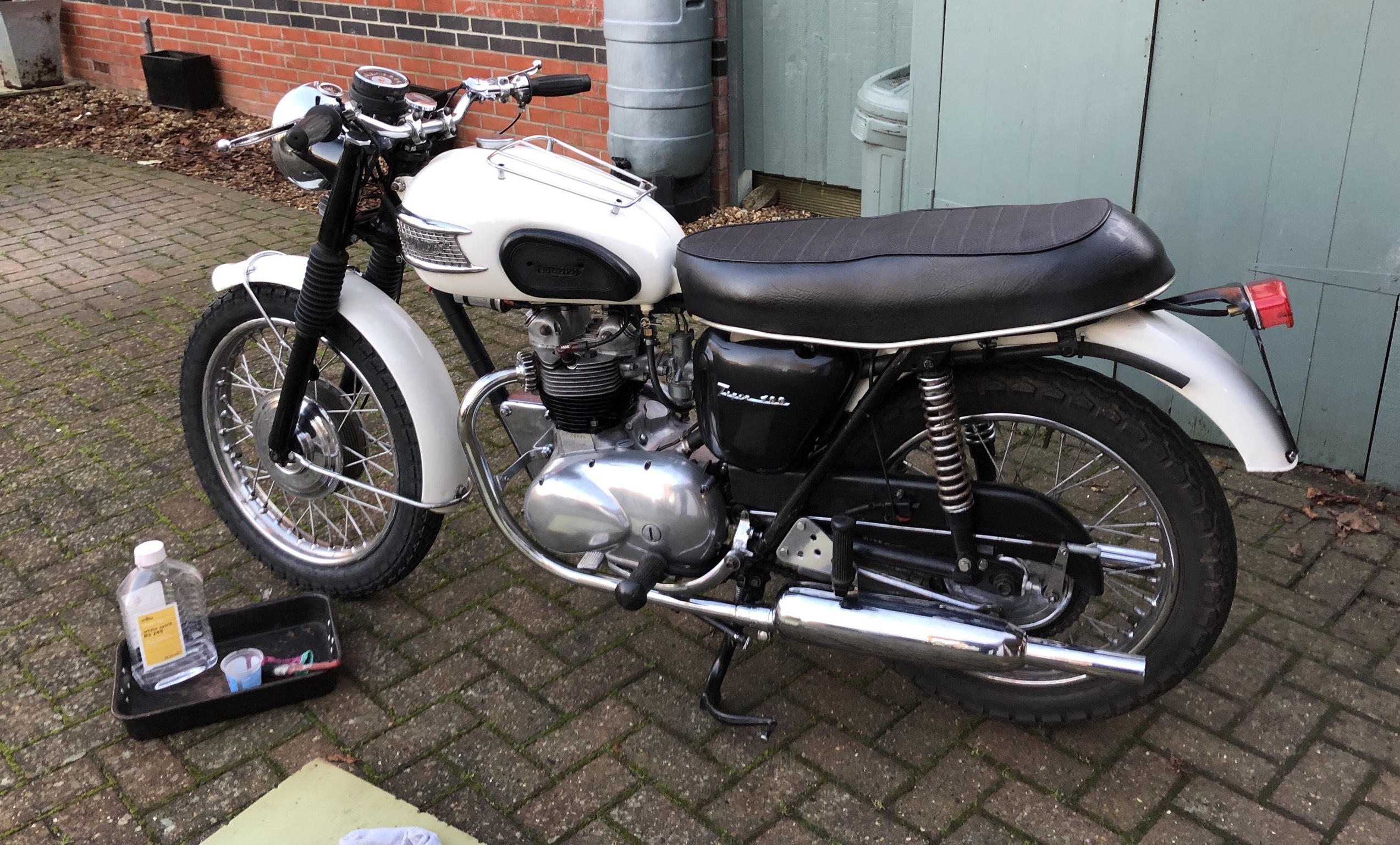

    Couple more pics

    if the forks are pulling together, it would be more of a spacer issue rather than the wrong spindle. if you dont have one, get a parts list as they are invaluable to see what goes where. lovely bike by the way, and sod the purists. i'm modifying a classic honda at the moment, but it's mine and i can do what i want to it!
