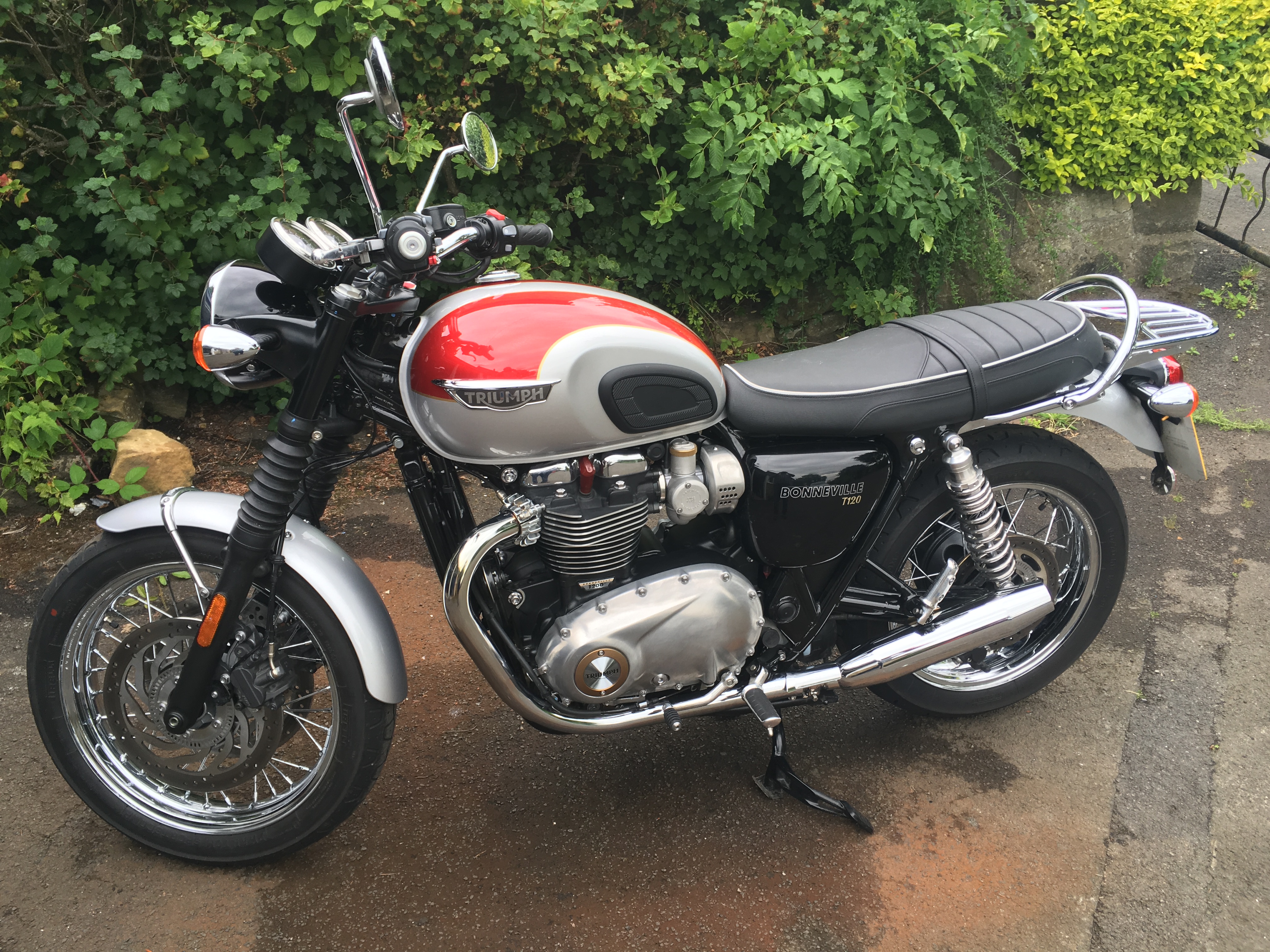

Ordered the Hagons Monday and got them Wednesday made to order superb service Had a go round the Borders and Northumberland yesterday and wow they have transformed the bike it's bloody brilliant now Here's a photo before the Hagons land and get fitted These are the very adjustable Nitron type

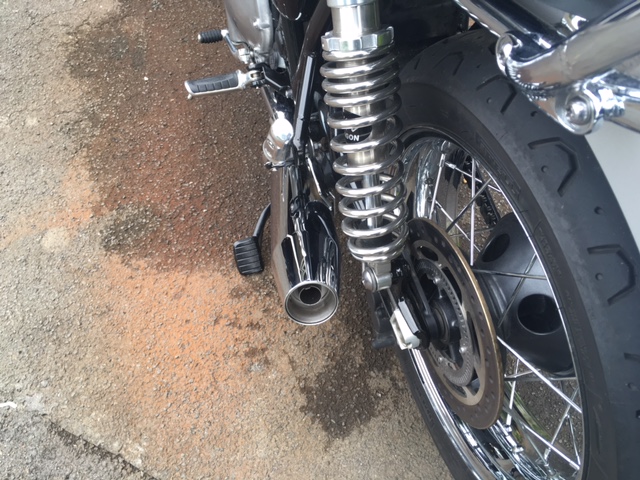

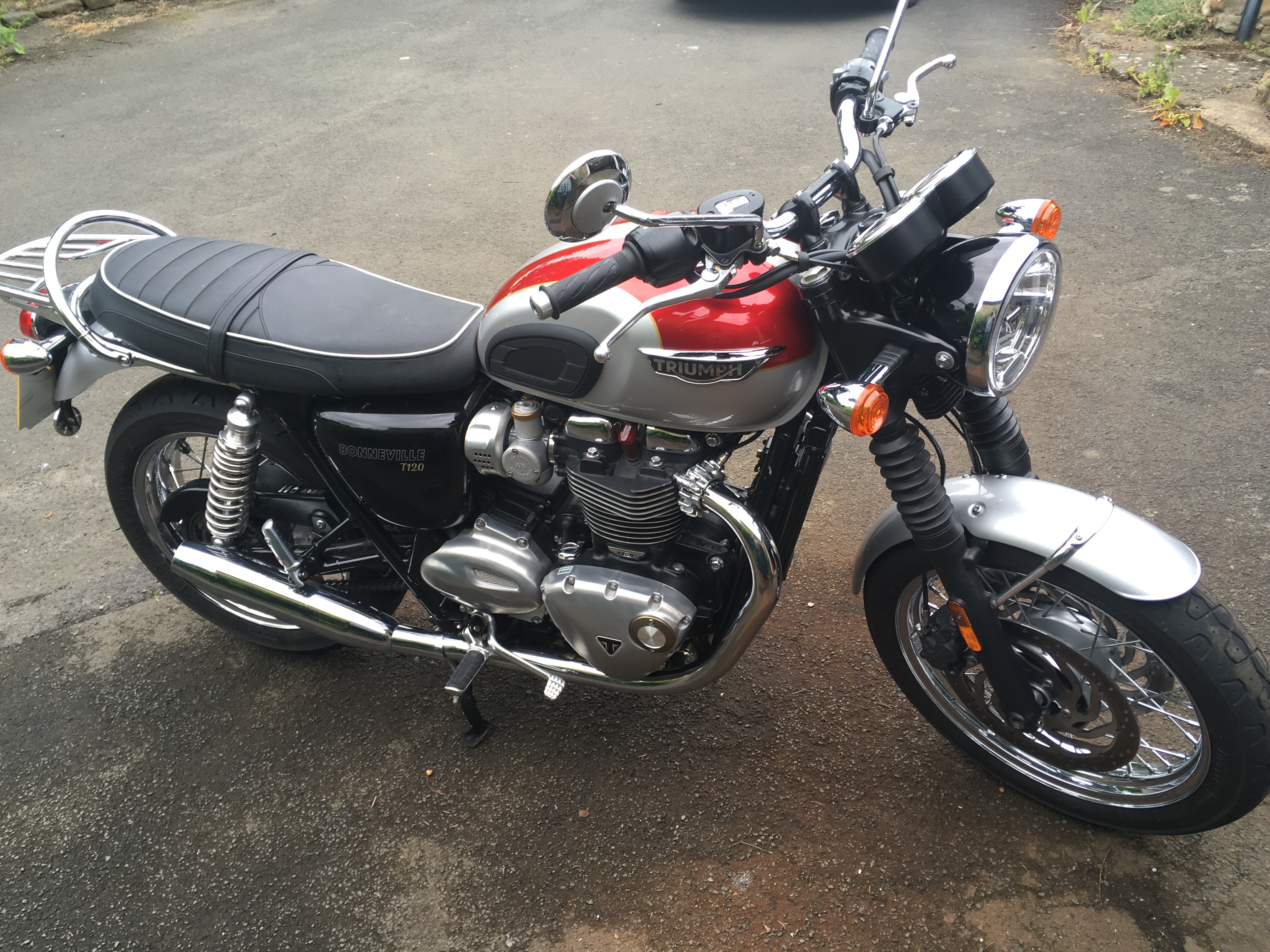

The Remus exhausts landed about 3 weeks after ordering and paying for them(made to order I was told) First impressions were of a genuine quality item. Fitted Saturday pretty easy job and all lined up well (mucho relief when they didn't foul the Hagon shocks) worked out at end I didn't need to take the pivot pins out of the pillion footrest to get to hex head of mounting bolt which necesitates an awkward refit with spring plate and ball bearing....next time just wedge the end of the bolt ! 'Heat shields' a bit fiddly and worm drive clips for these and one exhaust clamp bolt needed trimming slightly but no great issues. What wasn't obvious was how to remove the baffle plate. We worked out there was a small 'anti removal EU plate'stopping the circlip being compressed enough but once yorked out they finally succumbed and wow that's better Hopefully you can make out the before and after in the photos. Fingers crossed for a run out tomorrow to give them a try
