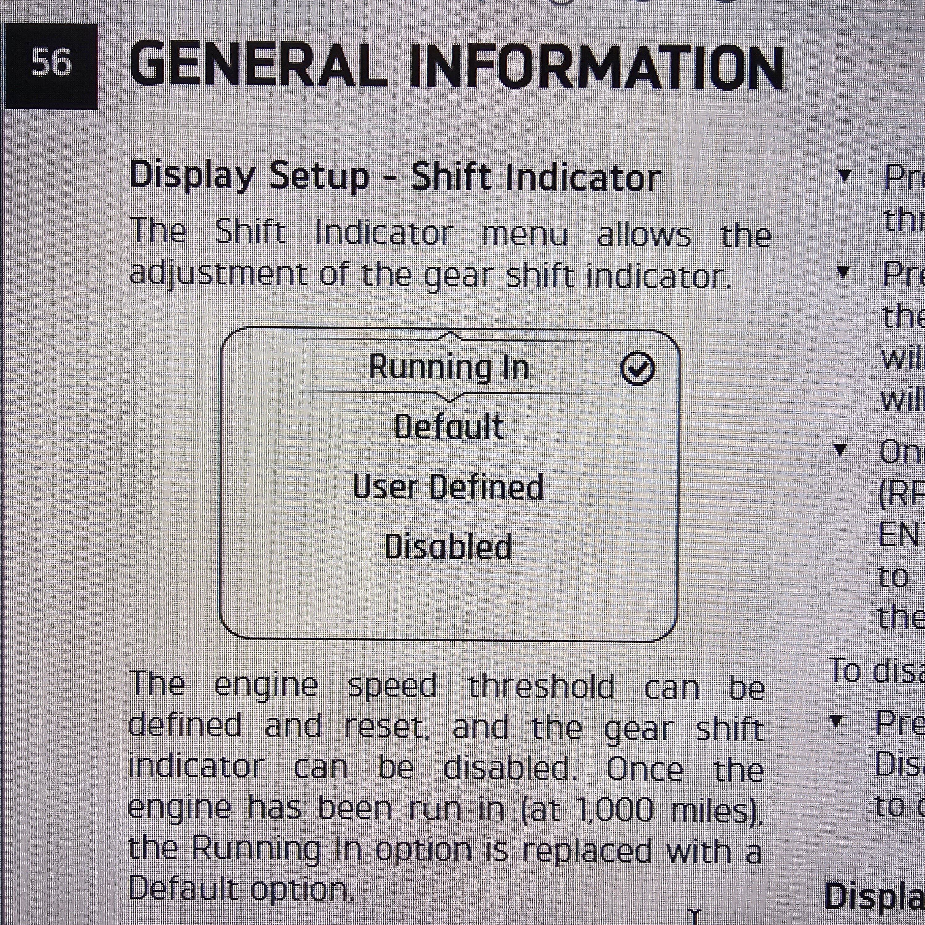

    Came across a bit in the manual about Running in

    If same as my 2018 RS that refers to a dash colour change behind the rev counter numerals, once you hit those revs.
    As far as I'm aware, and I had my RS from 270 miles, it only indicates!
    It's a threshold indicator and can be later user defined. May be someone could confirm if its user possible, or dealer only, to switch off the running in option?
    I have mine set at 11500 rpm ( after running in, now 12k miles) and think it's a good function, when going quick you only need to see the colour change in your peripheral vision to know when to change; no direct and conscious look at the numbers required.
    Apply common sense; don't slug it or rev too hard, and just enjoy the bike.
    I think you're overthinking things ;)

  7. FezUSA
    FezUSA Member
    Sep 1, 2023
    39
    OH, USA
    Looking at that pic of the manual, it looks like what I had for my new TS660 last year. The menu option was set to "running in" by the dealer. The result for my bike (no colour) was the rev counter flashing like a hopped up bunny on meth if I went over the pre-programmed revs. Can't remember exactly but I think it was like 3k for the first 100 miles, 4k from 100-300, 5k from 300-500, 6k to 600. Then when it went in for first service they changed the menu option to disabled.
    Other than the visual effect there was no actual impact to the ride. It's designed to remind you that you're in the break-in period and that they think you should do this in a "gentle manner". You can choose to ignore this completely and ride it like you stole it, right from the dealership. Your choice.
    The other options are to set the flash/colour change to your choice of how you would like to break-in the new engine or have it let you know when you should change gear after the 600 miles or so.
