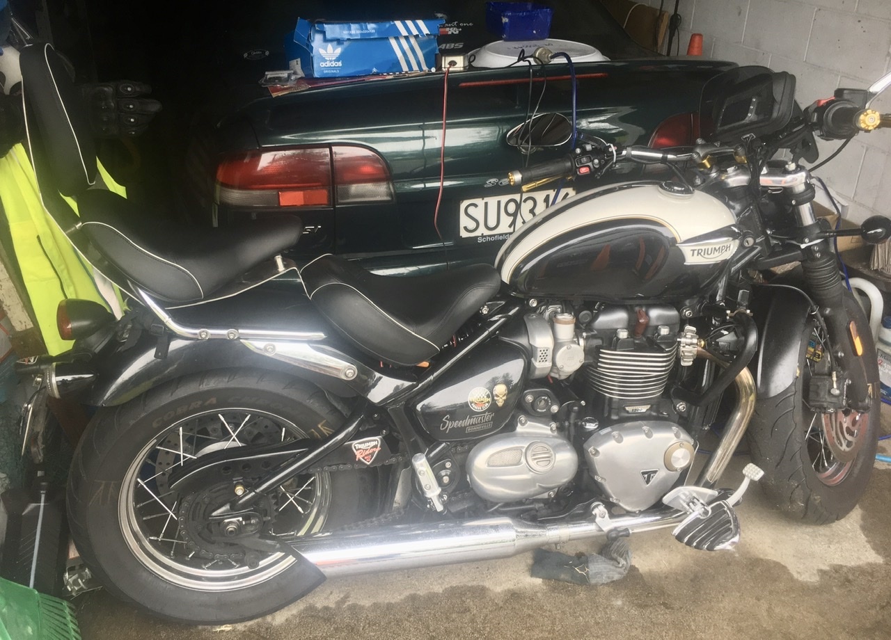

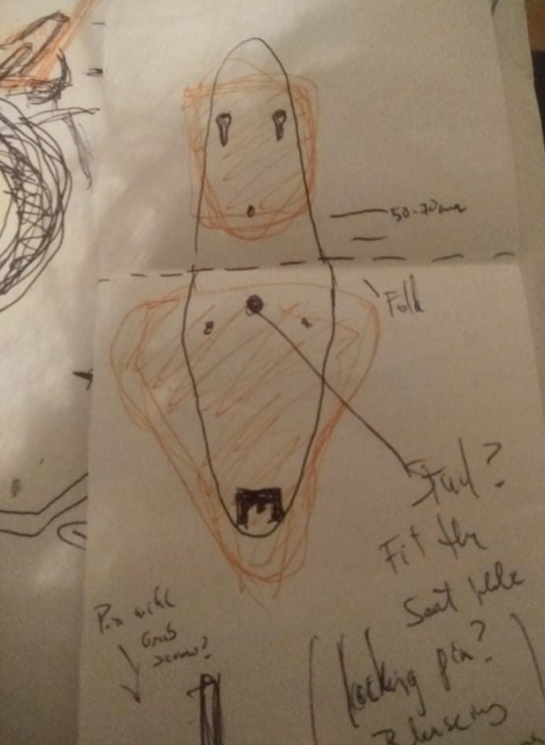

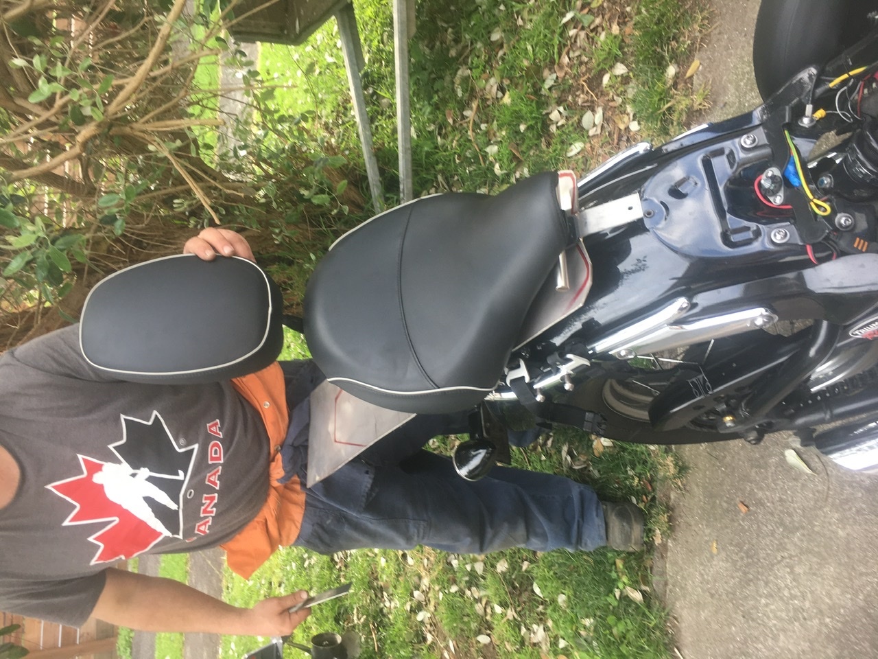

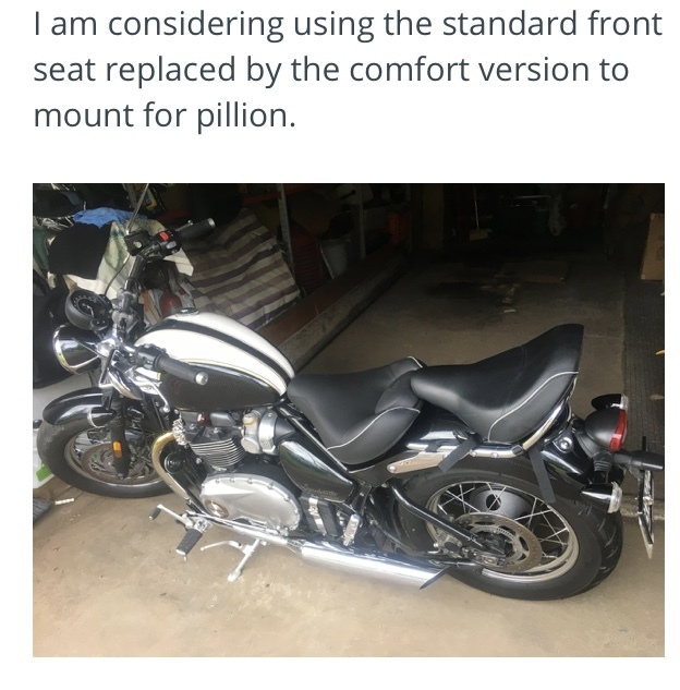

    Got some drawings and measurements done, then COVID :mask: put halt on project.

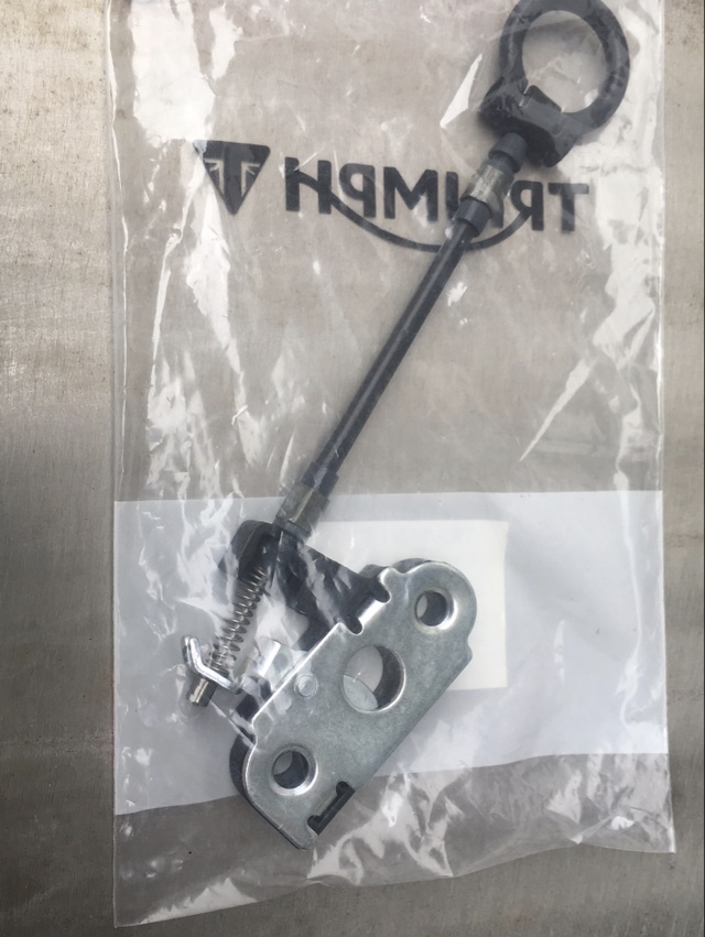

    Ordered new clip for original seat, as that one was needed for the comfy replacement seat
  3. Dartplayer
    7,873
    #3 Dartplayer, Oct 22, 2020

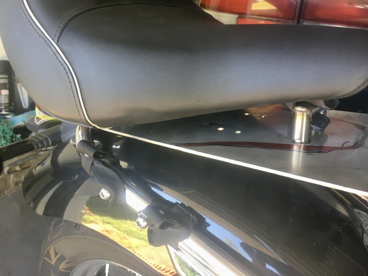

    Finally work resumed after the clip arrived and I sourced :p some 3mm stainless plate.
    final measure up and test “sit” for comfort :blush:
    loop will be attached to run the grab rail through for extra strength and safety.
    Awaiting final welding before deciding on whether to polish :cool:

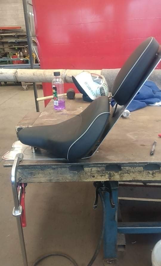

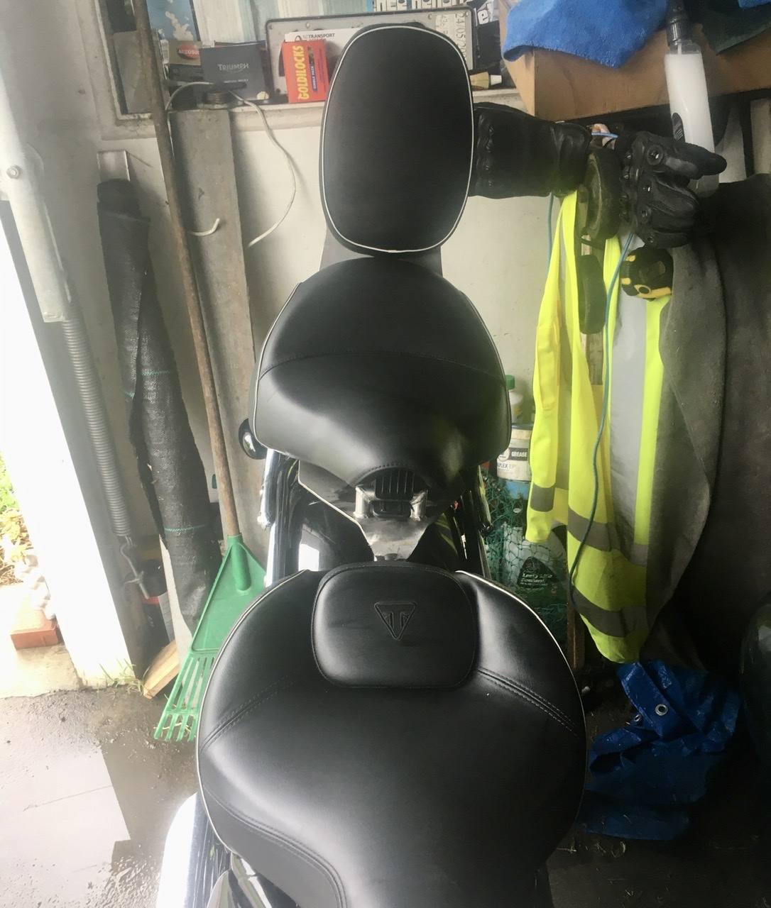

    Ok, we have some progress. Final measure before completion for Mrs Dartplayer Xmas stocking.

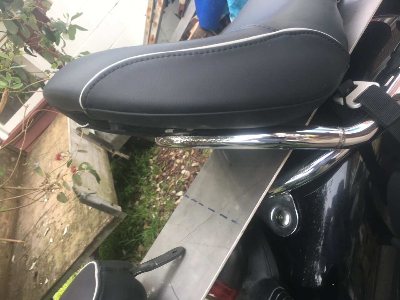

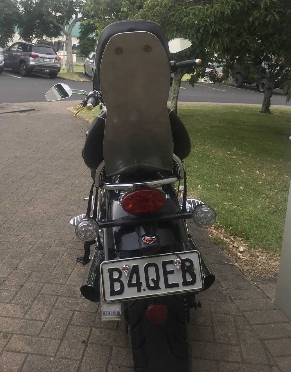

    Tacked and fitted, ready for holiday trial riding.:p The rake on the backrest will need to come forward and have a gusset added for strength, but I am happy with the fit :cool:

    Finally, after modifying the position on holiday, a tack weld broke on the way home and I lost the pillion:sob::poop:. Managed to get a cheapy replacement on fleaBay :heart_eyes:
    I put it back in the shop for full welding and adjusting for backrest position.:)
    I finally got to fit it today.:cool:
  7. Dartplayer
    7,873
    Weather is shite for 3 days and we have just gone into level 3 lockdown for the same period (for now), so will be a while to do the final test ride :cool:
    Mrs Dartplayer is happy with the look and new angle :heart_eyes:

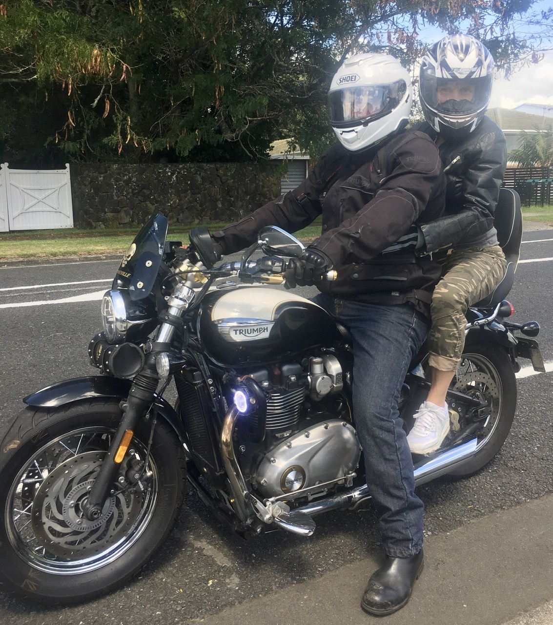

  8. Dartplayer
    7,873
    Takes less than 10mins to fit and I have trialed with my luggage for 1200km, so took Mrs Dartplayer for the final comfort test and got sign off :p There is room to relax back once she is more accomplished as a pillion, but is now open to coming on minor outings on the bike :cool:
