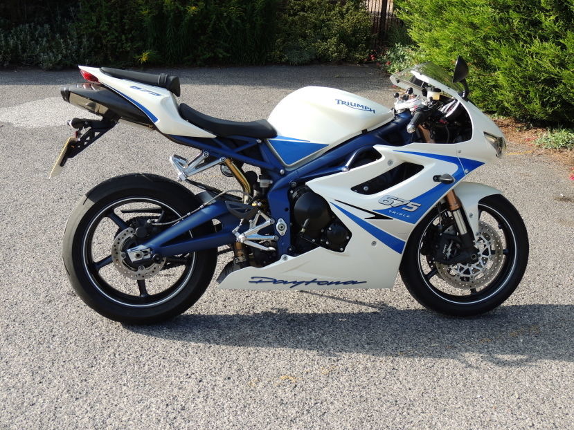

    Hello All, Names Lien and i ride a Daytona 675 2010 plate.
    new to this forum page and I could do with some help.
    Due to my circumstance I have had to leave my bike sitting for a few weeks and I come home the other day to find my bike making a high pitch constant whining. It hasn't been started in about 2 weeks battery is connected and so is an aftermarket tracker. Does anyone know what this noise could be ??
    I have had an issue with a intermittent high pitch beep which was just a 10amp alarm fuse but this is a constant high pitch tone (possible dead battery I'm not sure)
    If anyone can help or give some suggestions I'm all ears !
    Thanks in advance Lien!
