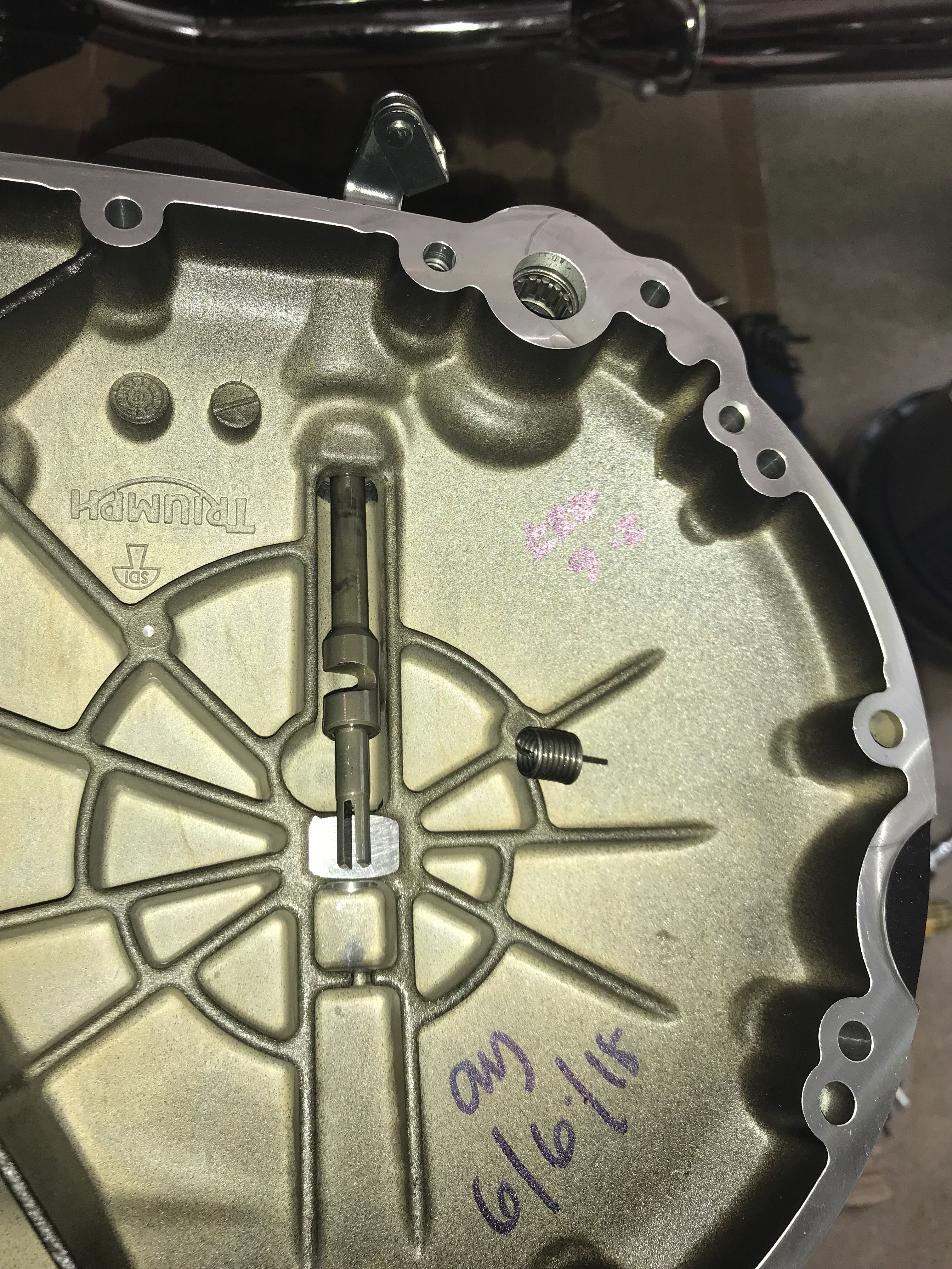

    Hi all,
    I’m new here and I’m in a bit of a rut. I own a 2018 Triumph Speed master. I replaced my clutch cover to the black one, but I’m having a tough time getting the clutch cable to be taunt enough. I didn’t touch anything on the cable, simply too it off. It almost seems like the spring inside isn’t good enough to keep it taunt. Any suggestions would be very much appreciated

    I was able to complete the job and found out why I was having such a hard time. The valve on the inside cover needs to be open so it fits on top of the little center axis of the clutch which pulls it out. The arm which attaches to the clutch cable should be facing away from the bike when you put the cover on. Tighten it down then rotate the arm to meet the cable.
    CHEERS! God bless.
