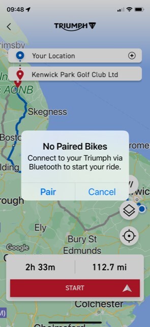

Hi all, I'm hoping someone out there can help. I've had a look through the forum already and whilst there are some similar issues regarding the app I can't find one that's exactly the same. I am having issues with the navigation portion of the MyTriumph app. I successfully paired my iPhone with the bike for music and telephone and then used the app to enable the navigation portion of the connectivity. Upon doing so I get a prompt on the TFT which I accept and then once completed I can see the navigation function on the screen, however, if I attempt to send an address/destination or route from the app to the bike I receive the error “No Paired Bikes Connect to your Triumph via Bluetooth to start your ride”. I can confirm that there are two Bluetooth connections from my phone to the bike and both show as connected. Clearly I put this down to user error on my part – perhaps I’d missed a step, so I asked for the assistance from my local Triumph dealer. They went through exactly the same process as me having first carried out a number of firmware updates to the bike so the bike should be fully up to date as of 2nd September 2022. Unfortunately we received the same error when attempting to send a destination from the app. They suggested raising this directly with app tech support, which I've done, but I usually receive better options from the forums! I'm defininitely using the latest version of the app - 1.2.2 and my iPhone is up to date (model 11 Pro, iOS version 15.6.1). Has anyone else experienced this and did you manage to fix it?

No I added the bike via Bluetooth - that seems to be the recommendation. I did try initially via VIN and it said no bike found or words to that effect. A tad buggy I would say in that regard. With regards to the iOS16 comment, yes I did read that and given mine didn't work anyway I have upgraded to that version. I am hoping that when they come to fix the nav issue with the newer OS they somehow manage to fix the issue I'm having. I have been told by Triumph it seems to be more of an iPhone issue as 'all of their Android phones work fine'. We will see.
That might be the issue as mine didn't work correctly unless added via the vin. Also, the dealer has to ensure that the vin has been entered correctly into the Bluetooth unit itself at installation. Ps, the unit is made by Samsung so it plays better with android.
