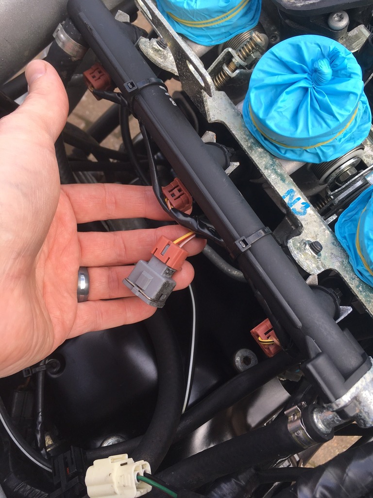

    First up. I have found a spare electrical connection (pictured below) that is zip tied to the fuel rail and is the same as one of the connectors to the injectors. It is on a slightly different "branch" of the loom but follows back to same "main trunk" of the loom if that makes sense? The wires going in to the connector are the same colour as those going to the injector connections. The zip tie securing the spare connector is the same as the other one on the fuel rail (securing the injector feeds) and they look like original factory fitment to me. Certainly the markings on the zip ties match. Anyway, any ideas why it's there and why it is not connected to anything?

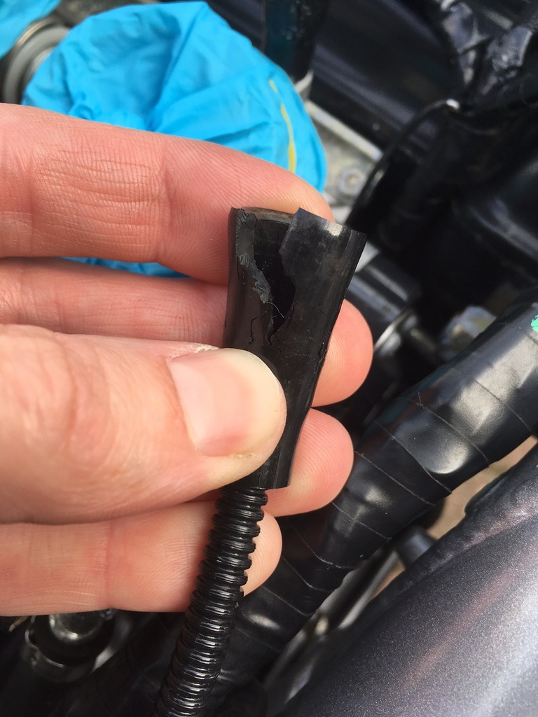

    Second, the bike runs well when it is cold but cuts out when warm and the revs drop to tick-over. I found that the barometric sensor tube collar was badly split (the tube that goes from the air-box to the ECU). Could this be causing the cut-out at low revs when warm? Picture;

    1. Re the split pipe - if it is not giving good vacuum it can seriously affect the quality of running and tickover. Here's how I would check it - using black tape, bind the bottom half of the split connection and cut of the split section. There should enough to reconnect to the airbox.
    2. Re the spare, apparently unused plug - I've had two different Triumph and they've both had unused plugs on them. This is due to the fact that the main electrical loom is the same for many versions and some - such as California bikes - have additional anti pollutions bits requiring power.
    2a. It's not the plug for the IACV control is it? This is a solenoid driven affair that control tickover and fit's into the underneath of the airbox on some models.

    the connector sounds like the one that's on California models to go on the purge valve.

    Re the pipe, daft question really as I will replace it regardless before I put it all back together. I was just interested if it could be causing the warm running issue. Clive Wood is of the opinion that the Idle Control Valve set-up is more likely to be the culprit. What he said makes sense, cold the bike is over fuelling and has a higher set tickover, both those things cease once the engine is up to temperature and if the idle control valve is not set correctly it will cut out. Like I say, I will replace the cracked air sensor tube and will be thrilled if it fixes it, if not it will be a trip to Clive for the ICV set-up for sure.
    The spare connector is for the California purge valve thingy and not so the loom can be used for 4 cylinder models as I previously (incorrectly) learned. Thank you.

    I had a closer look at the ICV last night and found that the rubber collars that attach to the ICV and the other end that attach to the throttle bodies are all perished to hell. Those collars are very similar is design, material and condition to the air-box one pictured above. It would seem likely that with these 6 connection sealing properly it will cure the warm running - result!!

    Shrink wrap and a smear of rubber grease on the IACV hoses cured the running/cut-out issue.
