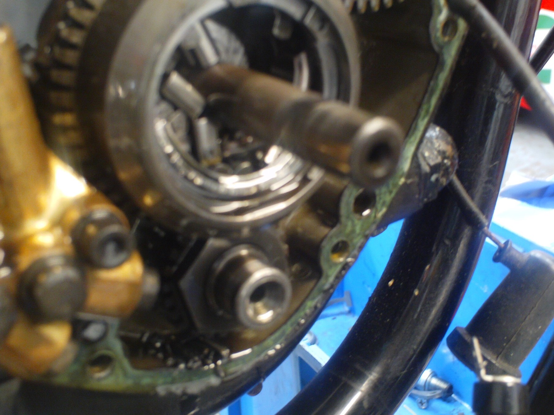

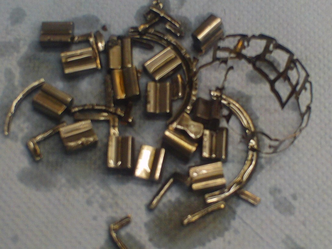

    FILE0041.jpg FILE0050.jpg Well peeps the news is bad. I decided to put my TSX Into cosmo as the engine was rattling. I got news i didn't want. Its needs a full engine flush and a clean out. Full damage not diagnosed yet but the starter sprag had designated and is floating around in the engine. Cosmo has said it is not going to be a cheap job. Now i got to decide have it rebuilt or scrap.

    Wow Joe, hopefully damage is confined to just the sprag as any small parts that might have got into the cases would have to get through the sump filter pump and back to the frame before even thinking about going back to the pump or engine.

    He ran the bike and changed the oil twice it was still pumping out swarf so it is well in there as he said you could clean out but it will fail eventually if not completely cleaned out with a complete strip.
