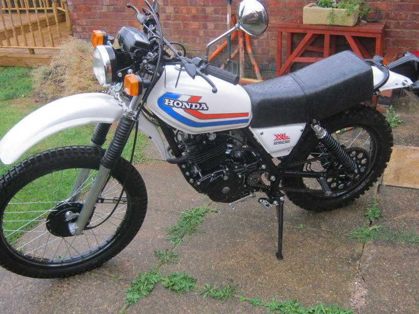

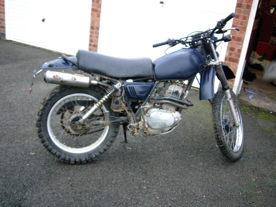

    Ok so its not a triumph, but it is a beautiful bike
    Full nut and bolt restoration, including full engine and gear box strip
    Its a 1978 xl250s

    Great job:upyeah:

    Looks really nice and it's a great bike :upyeah:

    I do want to do a D1 next, dont know what it is wit them bikes, but i have wanted one for years. The XL250s was one of them bargain bikes, it was a field bike but the chap had the V5, and i got it for £50, well it would be rude to turn that down. No where to ride it near me, so the only option was to restore her.

    Very nice job, congratulations.

    Fantastic job

    Hi Megga, you did a beautiful job on that bike, well done.
