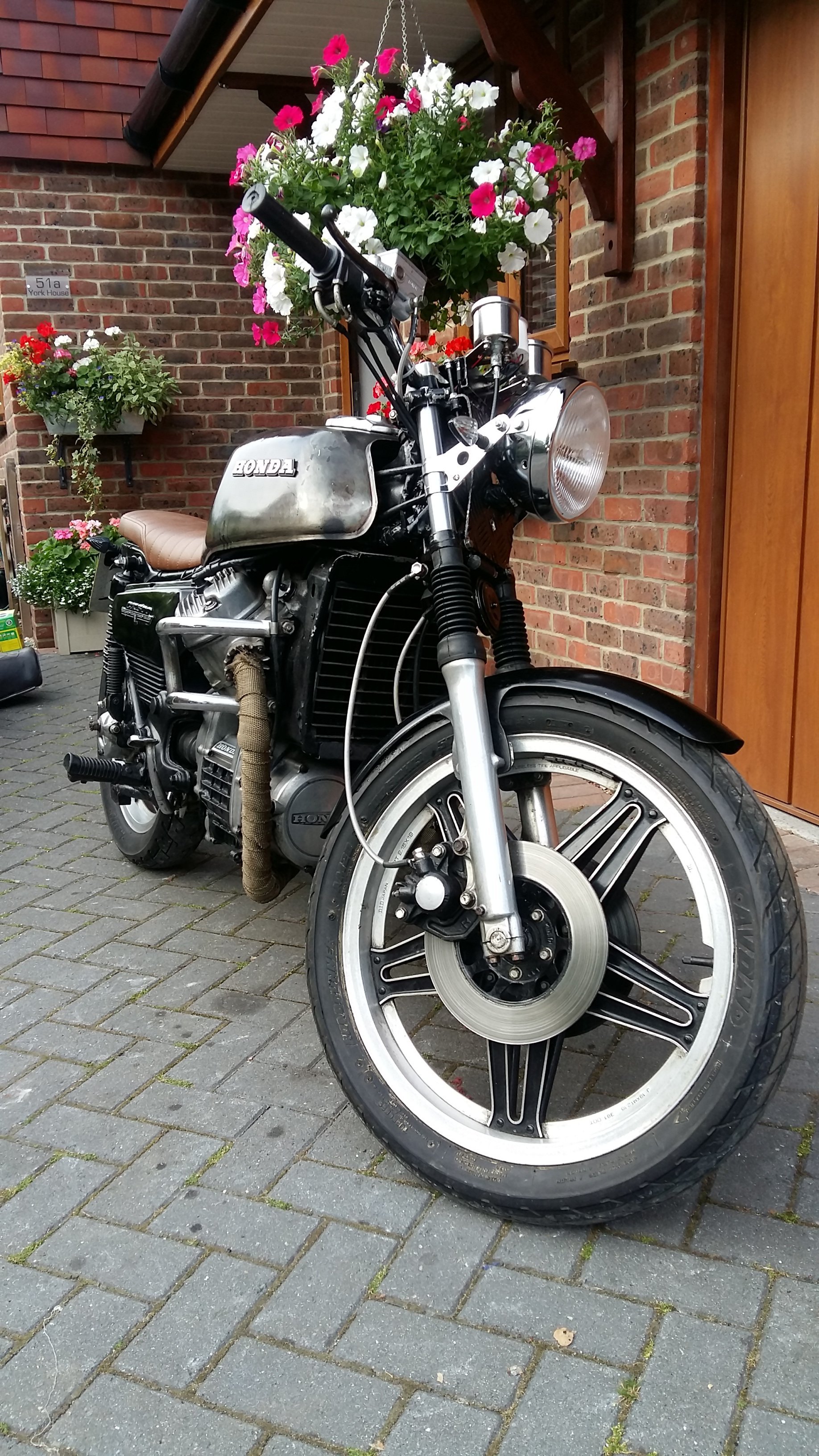

    Finally making some proper progress after countless dreary hours of old paint stripping and polishing!
    We've pushed ahead with the other bike (my mates) as he's done all the welding and fabrication for me and carted the thing to and from the paint shop.
    Here's a reminder of how it looked when I bought it last year.

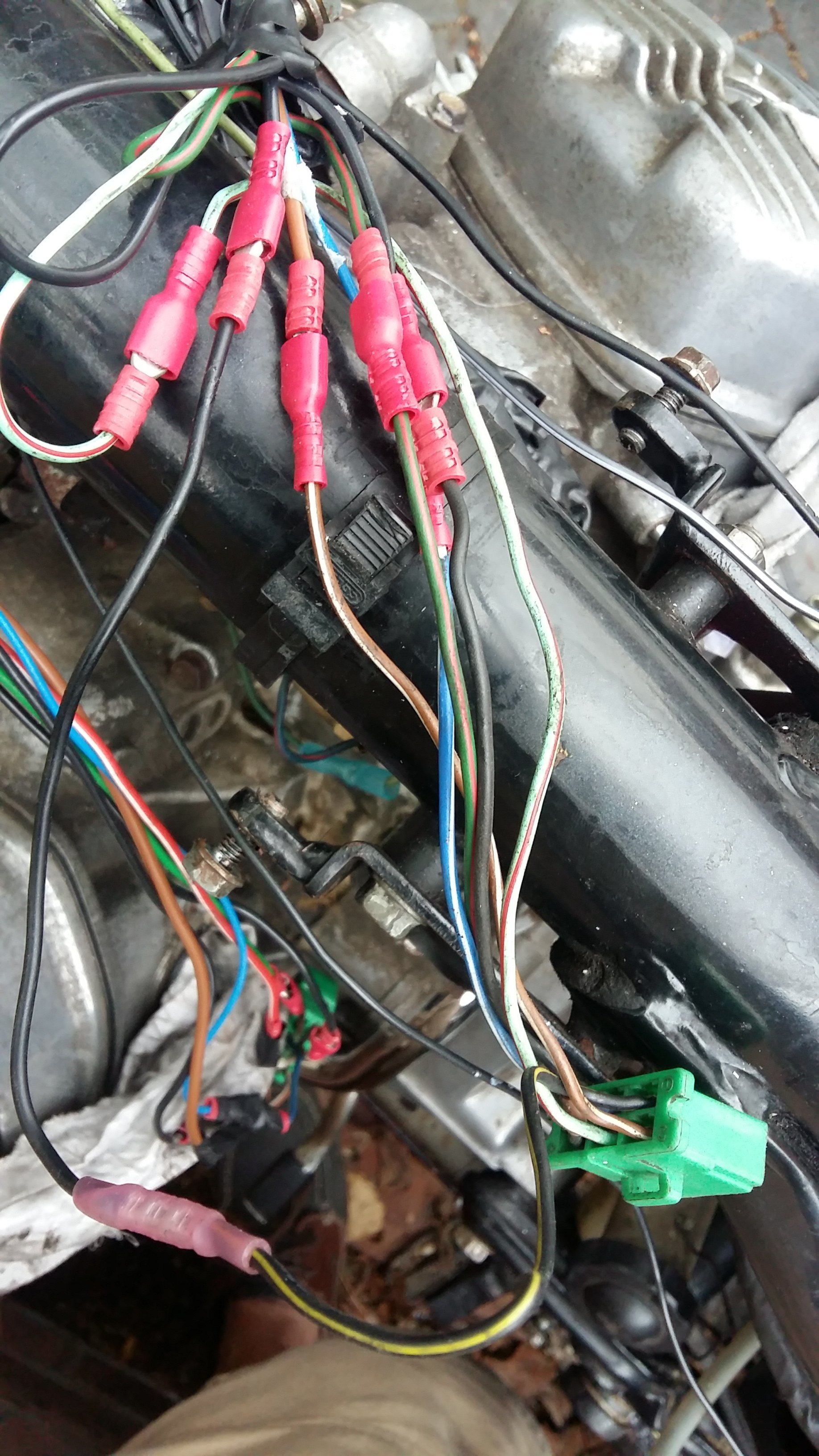

    Some of the previous owners wiring skills on display!

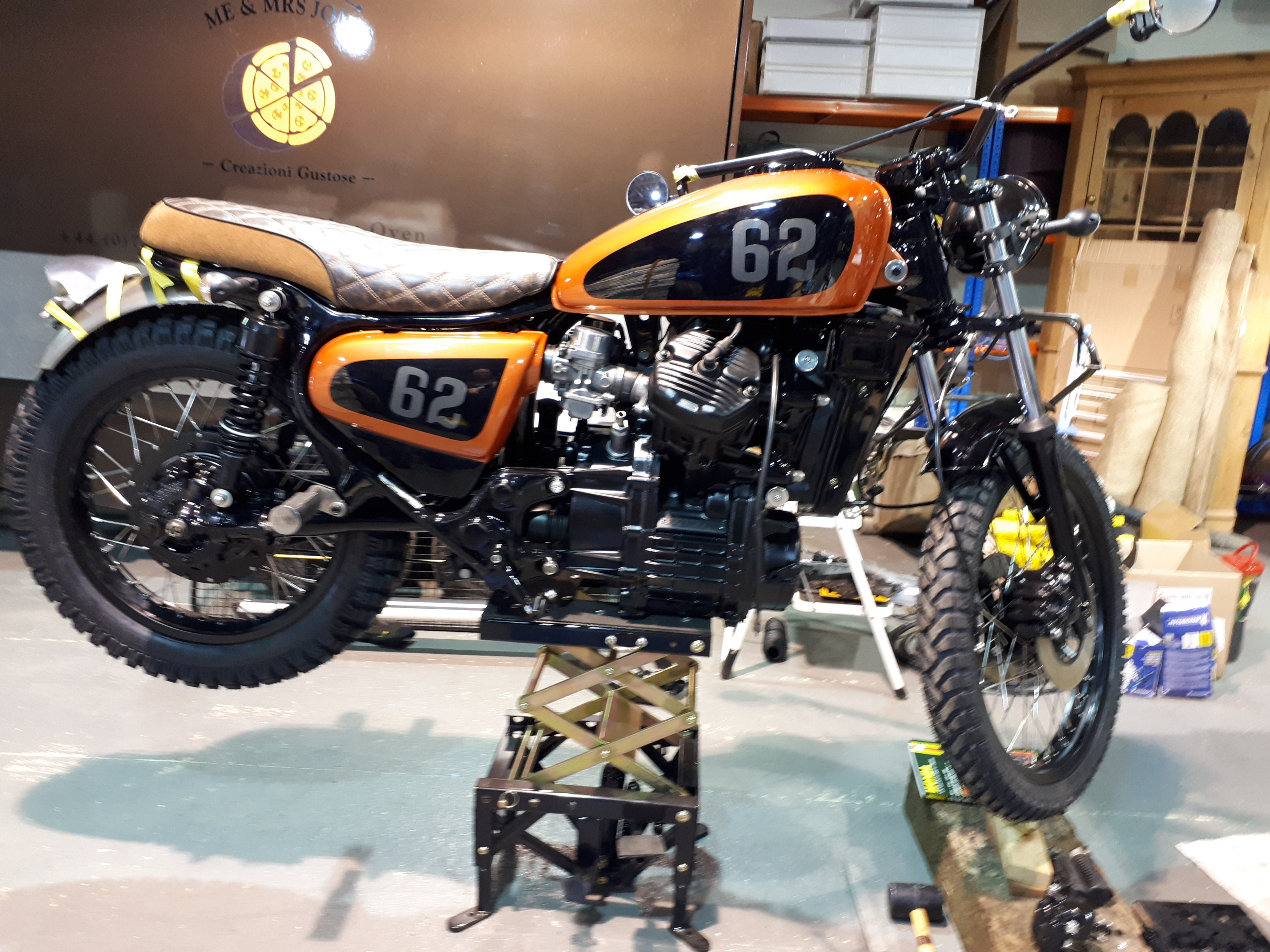

    As of Friday.

    Number 62 looks VERY smart !!!
  7. steve lovatt
    9,212
    I think that's down to the spoked wheels - but they cost a fortune to do which is why I didn't bother!

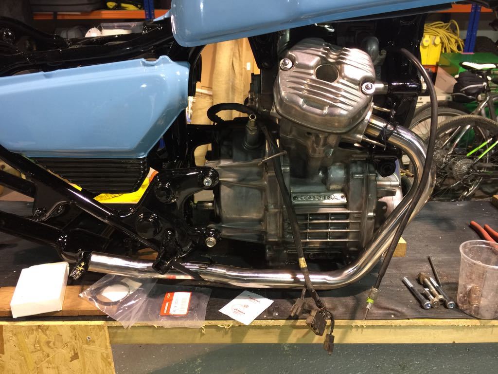

    9,212
    The original bikes had twin pipes linked under the engine by a large "H" box thingy - very heavy and no longer available new even if you wanted one. Both our bikes had Motard 2 into 1 pipes fitted but mine had rotted out and been welded badly so ended up in the bin. You can still get the down-pipes but they end up a little short without the "H" box to link them to the silencers.
    Luckily one of us can fabricate (I'll give you a clue - it's not me!).

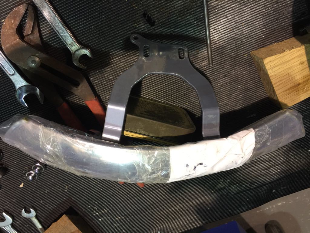

    He's also made the bracket for the front mudguards we bought at Kempton. IMG-20180409-WA0006.jpg

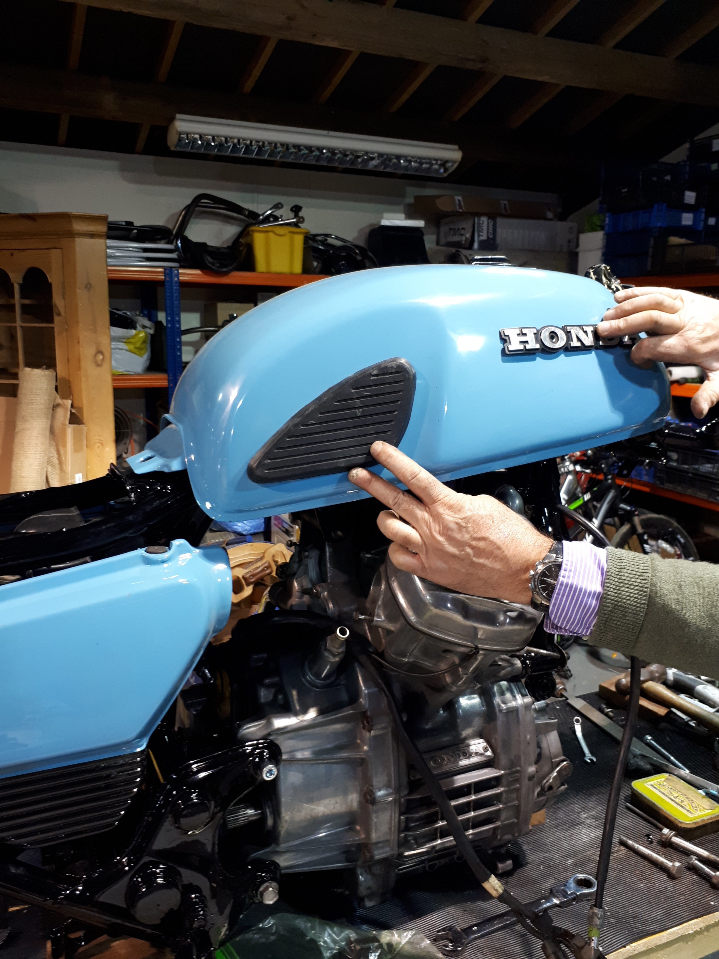

    Just ordered these from Classic bike shop - I think Dilligaf would approve! :D:D

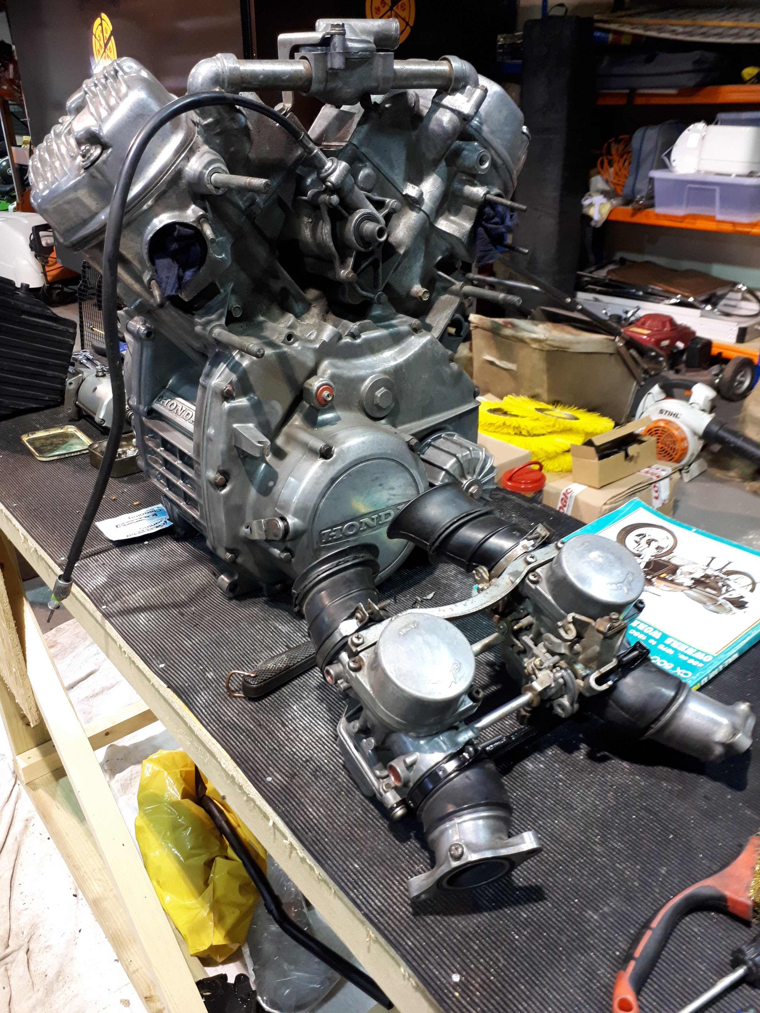

    I love them CX's, only thing I would be about concerned about the amount of them I've seen with slipped big end shells, and the water pump leaks dripping down onto the alternator, apart from that they were nigh on bullet proof!
  18. Tiglet
    Steve the large “H” box thingy as you call it is the exhaust collector box, pattern ones are still available.
    Keep up the good work btw.
  19. steve lovatt
    9,212
    The mechanical water pump seal has been replaced - still a pig of a job even with the engine out!

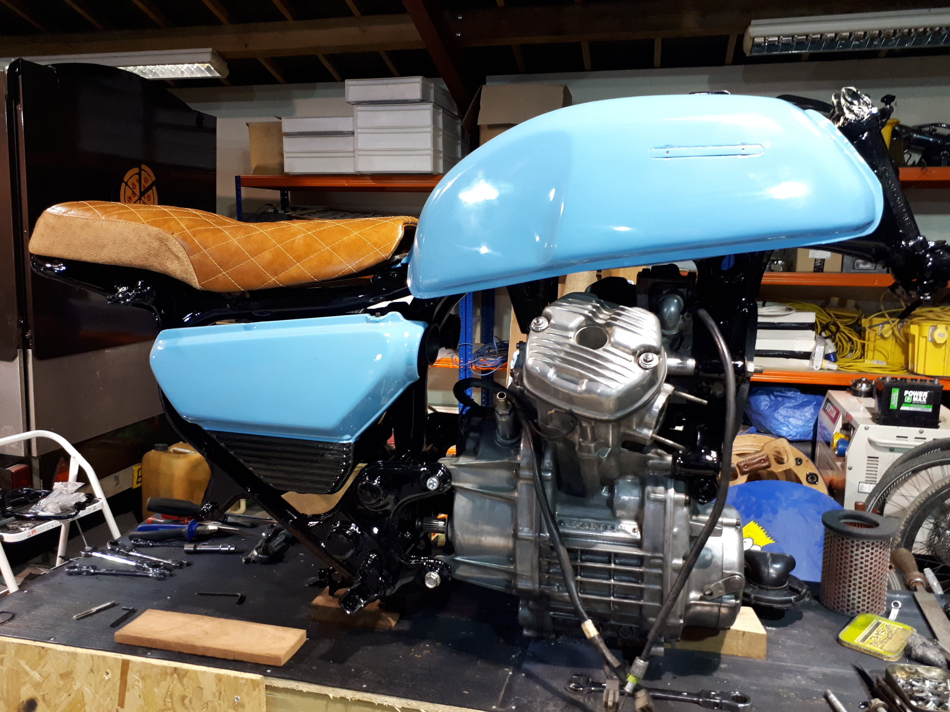

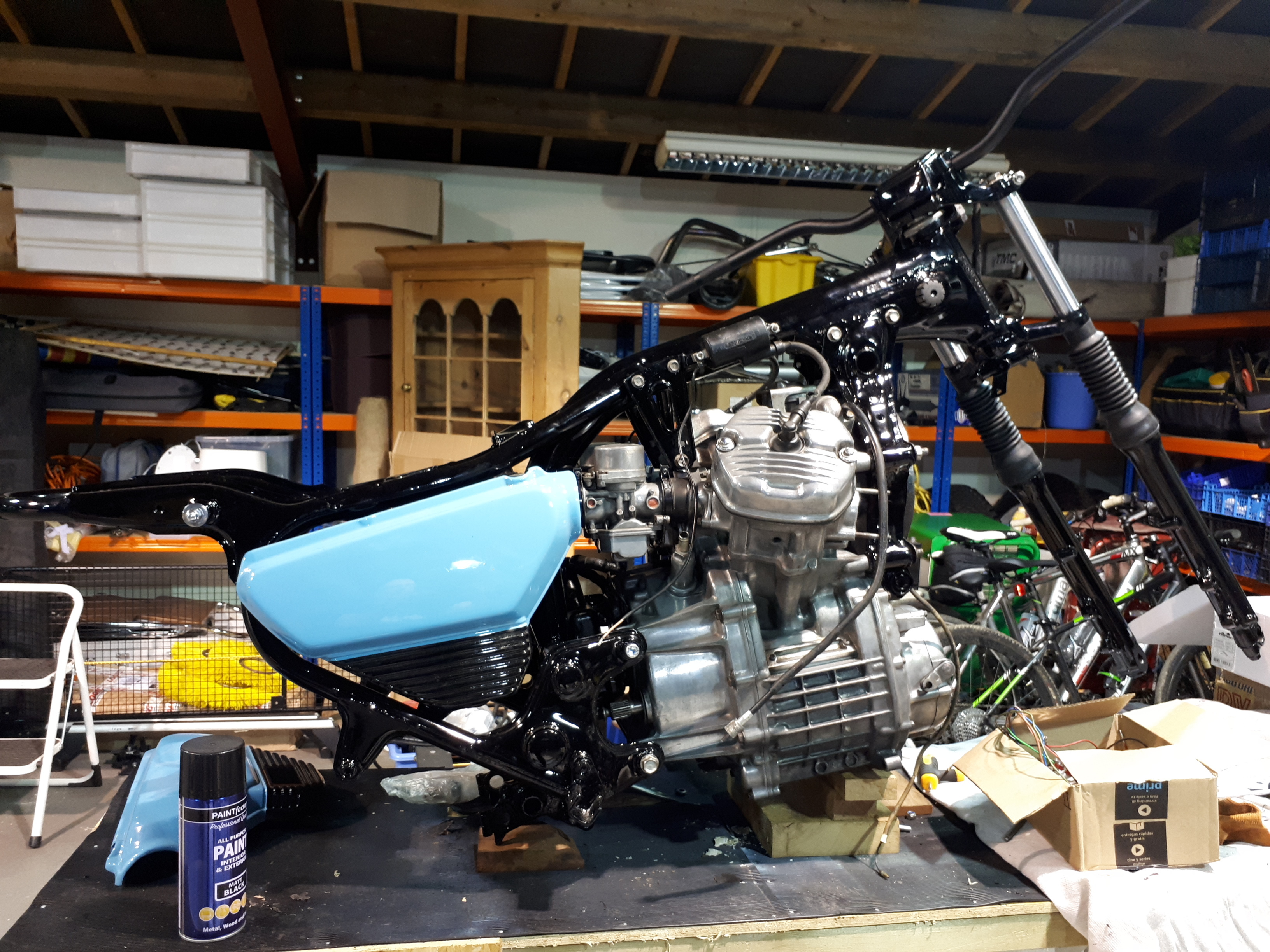

    Bit more work last night.
    Carbs, forks and bars on.
