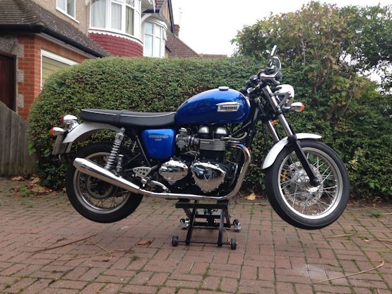

    This is mine, works great til you take the front wheel off and remember you should have tied it down to compensate for it!:tired_face:

    Yes a very important point @crispey , I don't actually use mine @Fork Lock to lift both wheels off the floor at the same time if intending stripping wheels out etc.
    Imbalance due to changing weight distribution is a real risk if you do intend using it as in crispeys picture unless you're just intending doing cleaning for example.

    I got the VEVOR lift a few days ago, but I was sick for the past three days with a nasty head cold - miserable. Feeling better today, so I tried the lift. It's great for my intended purpose. It comes with no assembly required. It appeared sturdy, well made. I only need to lift the rear tire a bit to do chain maintenance or adjusting, so I positioned it toward the rear, I noted that the oil filter protrudes just a hair under the Speedmaster, so I made sure the lift was positioned behind it. Just a few cranks and the rear tire was 1/2 inch off the ground. That's all I need. I worried I would have to pull the bike upright off the kick stand as I raised the lift- I didn't. It righted itself. I was concerned I might need to strap the bike down somehow (I had a plan for that) to make sure it wouldn't topple off the lift - it won't. It's very steady on the lift. I tried rocking it side to side. I'm sure you could knock it off if you really tried, but it was very steady. All in all, I'm happy with the purchase and I think it will suit my needs. The only con, and it's not a big deal, is that I think I would prefer what is in Crispey's photo, above. That is, with two bars under the bike instead of a flat platform. There would be more options with positioning in that there would be less chance of pinching or crushing something on the underside of the bike.
