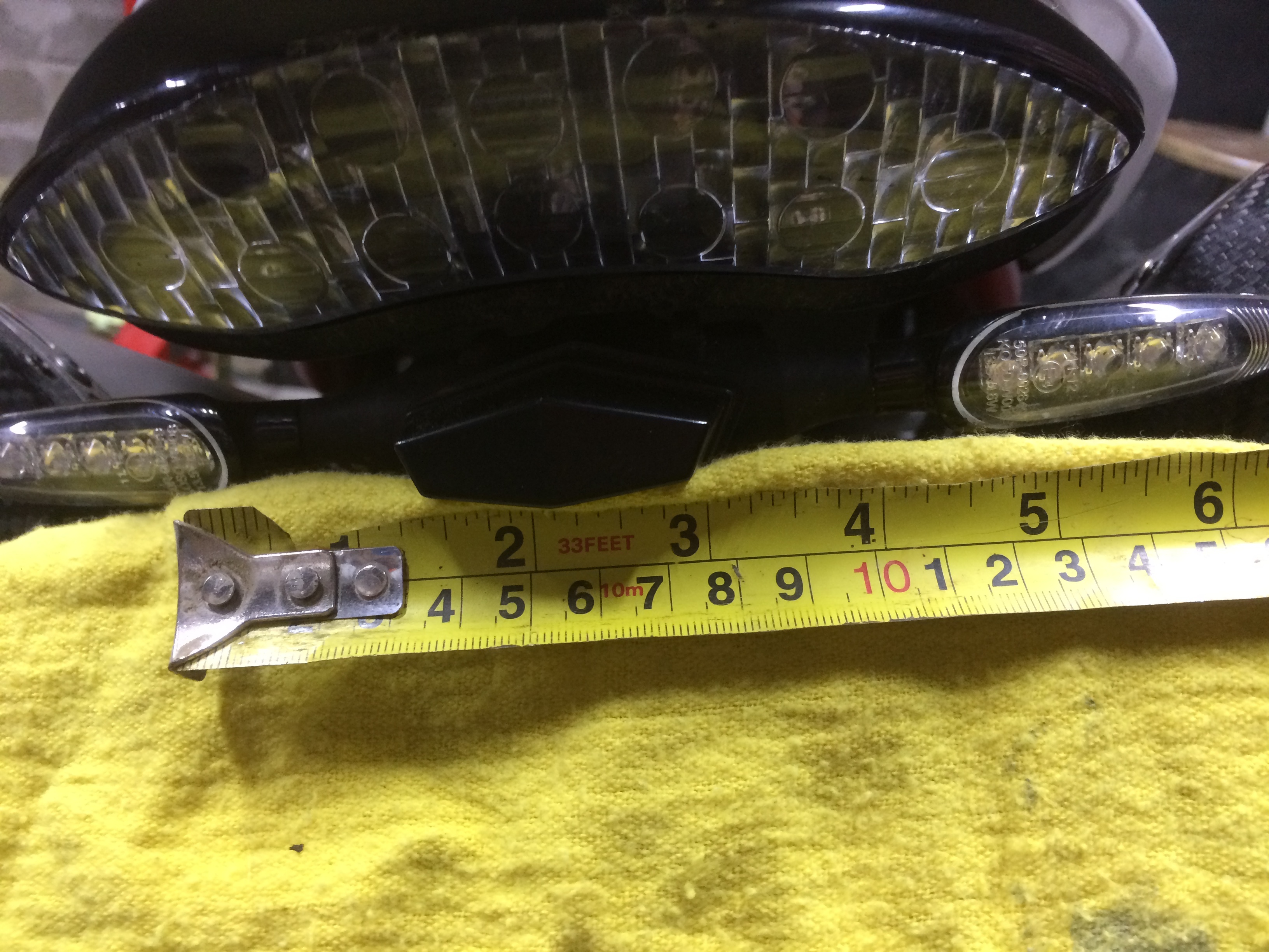

    image.jpeg Just a quick bit of info, for those about to get an MOT.
    Got my speed triple mot today, and the mot tester almost didn't pass the bike.
    Because the rear indicators could have been to close together, new legislation (EU again) stipulates
    "Mandatory direction indicators must have minimum separation distances between the illuminating surfaces of: solo motorcycles – 240mm at the front and 180mm at the rear"
    So as you can see by the pic, with my indicators fitted to my Evotec tail tidy the gap is about 120mm
    But reading a bit more into the mot 'guide lines' you have this.
    "There is no requirement to measure the separation distance and they should only be rejected if the separation distance is obviously incorrect."
    So they have gone to the trouble (and cost) of give detail legislation, but you can just have a visual inspection. So your bike will or won't pass, depending on how good your tester is at guessing what 180mm looks like lol.
    4.4.3 Compliance with requirements
    You must inspect all direction indicators fitted.
    Direction indicators must emit an amber light, except motorcycles first used before 1 September 1965 can have white front indicators and red rear indicators.
    Switch on the direction indicators and operate all the other lamps in turn to see if the direction indicators are adversely affected.
    Some motorcycles have direction indicators combined with the position lamps. In these cases the position lamp doesn’t have to switch off when the relevant direction indicator is switched on.
    The precise position of direction indicators aren’t part of this inspection, but they must be on each side of the longitudinal axis of a solo machine. If a side car is attached, the indicators must be on opposite sides of the combination.
    • solo motorcycles – 240mm at the front and 180mm at the rear
    • motorcycle combinations – 400mm at both front and rear

    yours are the same as mine it passed in march
    my harley has the three in one ie tail brake and indcator lights are the one unit might be interesting to see if it can pass
    my advice would be a more motor bike friendly mot man

    Mine are 230mm at the rear with an Evotech tail tidy but with standard indicators and stems

    My MOT man said the rear light/indicator unit on mt MT01 was now illegal (unless it was built from Yamaha that way) but passed it anyway so it's just a load of bollocks from the EU
