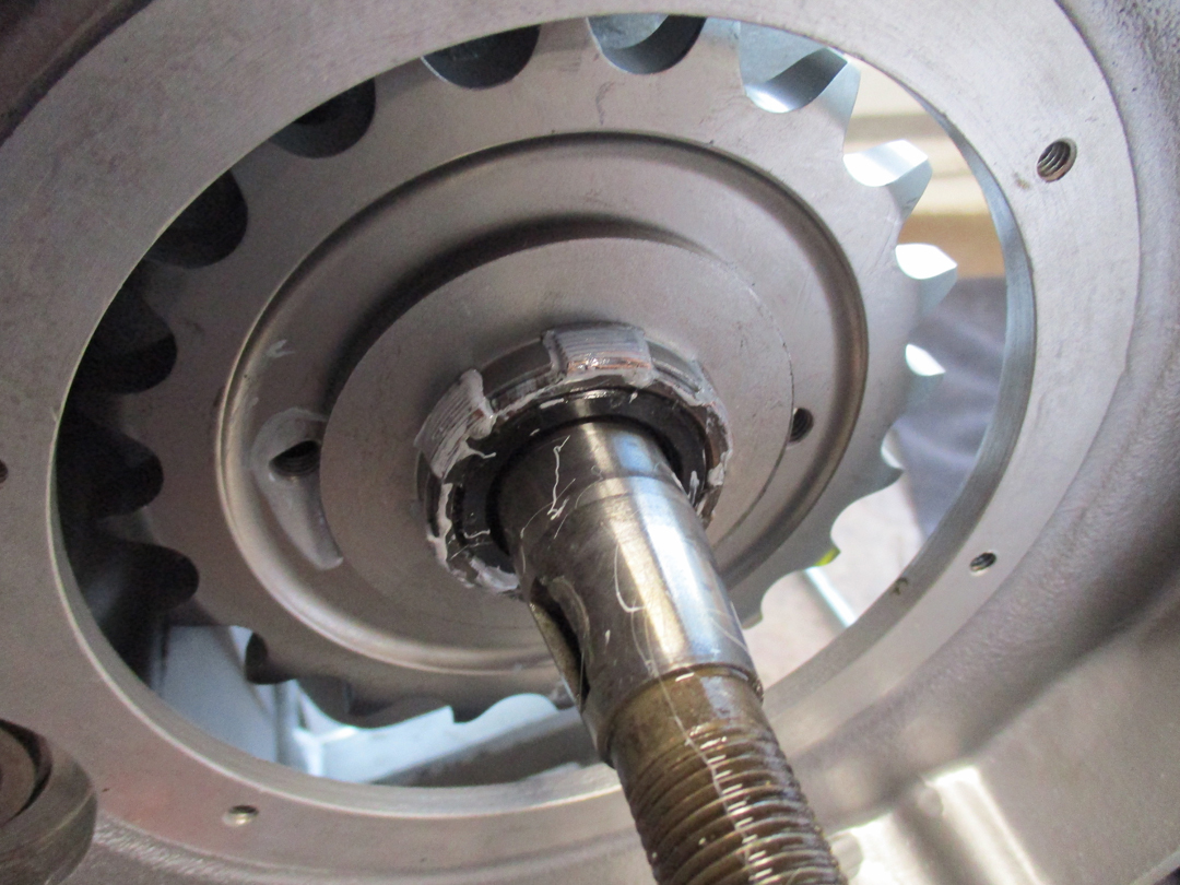

    Hi Iron, I have now stripped the primary chaincase side down, it was a bit tricky as someone had tightened the clutch and crankshaft nuts up so tight and also the projecting "boss" on the engine had, for some reason had the inner chaincase "burred" over it for part and the inner chaincase would just not waggle off. In the end I had to carefully chisel the excess aluminium away to get it off. There is noticeable play on the gearbox shaft although it is not excessive, you can see oil from between the bush and the shaft but I think that the main play is at the gearbox. I will take the sprocket off as long as I can get the big nut off, the handbook does not say anything about this nut being LH thread so I am assuming that it is a normal RH threaded nut. Cheers, Ken

    Yep, normal RH thread (Harleys are odd like that and catch us Triumph guys out sometimes :rolleyes:). When you come to rebuild get some threebond or similar onto the splines when doing the nut up as oil can make it's way through there.
    This is a T140 unit but very similar, I've piled it on before fitting the tab washer

    I eventually managed to get the gearbox sprocket off by making up a special/adapted spanner at attached picture, the spanner is a ring spanner and fitted nicely all round the sprocket nut and the spanner is stopped from coming off by a spacer, the clutch centre and its nut but boy was the sprocket nut on tight, not sure whether this should be so tight, the chap who put this together did use Three Bond or similar on the splines onto which the sprocket fits, and almost everywhere else. There is slight play between the bush and the mainshaft and the main shaft and the bearing so I think that I will have to go the whole hog and now strip the whole gearbox. Thanks again, I will let you know how it goes. Cheers, Ken
