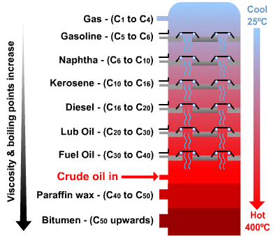

    Not so much bad as the more volatile elements (which ignite most readily) evaporate off leaving varnish residues that fresh fuel will fairly quickly dissolve. We tend to forget petrol/gasoline is itself a mix of the top end compounds in crude oil.

    The cracking tower always makes me giggle.
    Remember when diesel was cheaper than petrol? Yet it has several less refining processes to go through!
