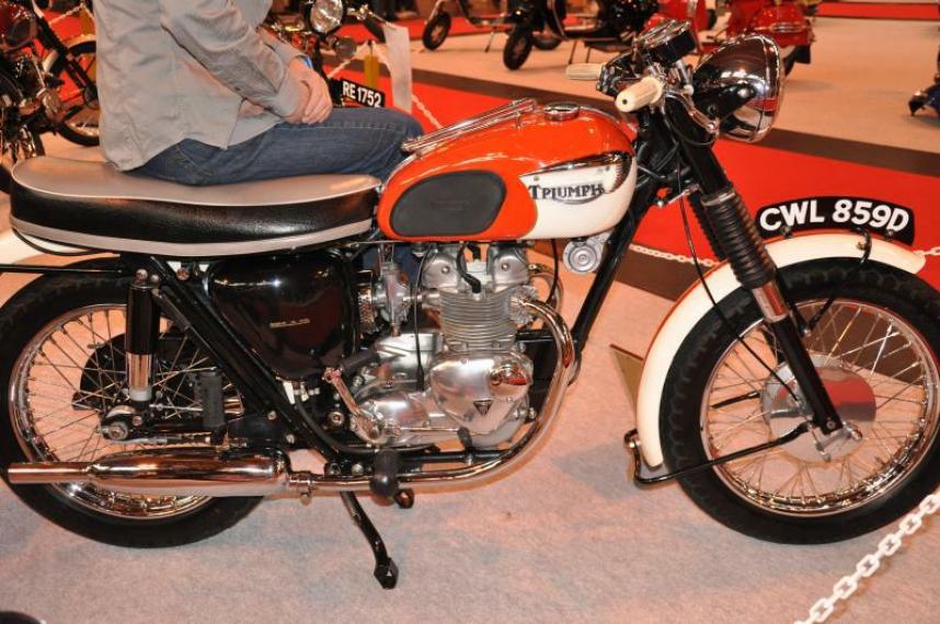

    |looks like it'll be about half way down. It's a Tiger 90, I know, but they're fundamentally the same.
    Or a third of the way down, perhaps?
    @darkman will know!

    Middle and middle just like the red n white one above is about correct, all of my bikes are a little different just as they were from new :)

    Thanks chaps middle it is, regards Chris
