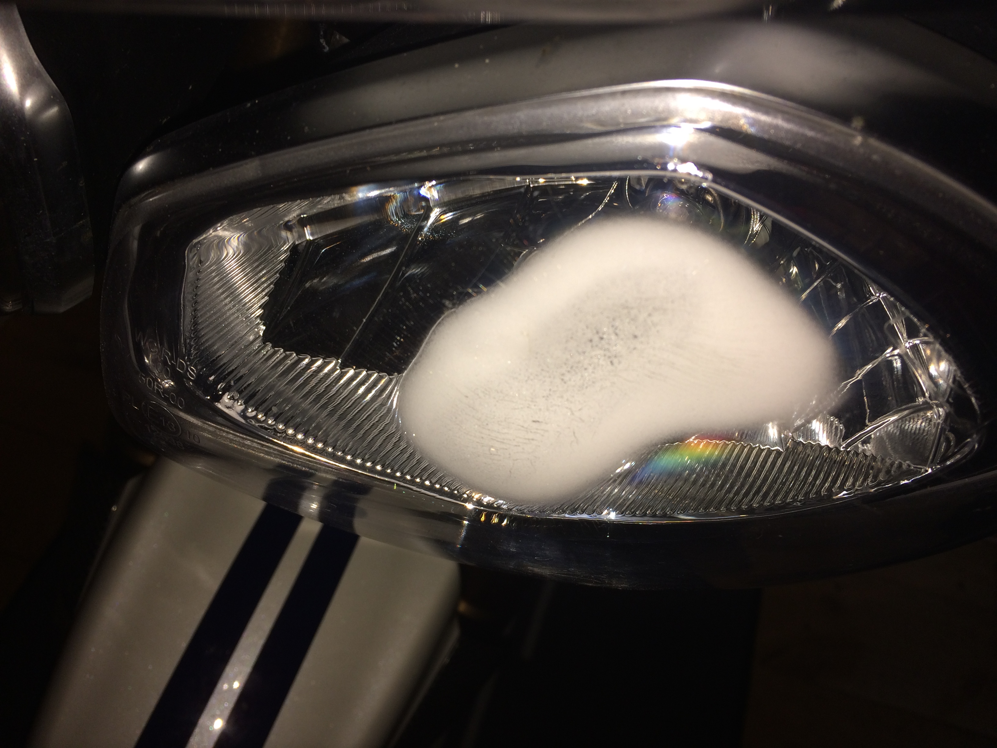

    Hi I'm new to this forum but i would like to know if anyone else have had issues with their headlights melting when using headlight protectors. I have spoken to Triumph but they say there is not an issue with the headlights.
    have a look at the pictures what do you people thihk

    Is it a Triumph supplied part ( official ) or a third party part?
  3. thebiglad
    5,064
    Has it got std. wattage bulbs or has someone installed higher wattage ones? Higher watts means more heat.

    the bulbs are standard the bike is a 14 plate and only done 7k miles I've had it from new.
    Triumph are adamant there is no issue and they will not help

    The damage looks pretty extreme and if the bulbs are still OE factory fitted I would say you have a valid claim. I would lean on your dealer a bit harder, tell them you're not satisfied, maybe mention that bad press it will get on this forum.

    I'm not getting anywhere with Triumph which is disappointing as I have recommended and converted biker friends to Triumph anyway below is their response
    Dear Mr Jones
    Thank you for your email. The claim Bevans submitted for new headlights was rejected by the factory not only because the bike is out of warranty, but because the issue present is not believe to be a manufacturing fault and a different issue to those we have replaced in the past under warranty or recall.
    We have reviewed the latest pictures you have sent and the decision from the Factory Warranty team remains the same on this one.
    The damage to these headlights is very severe which does indicate that this has been caused by outside influences. The only way that we could replicate this type of damage in testing was by either the use of aftermarket bulbs or covering the light. Even repeated tests at ambient temperatures far exceeding the design spec of the lights does not produce the type of damage seen in these photos.
    The fact that both lights show the same damage reinforces this as the 2 lights are manufactured separately before being assembled into the unit. Therefore, a manufacturing error is unlikely.
    So unfortunately we will not be able to offer you any support on these.
    I hope this decision doesn't take away from your future enjoyment of Triumph and your Speed Triple which really is a fantastic bike to ride.
    Kind Regards
    Triumph UK

    Did your h/l protectors leave a gap between them and h/l? Mine on tiger had a gap as it's velcroed on. Been there for 3 years
  9. Ioan jones
    Ioan jones New Member
    Nov 1, 2016
    Swansea
    Yes there are spacers but every time I took the covers off if I was behind someone they would complain my lights were too bright. They had not melted until my last run which was about 180 miles

    Hi Ioan
    I'm also in Swansea and also have a 2014 SPD3 from Bevans from new.
    My own lights were so poor I swapped em for cibies so I'm surprised you've been dazzling anyone? Sure the bulbs are std 55w/60w?
    Also are you saying they've been alright for 2 years then melted suddenly one day on a 180 mile run?
    That sounds unusual.
    Any chance the dip switch is faulty and main and dip are both on at once??
    Taff

    Taff beat me to it and is probably right, I also suspect you've had both filaments of the bulbs on at the same time, you've probably got a switch or wiring fault.
    The facts:-
    1. you've had the bike from new and not changed the bulbs
    2. if both filaments are on at the same time you get twice the heat which could cause this problem
    3. you're comment about others saying they're too bright (standard they're nothing special)
    4. not likely to have two bulbs with the same fault
    5. could be a repeatable or intermittent fault in switch or wiring
    6. I would expect your dealer to have checked for this fault when they inspected the headlights, did they?
    7. If Triumph were doing their job properly they should have instructed the dealer to run the above check
    So....check yourself whether both filaments are on either in dip or main beam position, also see if by fiddling with the switch maybe halfway between the two you can get the fault. You may have ridden with an intermittent fault (or switch position) on that 180ml run. I suspect the fault to be recent (or the lenses would have melted earlier), was the "too bright" lights comment quite recent?
    If the above fault is in fact the case then you would have a valid claim against Triumph if still under warranty, as you are no longer (but I assume not by much) I would push for a good will gesture from Triumph (often free parts but must pay labour). If the fault is there for all to see (ie not intermittent) then you should take it back to Bevans and encourage them to feel suitably embarrassed for not spotting it. ;)
    I suspect Triumph/Bevans are assuming you're an unscrupulous owner that has had non standard bulbs in there and swapped them back out for a claim. Obviously if the suspected wiring/switch fault is apparent they should be rectifying it not washing their hands of the issue.
    The only other (less likely) possibility I can think of is a regulator fault, this would make the lights burn brighter, but I would expect you to have suffered other problems as well if that were the case.

    Generally the lenses are made from polycarbonate which has a melt temperature of roughly 150 deg. C
    So it has taken some serious heat to cause that damage.
    It would be interesting to know what heat the bulbs are generating within their confined space when the bike is standing, on the move it should cool the lenses.
    If you have access to a pyrometer check the temps. of the lenses
    As the other guys have said, check wiring, wattage etc.
    Definitely not good, Triumph should be giving you some better answers/advice.
