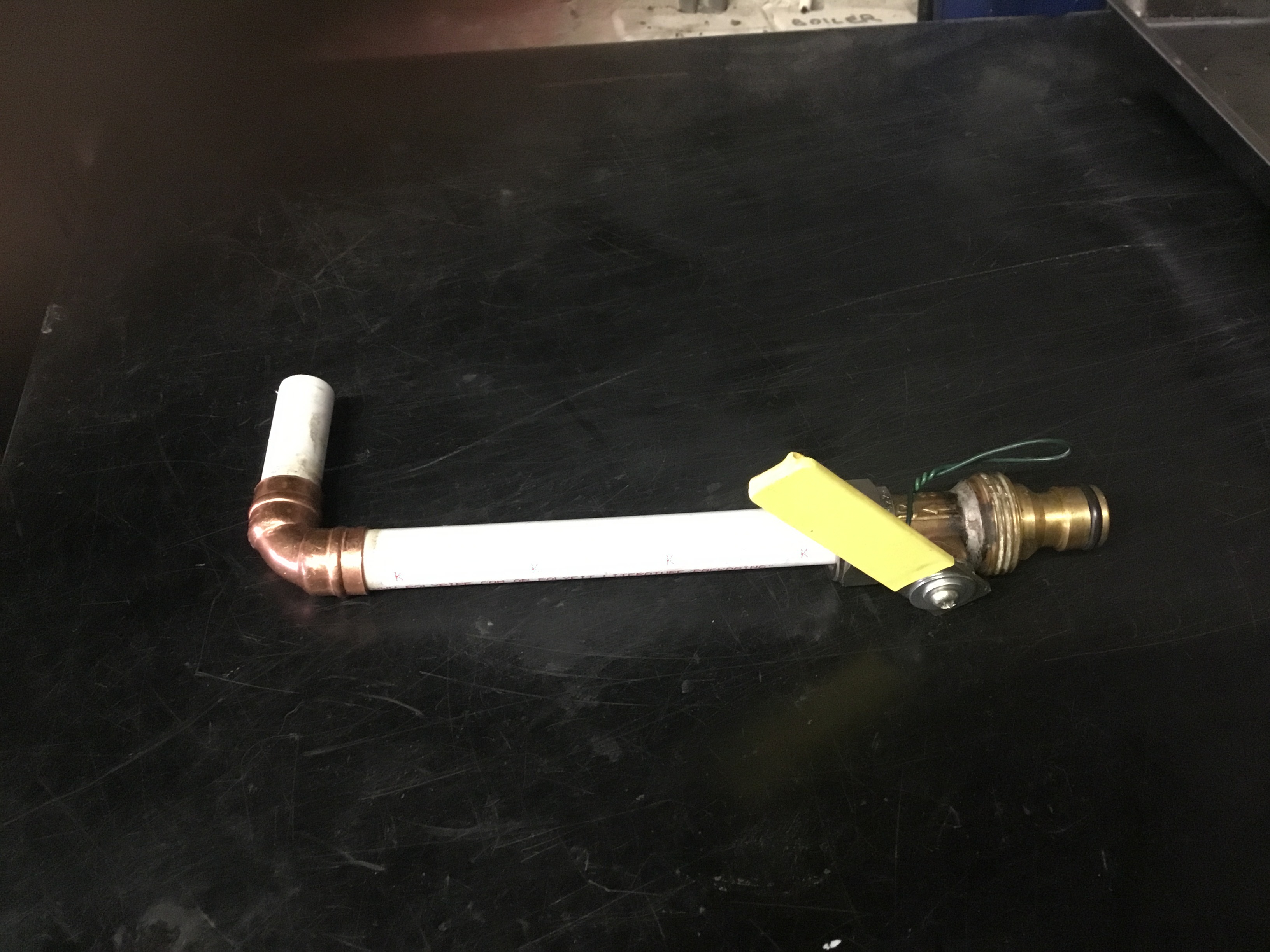

    I've used Halfords OAT coolant in the car and the ZZR for years and will use it in the Triumph when the time comes.
    To make the flushing process easier I made up a simple hose attachment that can be used in the rad filler or clamped to suitably sized hose (heater hose in the car) to flush the whole system through....
