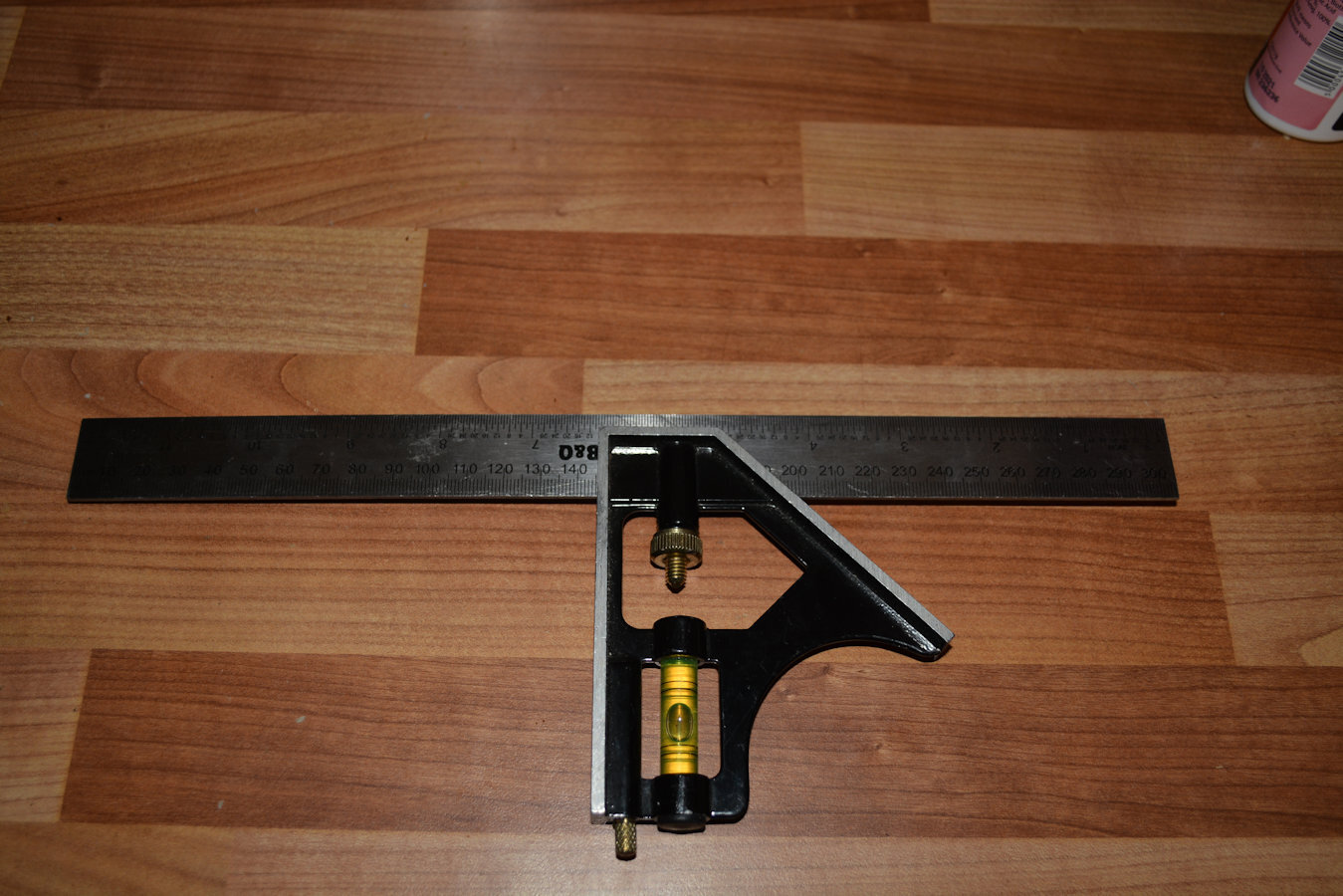

    a simple trick to simplify setting up the sprint's front forks - for normal way up forks with screw in adjusters on top - older sprint owners know what I mean
    when I replace oil OR reset the adjusters to recommended spec I used to bugger abound with rulers or tape measures and it was a right sod of a job
    I discovered an easier way and its blindingly obvious (eventually) set sq.JPG
    get one of these adjustable set squares - set it to the depth you want (145 mm).. insert into compressed fork stanchion with spring out - so it is sitting flush on the top and fill with oil until it just touches the ruler using a torch to illuminate (a head torch is great for this)....and of course the big advantage over a ruler is it can't accidentally drop down inside the tube
    to set the fork adjusters back to standard (10mm) set the square to 1cm, place across the top of the adjuster and measure down... adjust and check... etc
    couldn't be simpler really....

    Exactly how I do it with RWU forks mate. :)

    I use a stainless steel straw, pack of 4 for £1, drill hole same size as straw in a 50x50mm piece of clear plastic and set to height with a tie wrap; then put a piece of silicon tube on end of straw and suck the oil out with vacum brake bleeder.
