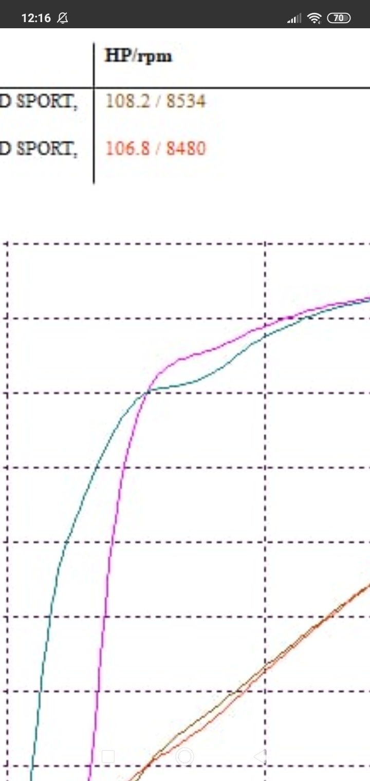

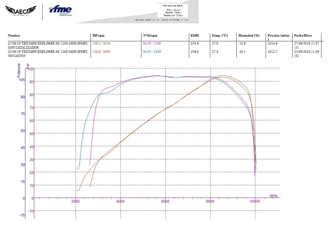

    He says she (the bike) loses low down power in Sport Mode.

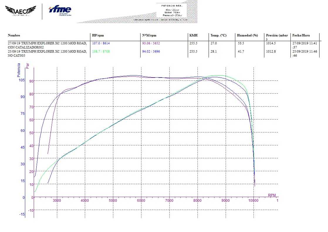

    He had a Dyno run done in Road and Sport mode ... uploading images.

    Am I missing something from those power graphs? They look pretty healthy to me and unless he’s riding the bike at below 3000rpm all the time doesn’t look to have much to complain about, certainly not a lot of difference between cat and no Cat!
    Hilltop will do a postal service on the Ecu but he won’t get any before or after dyno charts and he’ll have to rely on seat of the pants feeling to tell the difference.

    He's referring to the dip in the green line around 4 thou rpm in sport mode... Posting amplified screen shot...

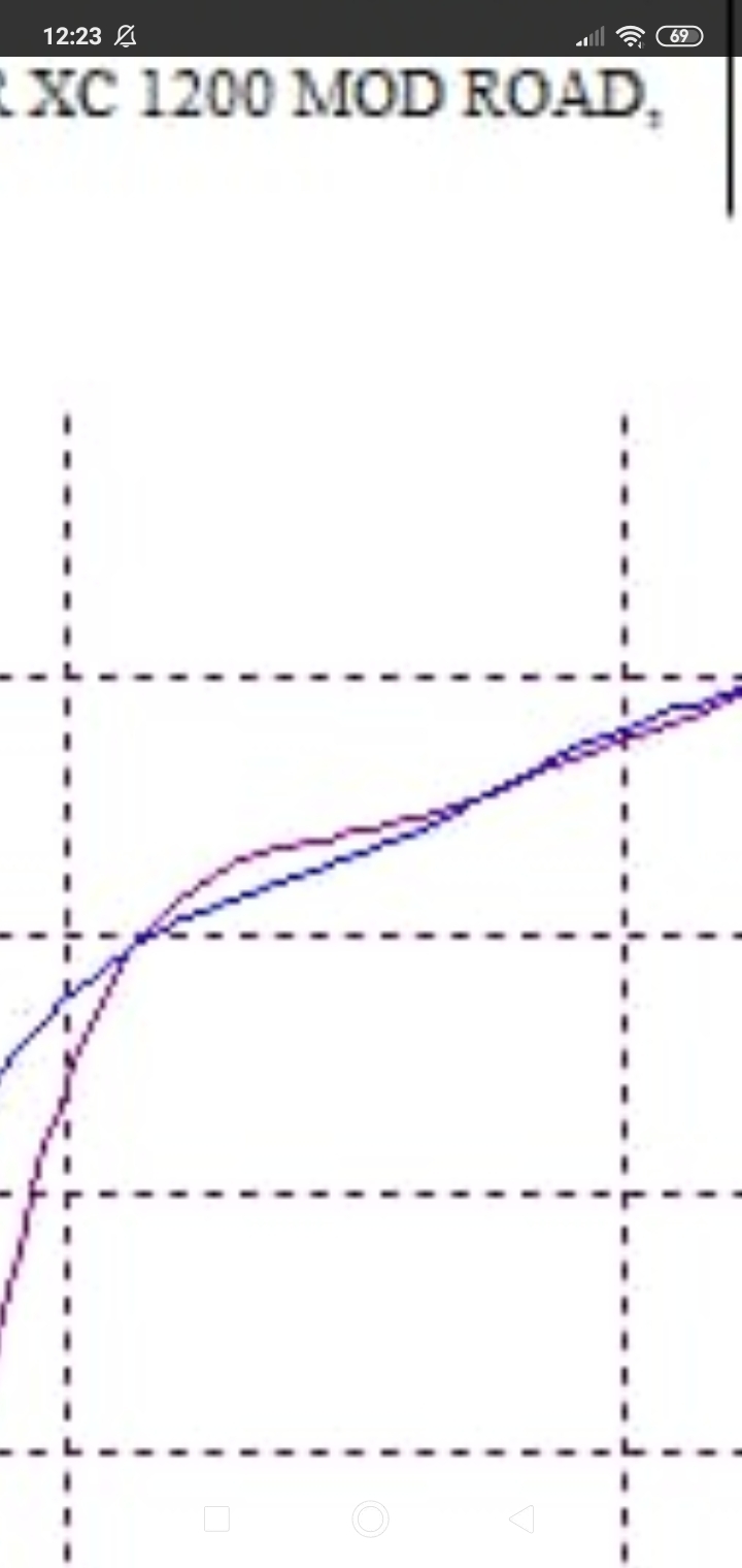

    ...as can be seen here in Road mode, no dip at same RPM

    If the bike is proven (graphs) to perform better in ROAD mode then why not run it in it;
    No?
    He doesnt have to tell anybody he's "wimping" out due to not using it in SPORT mode :joy:
