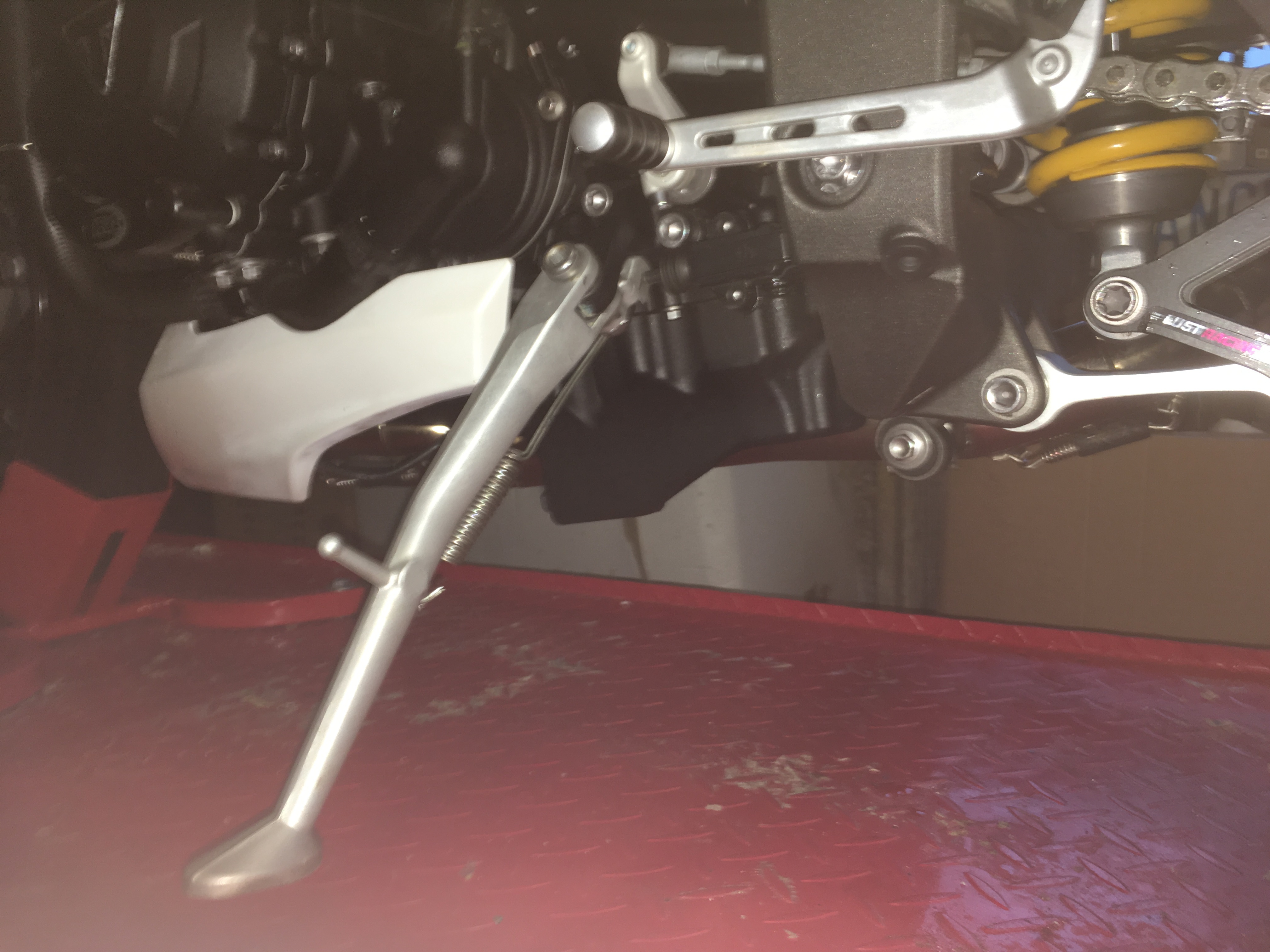

    I have fitted the Lust lowering kit to my 2017, I need to do something about the side stand, I've been through this before as I have owned 4 x Aprilia Tuono's, which had a horrible habit of doing an "Oliver Reed" when you had fitted a lowering kit, my query is what other years side stand fits the 2017 Triple "R"

  3. Yorkshireman
    3,507
    3,400
    I think the answer is to buy a second hand one and have it modified by a good alloy welder cutting an inch or so out in the lower section.
    Edit. There’s one on eBay 113625329335 is the item number but it’s got some damage that could be easily repaired in the modification process.

  4. Lessaint
    Lessaint Noble Member
    Jan 14, 2019
    281
    436
    313
    Sherwood Forest North Notts
    Yorkie, that's my plan, I have had a look at that one113625329335, I didn't know if it would be ok for a 2017 model they must be the same. We are of to Willingham woods today nice ride from North Notts to Market Rasen

  5. mpllineman
    mpllineman First Class Member
    Feb 12, 2018
    1,566
    826
    Pearl,Ms.
    I was wondering if heating the stand with a torch and putting a small bend would work? Just a thought. This could be done on the bike so it eliminates the removal and reinstall parts. Good luck.

  6. Andymarksonline
    Andymarksonline Well-Known Member
    Aug 26, 2018
    136
    238
    I have the same issue after fitting a lust kit to my RS. The stand is coming off tomorrow and going to a fabricator to chop an inch off the bottom and re weld the kick plate back on

  7. Col_C
    Col_C I can't re...Member
    Aug 5, 2015
    1,592
    1,431
    Solved problem on the wifes Street3R that I lowered by fitting stand from a non-R Street3, they're lower than the R version so have a shorter stand. It might be that the same is true of the Speed3?

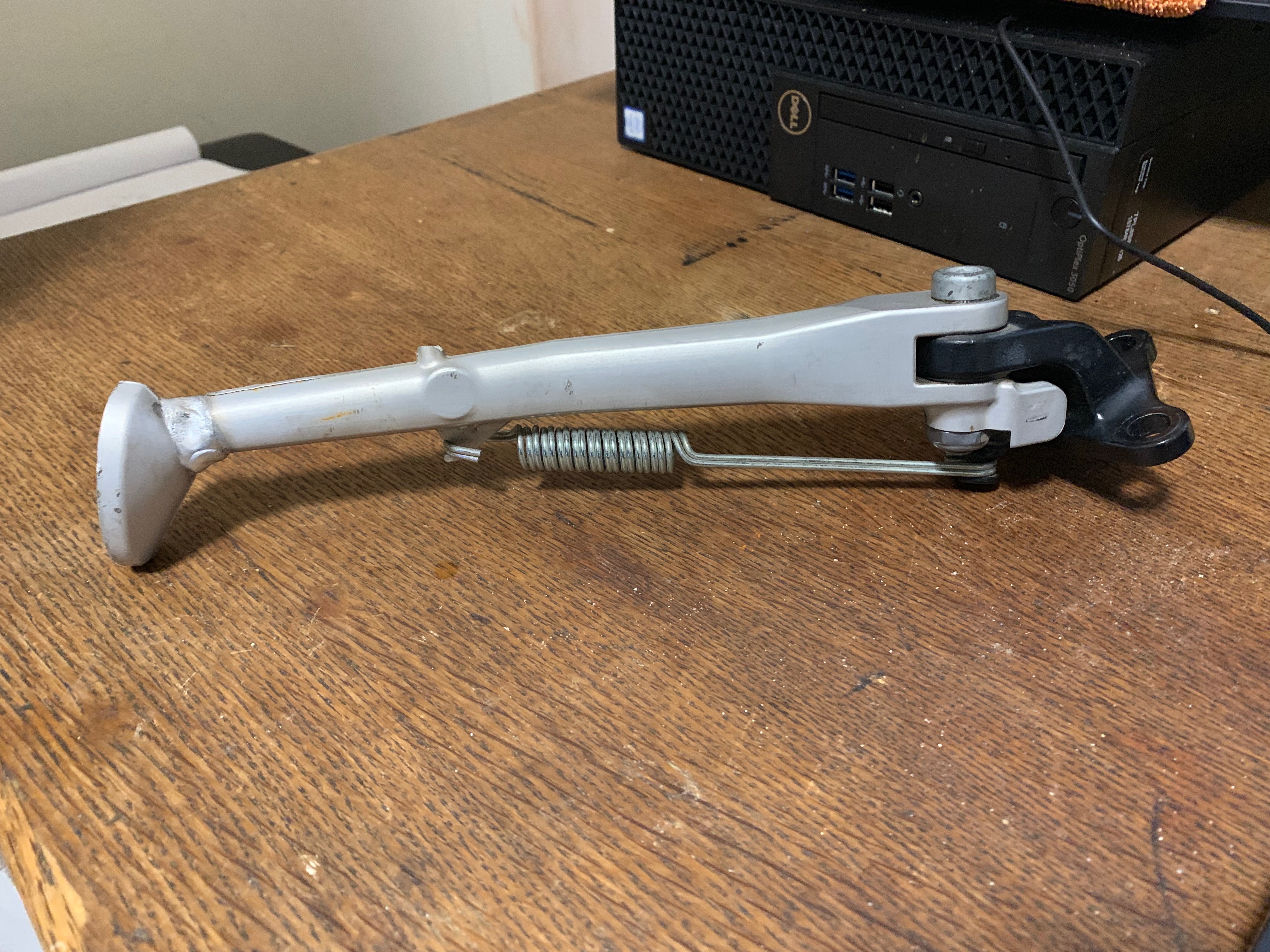

  8. Lessaint
    Jan 14, 2019
    281
    436
    313
    I got a second hand side stand shortened by 1" , just got to clean the weld up and fit it.

  10. crispey
    10,203
    7,248
    Trouble is the lowered bike makes the stand too long and the bike too upright then they tend to roll off! The fleet Tigers are all lowered they have the same problem. Triumph really need to put a slightly shorter stand on too! The lowered bikes are a real pig to get off and on the centre stand too.
