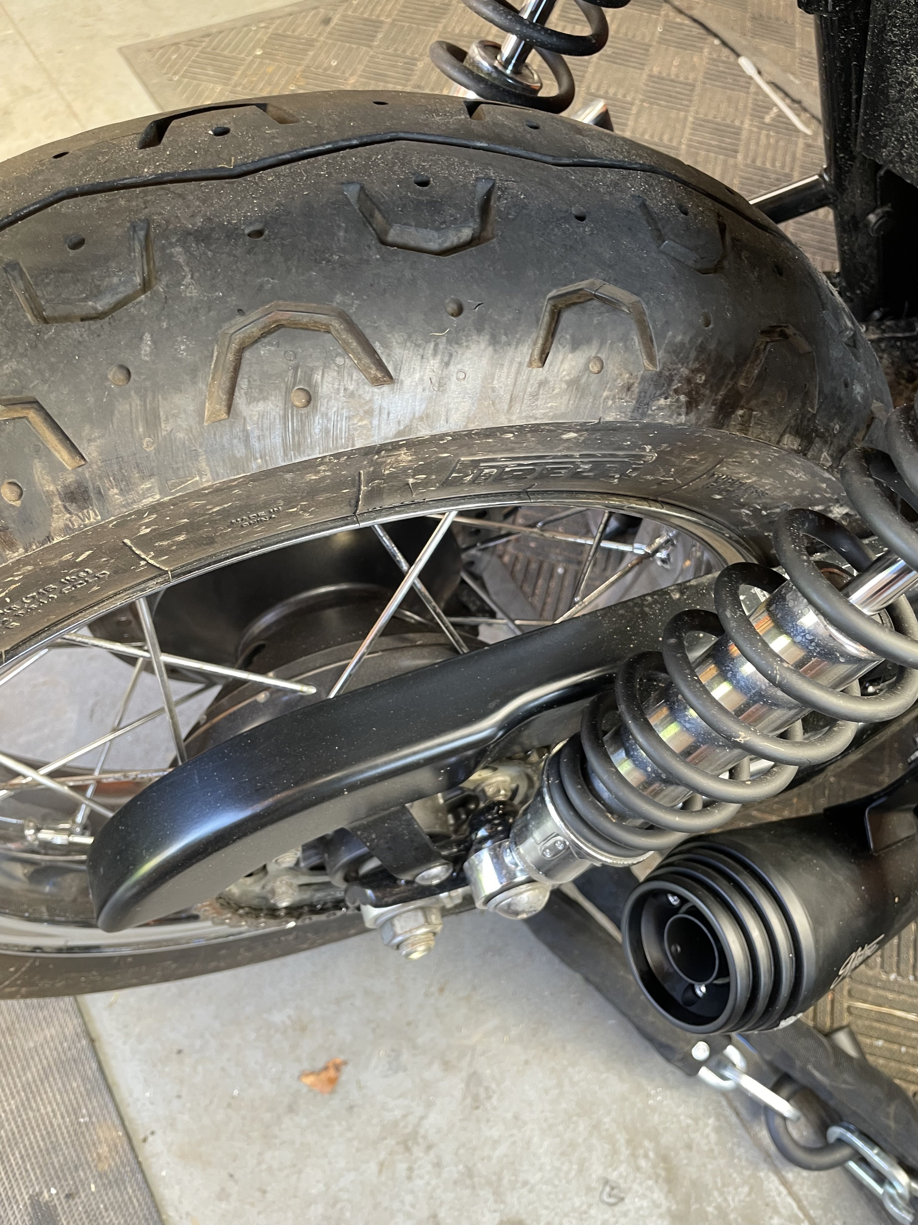

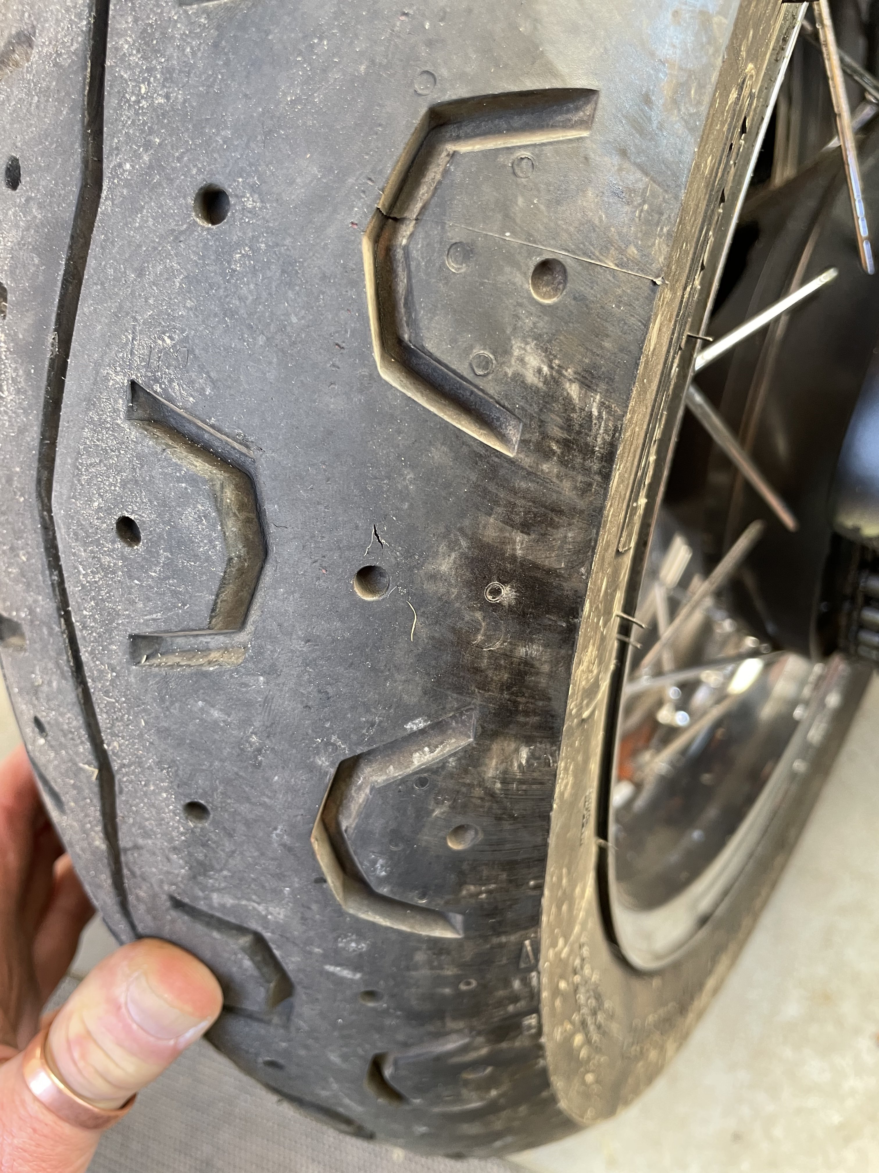

    Thanks all. The roundabout is used for a petrol station and industrial estate so could be diesel but looked fine. The tyremark is on the edge of reason so maybe a bit too spirited but no more than my street triple and yammie xjr from years ago. Fractured rib thankfully nothing more. I’ve attached a few pics. Tyres are original 2016. Seem okay. Nail test difficult as just cut them! But not too much difference to the new BT46 on my sons 125.
  12. Wessa
    11,839
    How many miles has the bike done? The chicken strips look very shiny to me, looking like the bike has not been over very far during it's lifetime. I also agree with @Helmut Visor on the other reason that could have caught you out. Glad you are not to badly hurt.

    I'm with Wessa on the tyres, they look unworn towards the edges. Stored correctly, away from temperature extremes and especially sunlight, the tyres should easily last 5 years IMO, but they do eventually harden and can even crack with age. A crude test is if you can easily leave a mark with a thumbnail in the unworn edges I'd say they're OK. The fall is probably down to something on the road surface or perhaps a small piece of debris of some kind that you didn't see. I had a similar fall on a roundabout a few years back on the dirtbike with knobblies on. The road had been newly resurfaced 3 days previously with nice smooth tarmac and it was damp so that was my bad. Having said all that, if you still have doubt in your mind about the tyres, change them.

    To me it looks like the tyres edge hasn’t even been ‘run in’ and still shiny. Looks like a combination of two, virgin tyre edge and a slippery surface where you rode it. I’ve a vintage bike that’s got a pair of 25year or older tyres that I’m currently riding and it still feels supporting as it’s not had any heat cycles. I know it sounds like I’m taking the piss regarding tyre age but also my old 2013 bonneville had 2001 year tyres on that were new old stock and still passed the fingernail test which I rode ‘spirited’.
