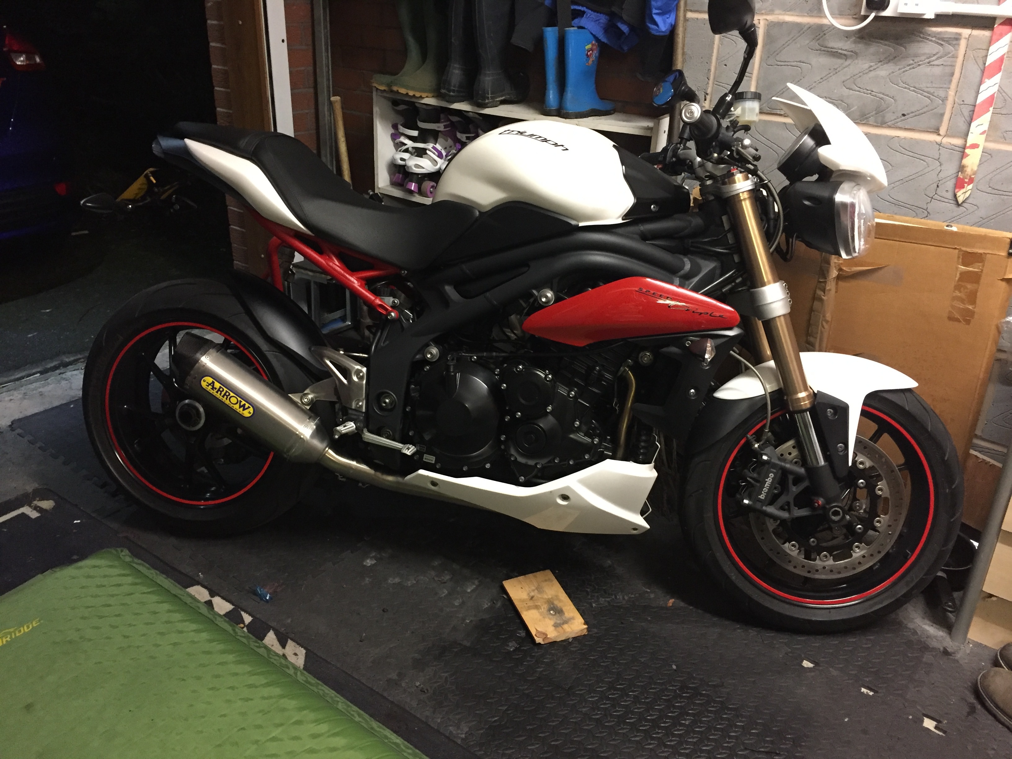

    Lowboy now fitted, I wish I could say it was a pleasure but 6 rusted rounded off header bolts and 2 stripped studs caused a few issues! All forgotten once I started it and heard it sound as it should!

    looks the mutts nutts still not decided about whether to get twin arrows or lowboy,i had twin gpr neros but they were far too loud even with baffles so sold them on fleabay,have you remapped ecu yet should pull nicely when done.
