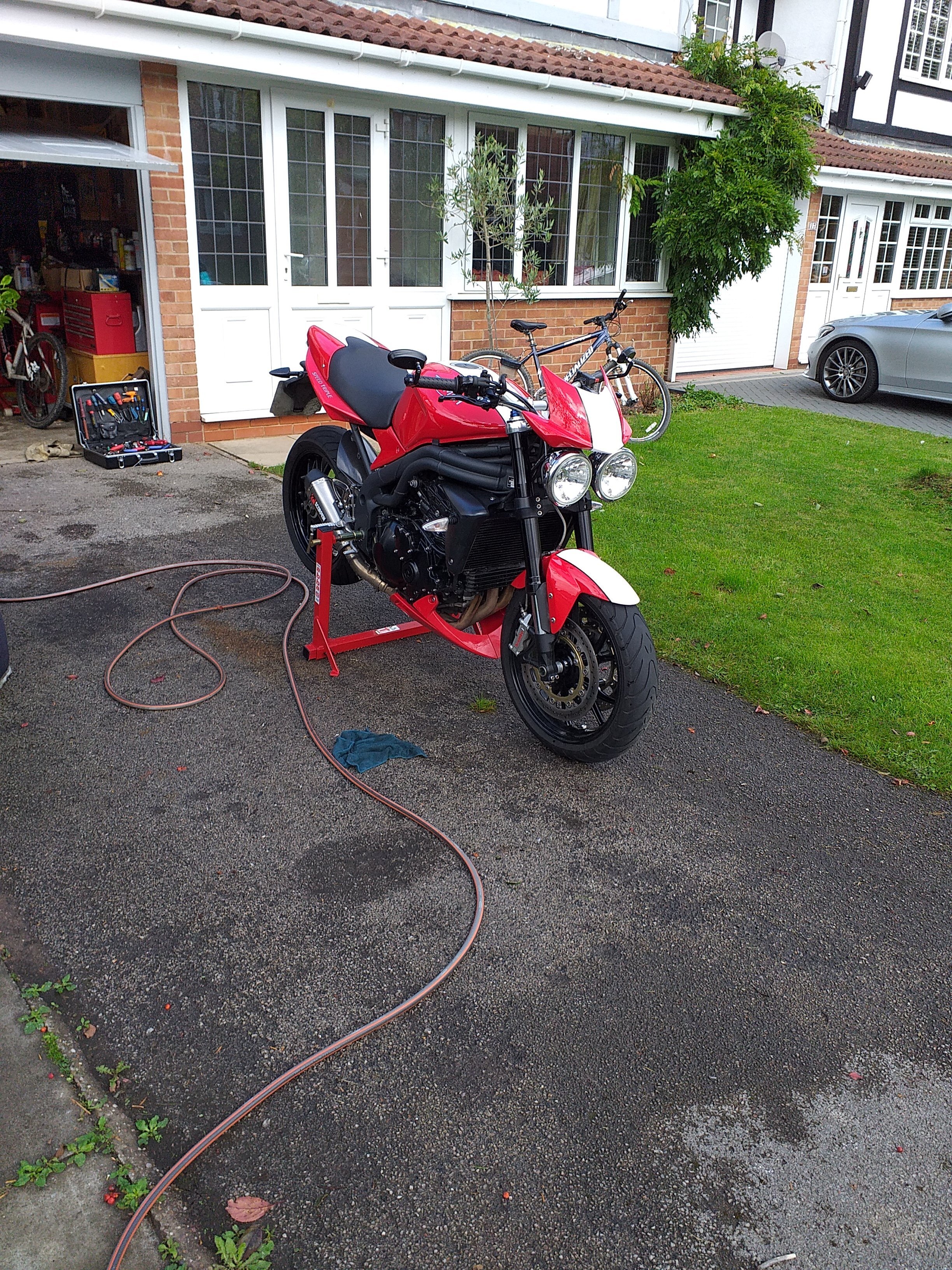

    I fitted a Scorpion lowboy on mine, everything you need is supplied. I thought it looked great, installed the Triumph TORs map and it ran fine. You will likely find an improvement in steering because it weighs several kilos less than the underseat cans and the weight is much lower down :) 20200829_112540.jpg
