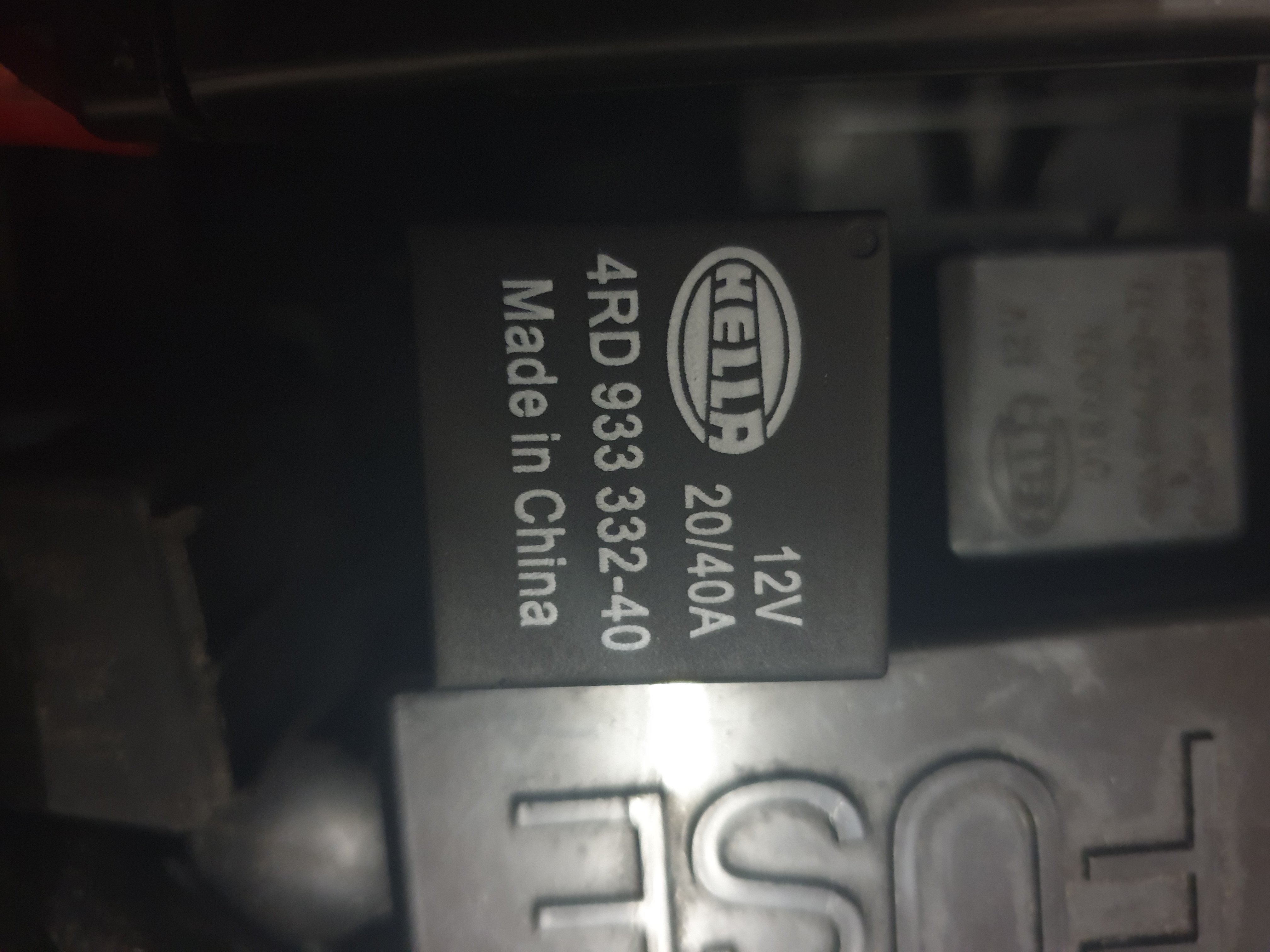

    @Red Thunder problem sorted mate. A new relay did the trick. Disregard the partnumber I previously stated - the stealers gave me the wrong one. It's the Hella one pictured below.

    Is that:
    12v
    20/40A
    4RD 933 332 40
    Edit: Just searched Amazon and found it...cheers again
    #14
  15. Vulpes
    10,268
    19,590
    No problem buddy. Glad to be of help. Better photo below. I paid €14 for it.

    Looking at the Amazon search results and they are different codes
    Searched eBay and local parts trader and none have them
    Will keep looking
    4rd 933 332-040 hella
    #17
  18. Vulpes
    10,268
    19,590
    Strange it won't come up in a search?
