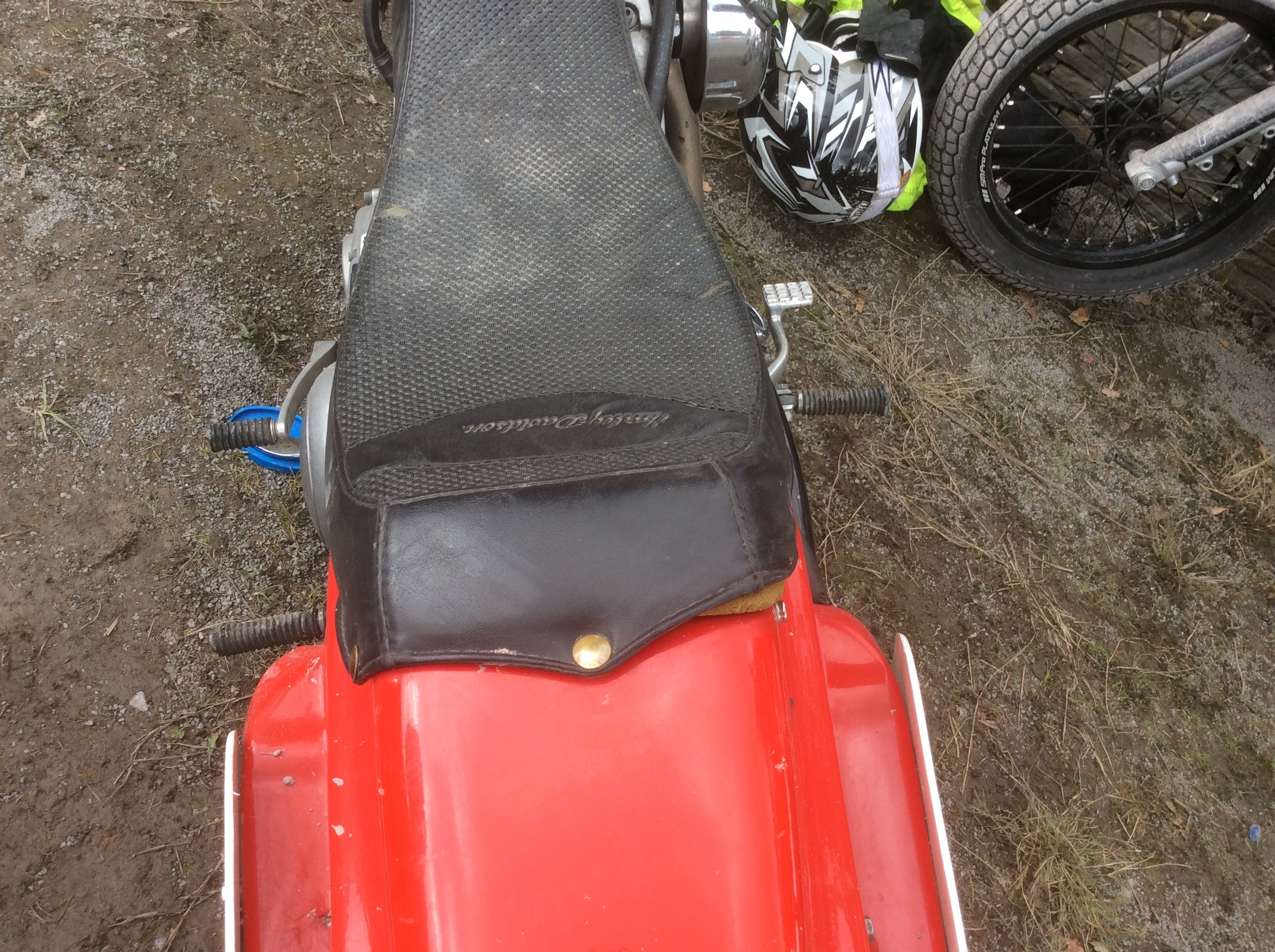

    Does that nice Mr Hyde read this forum? Because you are doing a pretty good job of selling a set of these...
    D6E0885D-9339-4654-AAF0-19EA50D68500.jpeg A64FEFEE-4522-4925-ADBE-4102E9DE9E6B.jpeg
    Seriously, I did my time on sorting out junk from Meriden and Small Heath, back in the 70s. I’m not even going to START down that path again.
