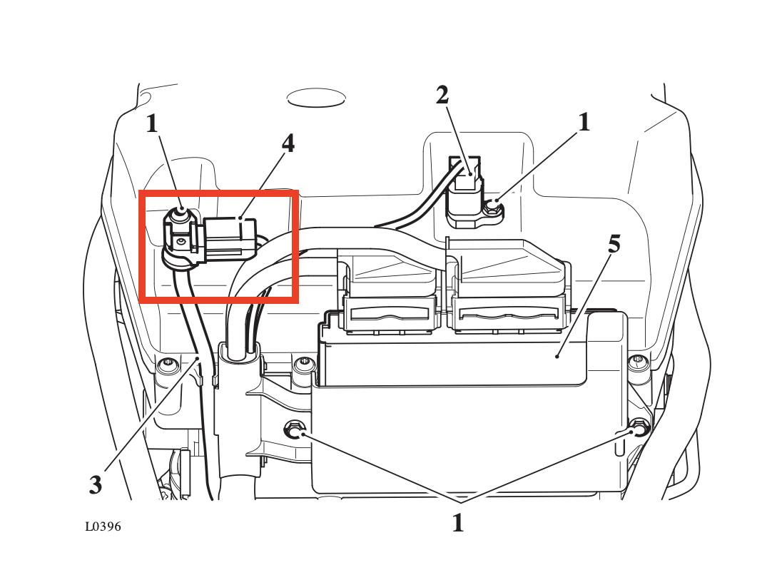

    To be transparent, I will note that the the hose connected to the MAP sensor was not as far as it could go. I believe the MAP sensor is the sensor shown in the attached image (although this is not a diagram exactly for the model I have).
    The only light I have is the "get your Triumph serviced" light. Which I begrudgingly ignore since I do my own service. (I understand that I could get rid of this with a "Dealer Tool" and possibly with TuneECU.)
    As it stands now, after doing this, I took the bike out an hour-long run and did not see this issue. I'm going to take the exact ride, clipped in the video, this weekend and see how it goes. (And hopefully not get stuck 20 miles from home.)
