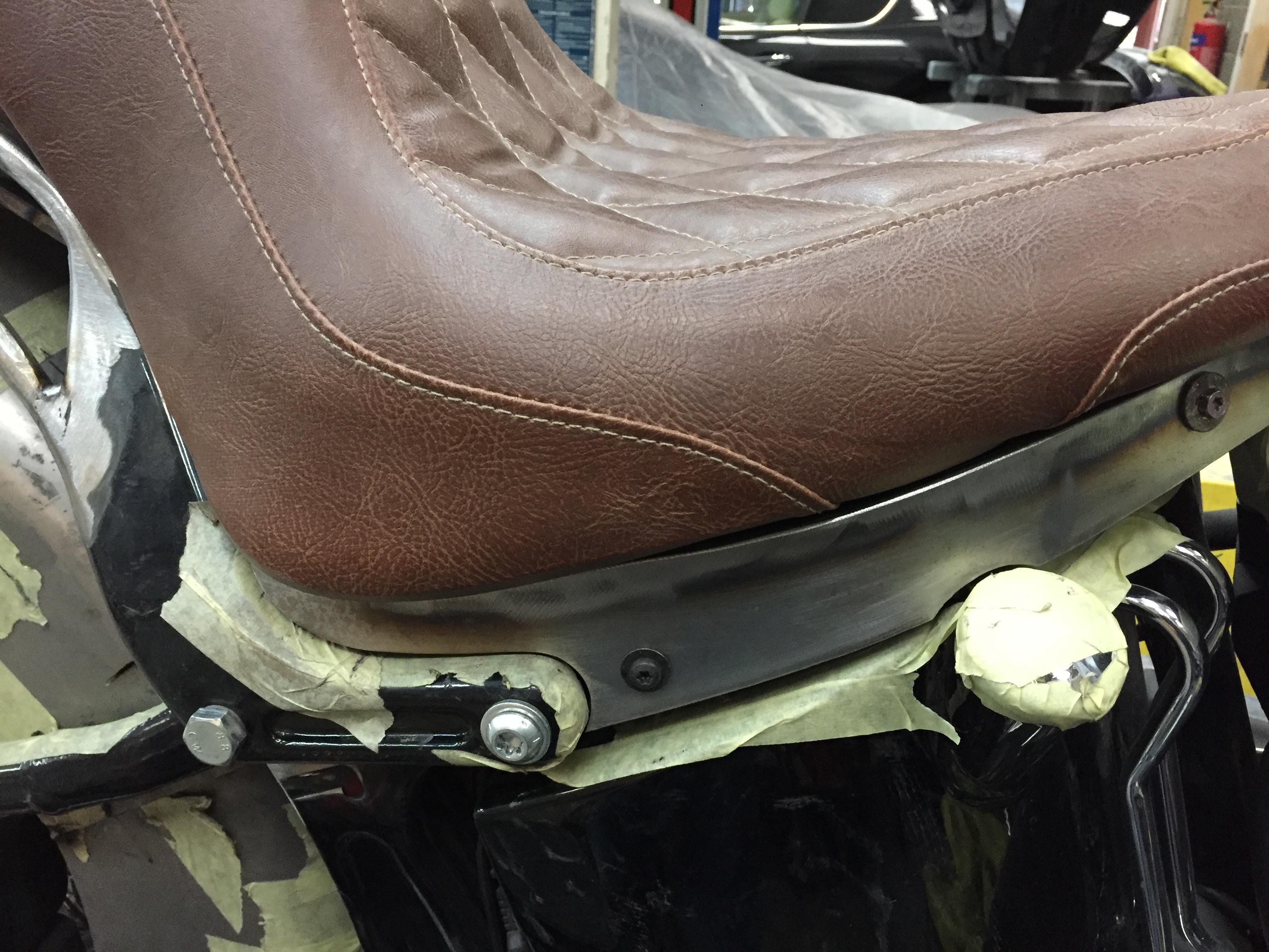

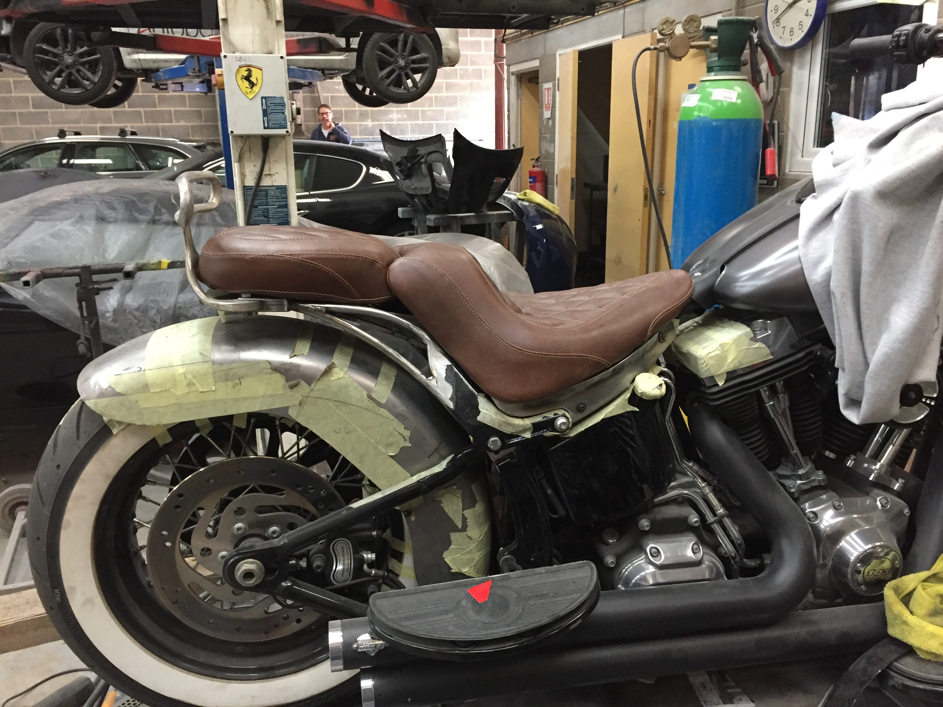

    I’ve just been modifying a customers Harley-Davidson and I needed to use the same methods 77DC3CCD-3B68-4C54-A8FB-F782958B8CA7.jpeg 291CD0B5-2DA9-4289-BE58-AC19D5CB383A.jpeg 86EDDDA4-2780-4E77-9BC3-D8467BF4BFF3.jpeg these are the radius’s you can achieve

    I'm not a lover of brown seats on bikes,but each to his own;) and why do people get work done on their bikes in the summer! :confused::rolleyes:
