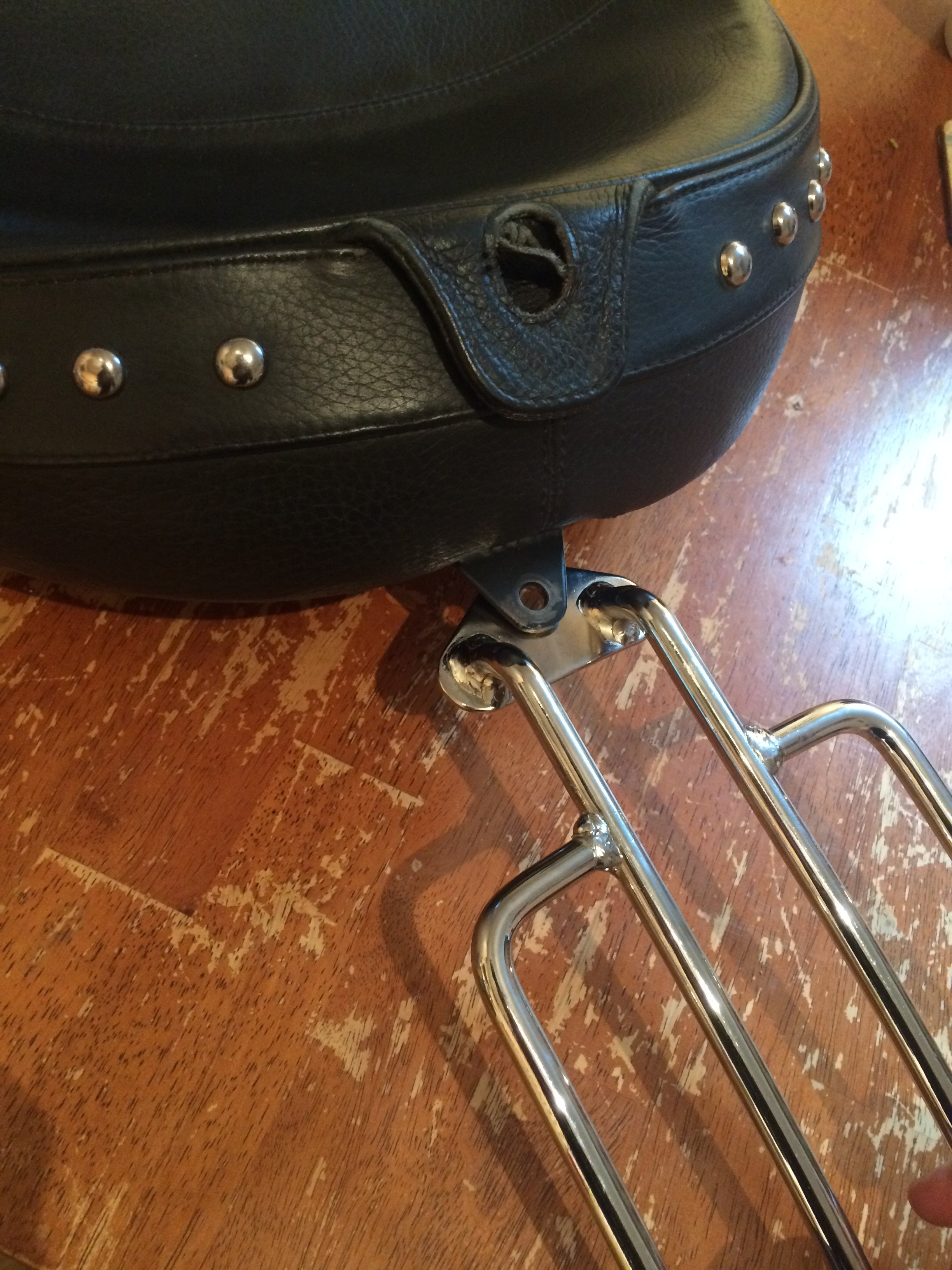

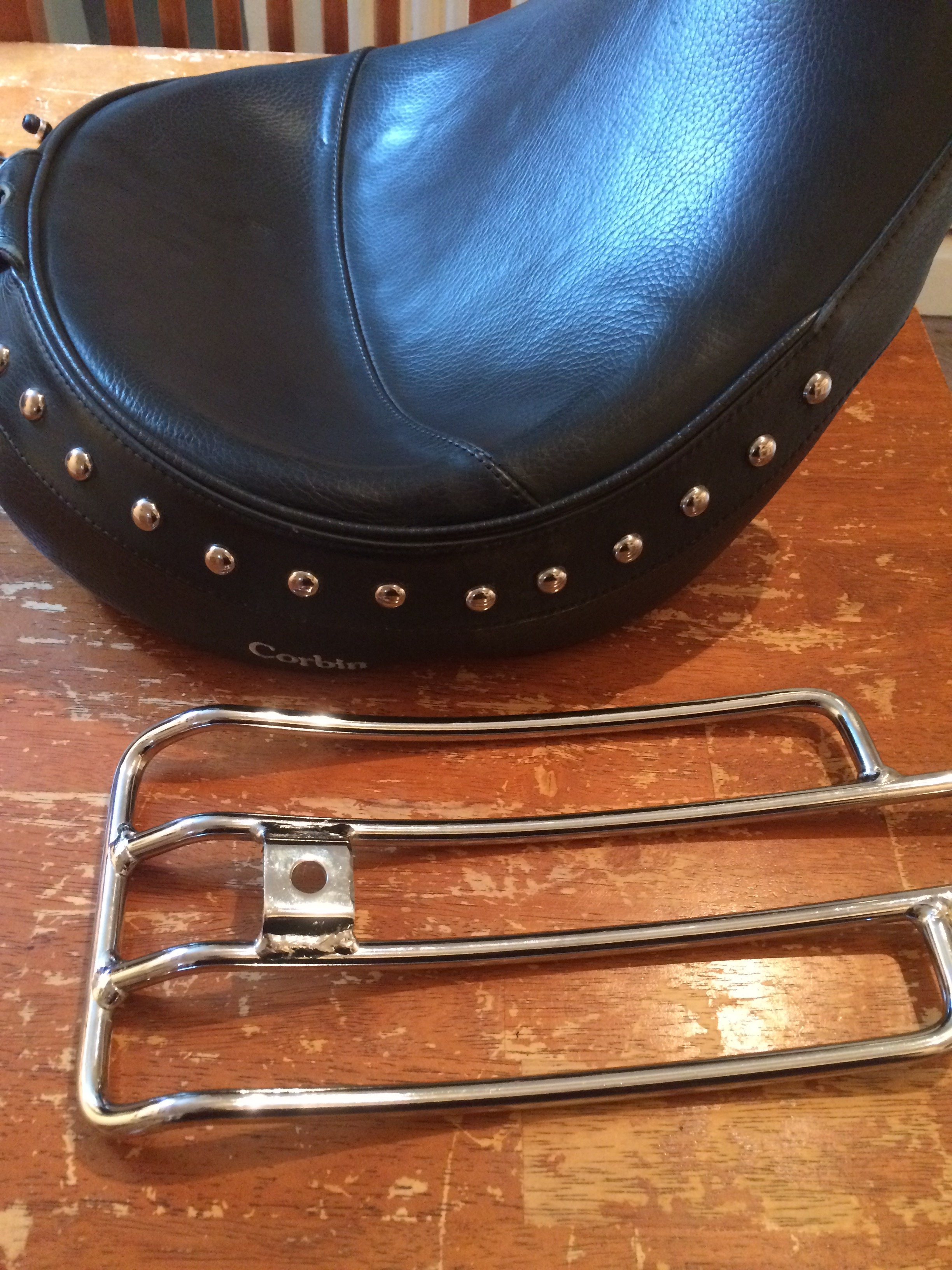

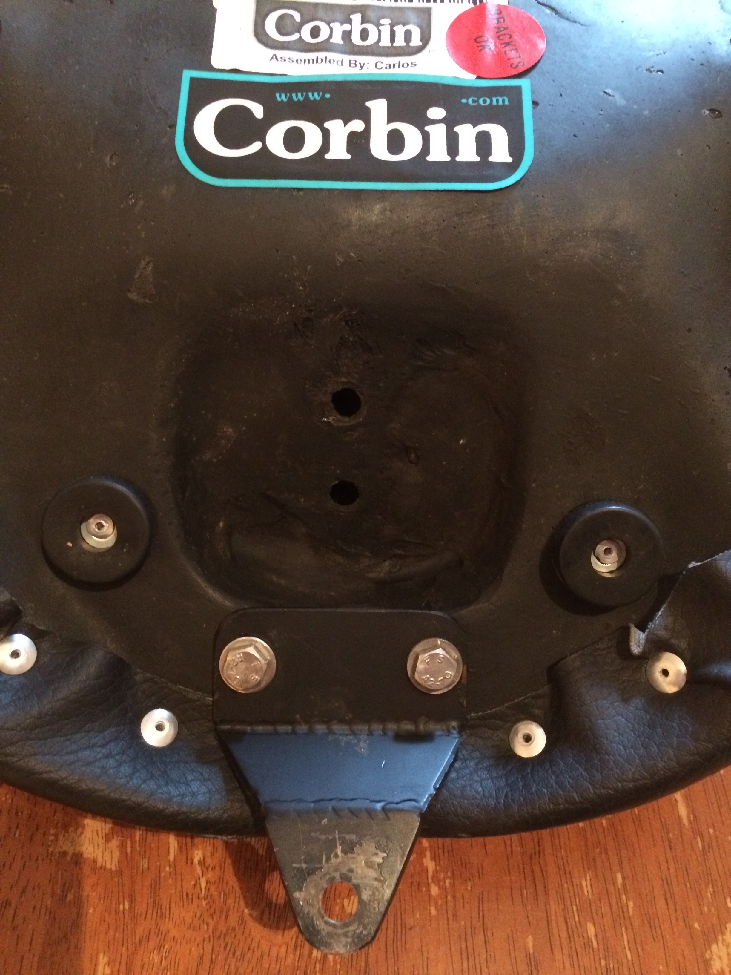

    Hi Scoot, I think that I have the same issue as you. I have a 2014 Speedmaster and I'd been trying to find a solo seat and luggage rack for it (apparently Triumph didn't make a solo option for post 2012 EFI models), anyway I found a nice second hand Corbin which came off a Speedmaster the same as mine. I thought it'd be easy enough to fit but the fittings don't match, need to replace the bracket for a single bolt of some sort that the seat can slot onto and also the front of the luggage rail. The most frustrating thing is that I can't even get my hand under the fender to release the bolts that are holding the bracket on, the space is so tight between the wheel and the fender. And I really don't want to have to take the fender off to do it! anyone got an idea here?
    Like you, I've seen lots of Speedmasters with solo seats, hopefully one of them can reply here and make this easy for us!

    Alisdair, I think you should be OK with a straight M8 bolt which is long enough to take both brackets. Such a the ones Dosers Dad linked to in post 4 here.
    Over on Triumphrat.net there's some chat about having to file the Corbin bracket (this may be regarding a Corbin pillion seat, I'm not sure). Also, it's easier to access the underside nut when the weight is off the rear end by using an auxiliary stand such as this one
    http://i.ebayimg.com/thumbs/images/g/A-4AAOSwhlZYty1i/s-l200.jpg
    Still looking for info on where I can find the slotted / shouldered bolt specifically for the pillion seat bracket to locate onto.....

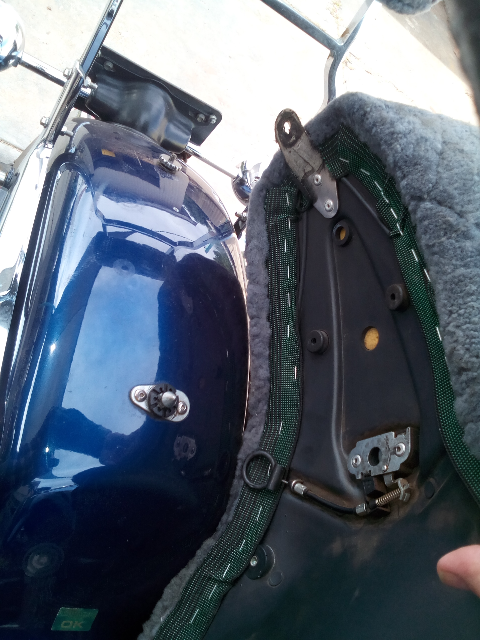

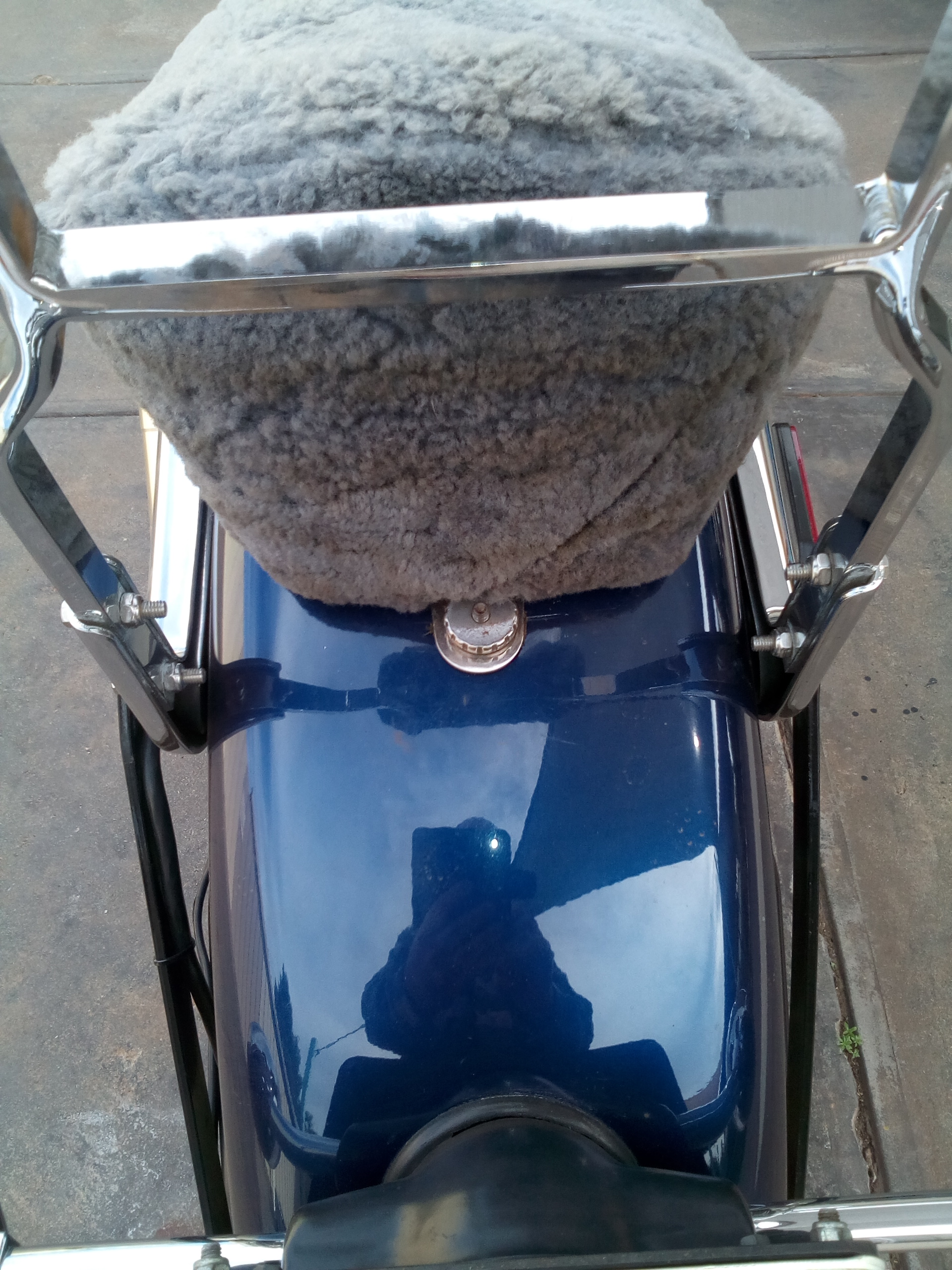

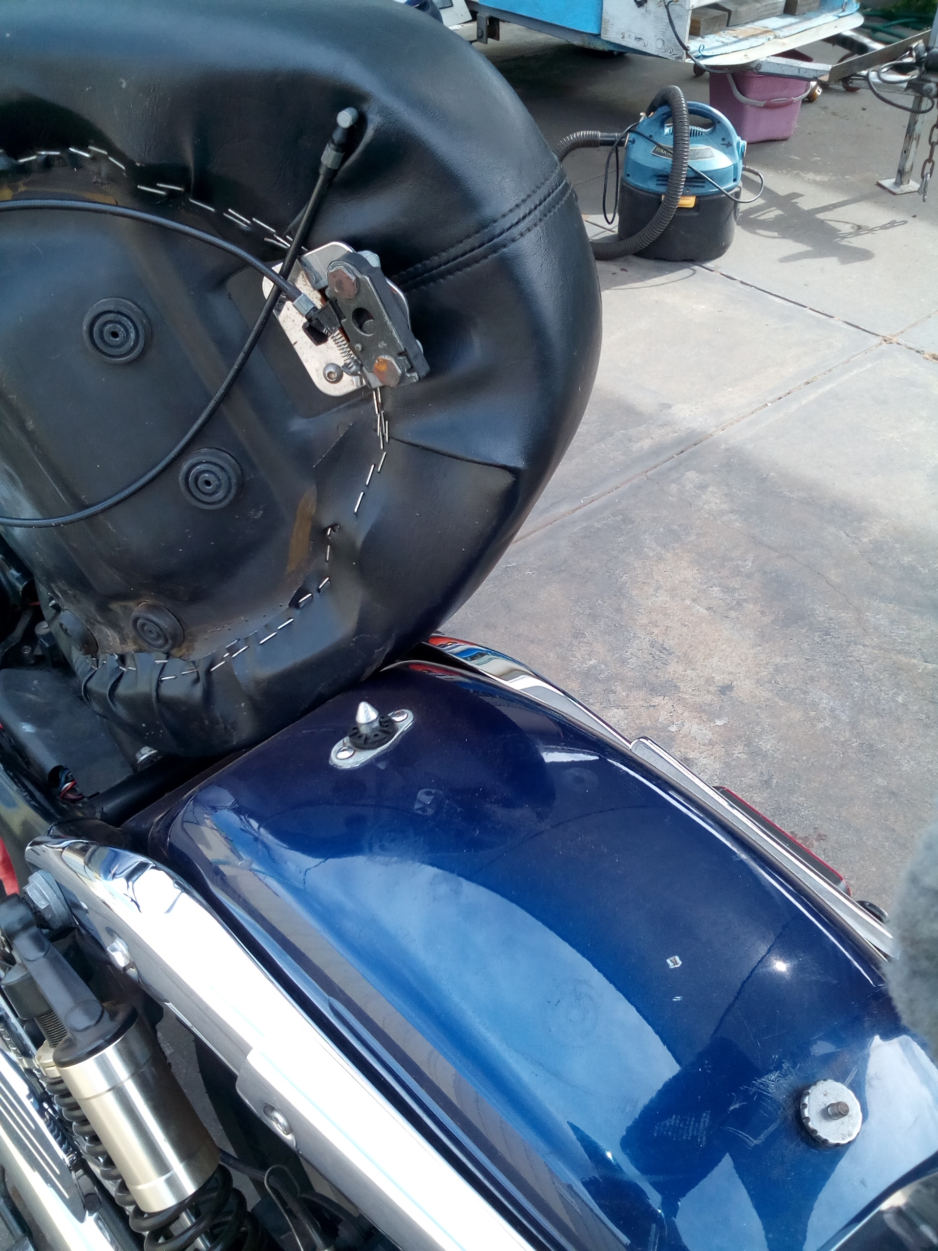

    You could do what I have done, I put a bolt through from underneath the mud guard ! And I had a knurled Nut made for the top ! I change my seat from solo to dual as and when required ! Just need to do the quick release modifications to the middle bolt for quick removal of solo/dual seat..
    See pictures above. Dual seat in place. And single/dual seats from underneath.
