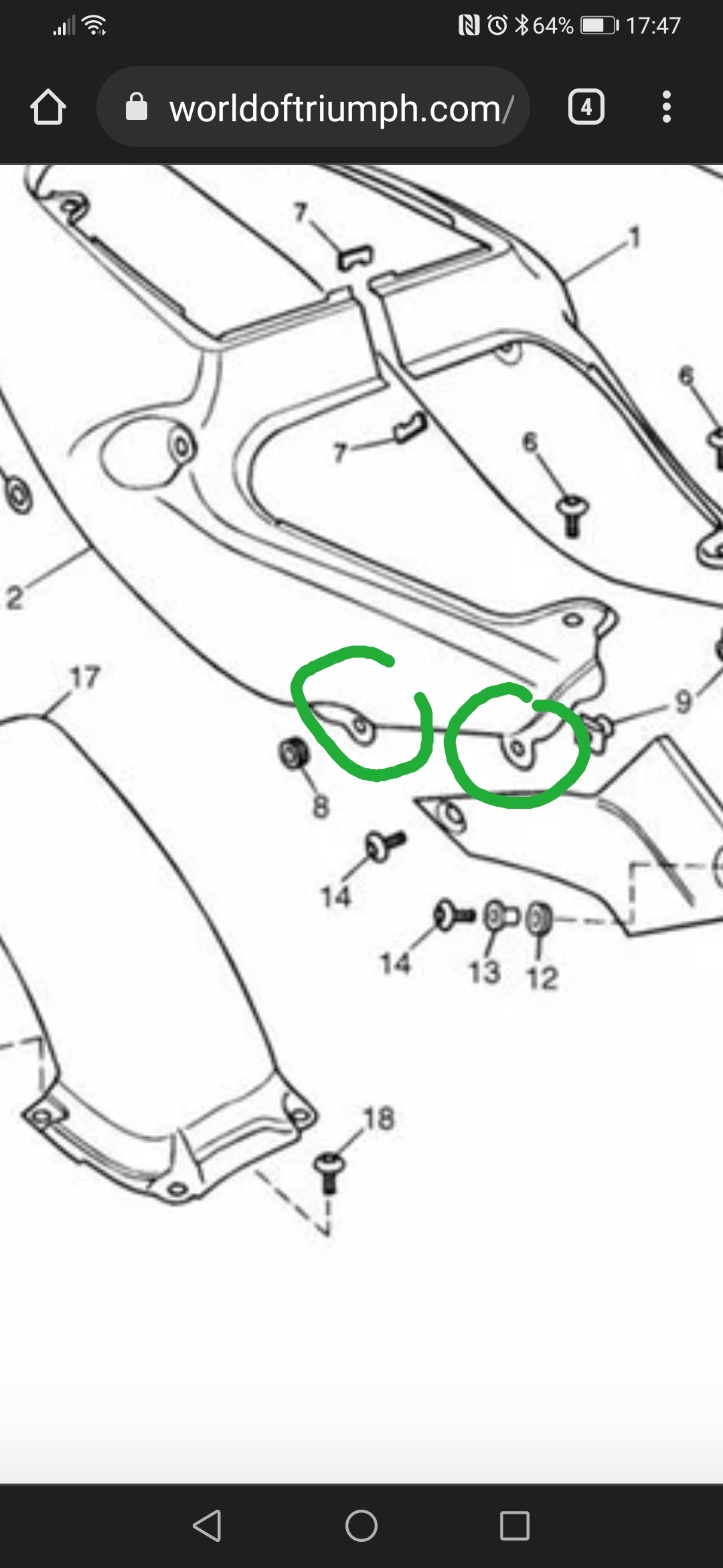

    I have the Speed Triple 955i, similar bike I understand (although am far from being an expert); and one "irritation" on mine is the little plastic tags on the seat and side fairings, that hold the screw fixing for the plastic (carbon fibre?) body inserts to fix to... A couple have snapped off...so those inserts aren't totally secure. If I can't fix the tag, or something (!?) it's gonna have to be a new fairing. These parts are getting scarce it seems...
    I don't know all the proper part names...I hope the above makes sense!
  6. DanielB
    DanielB Noble Member
    Jan 13, 2019
    887
    393
    Abingdon, Oxfordshire
    These bits, in green is what I'm trying to describe :p

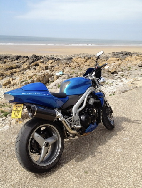

    As a PO of a 98 T595 and 2002 T955i and 2002 Speed T955i, the later bikes are the better bet although I loved my T5. Spun a rod bearing through running low on oil and fitted a later 955i engine which seemed somewhat smoother and was slightly more powerful that the original 128bhp

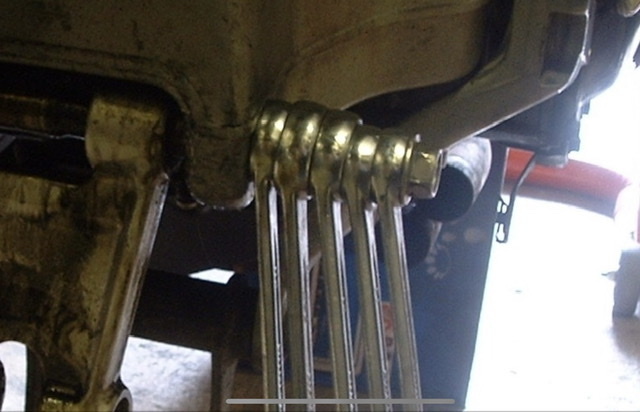

    Forks are basically Honda Fireblade items, rear shock linkage will no doubt be seized from lack of grease during services but are easily rebuilt if not so easily removed (use a stack of Spanners and the chain adjuster bolt to pull out the pin),
