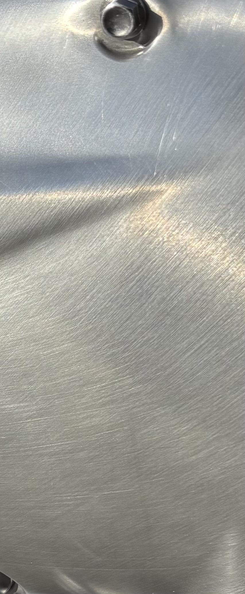

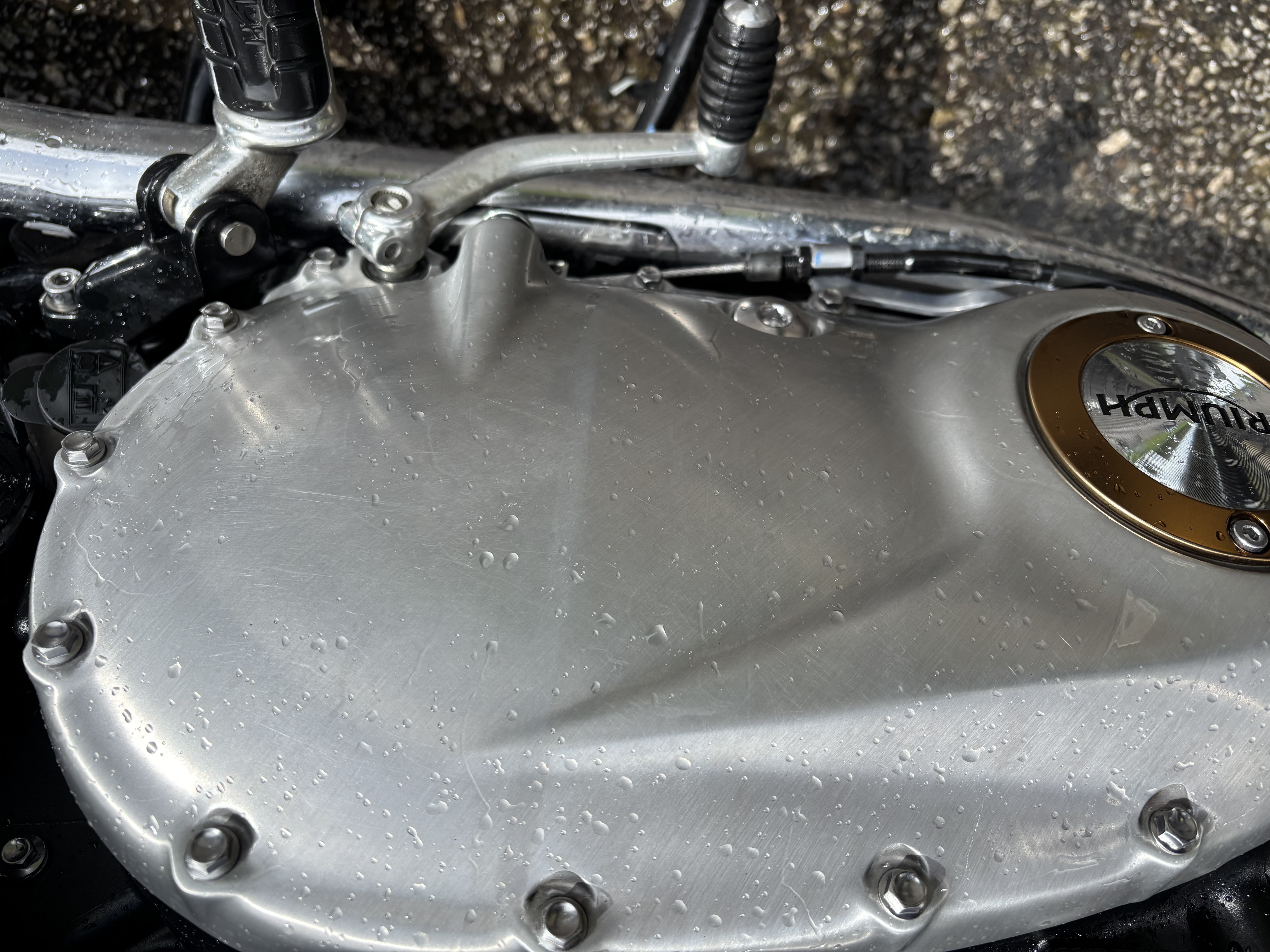

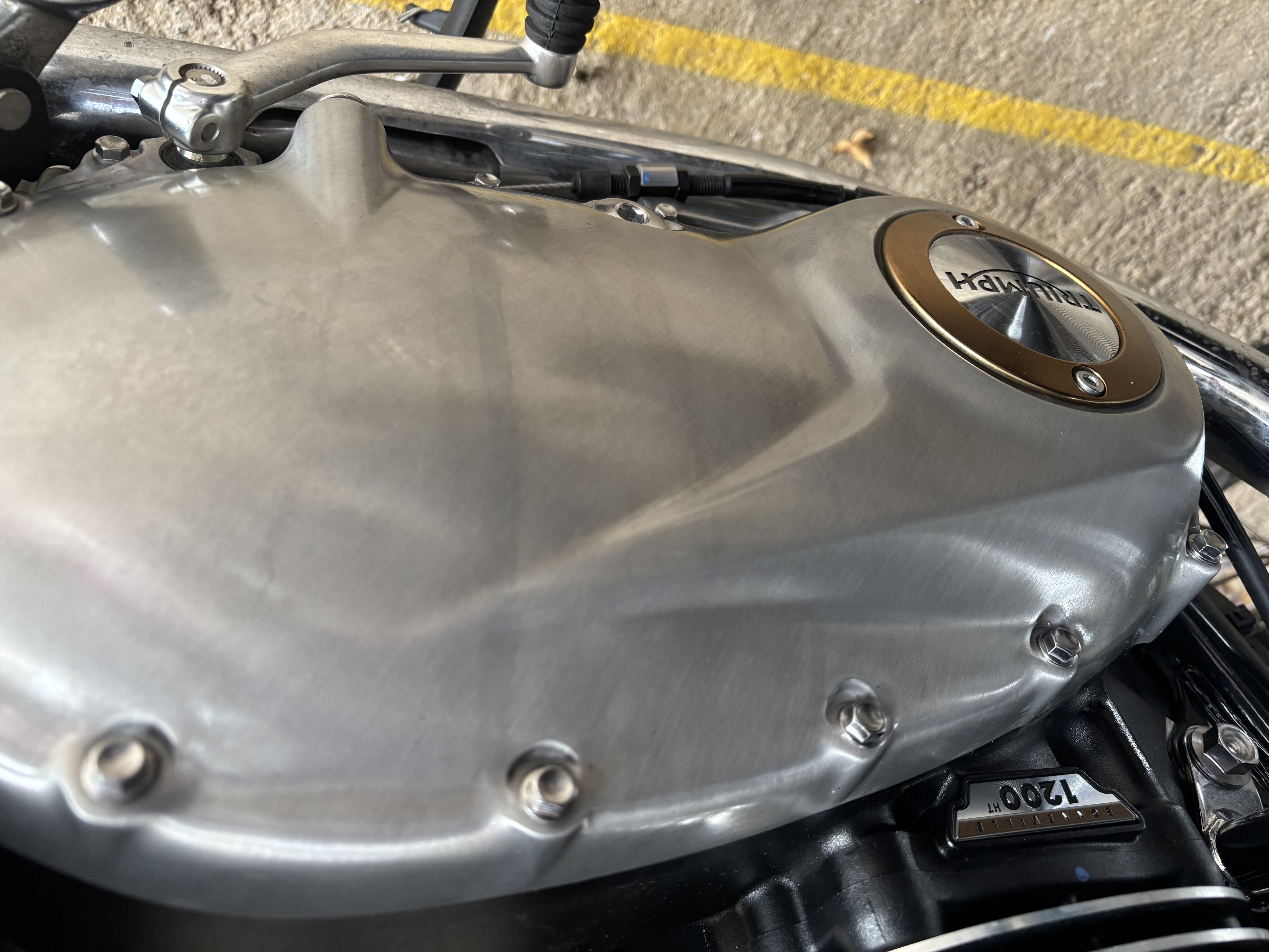

    Just had the first service on my new T120, only 8 days old.
    Rode into the dealership, the weather was awful, heavy rain.
    Rode the bike home, to be fair it was going better smoother than when I rode it to the dealership.
    Rinsed the bike when I got hope, popped it into the garage.
    The next morning I saw the casing, the dribble mark was caused by the cleaning fluid left on to long.
    Managed to polish it out. Took more than a hour.
    The dealership offered to collect the bike but i would rather work on it myself.

    Came across this YouTube link that shows a method of restoring the engine / gearbox casings back to a standard finish. Wish I had seen this first.

    Have also got T120, had it since 2019. You really do have to make sure no products get left or can run on the caseing. The scotchbrite method def works to get brushed effect.
    With winter on way you MUST not leave any road salt on the cases ,it will eat into them and leave very bad pitting. Wash them off with a bucket and brush then dry when get home. Only takes seconds Unfortunately I know the hard way. Polished mine out but can still see pitting up close.
