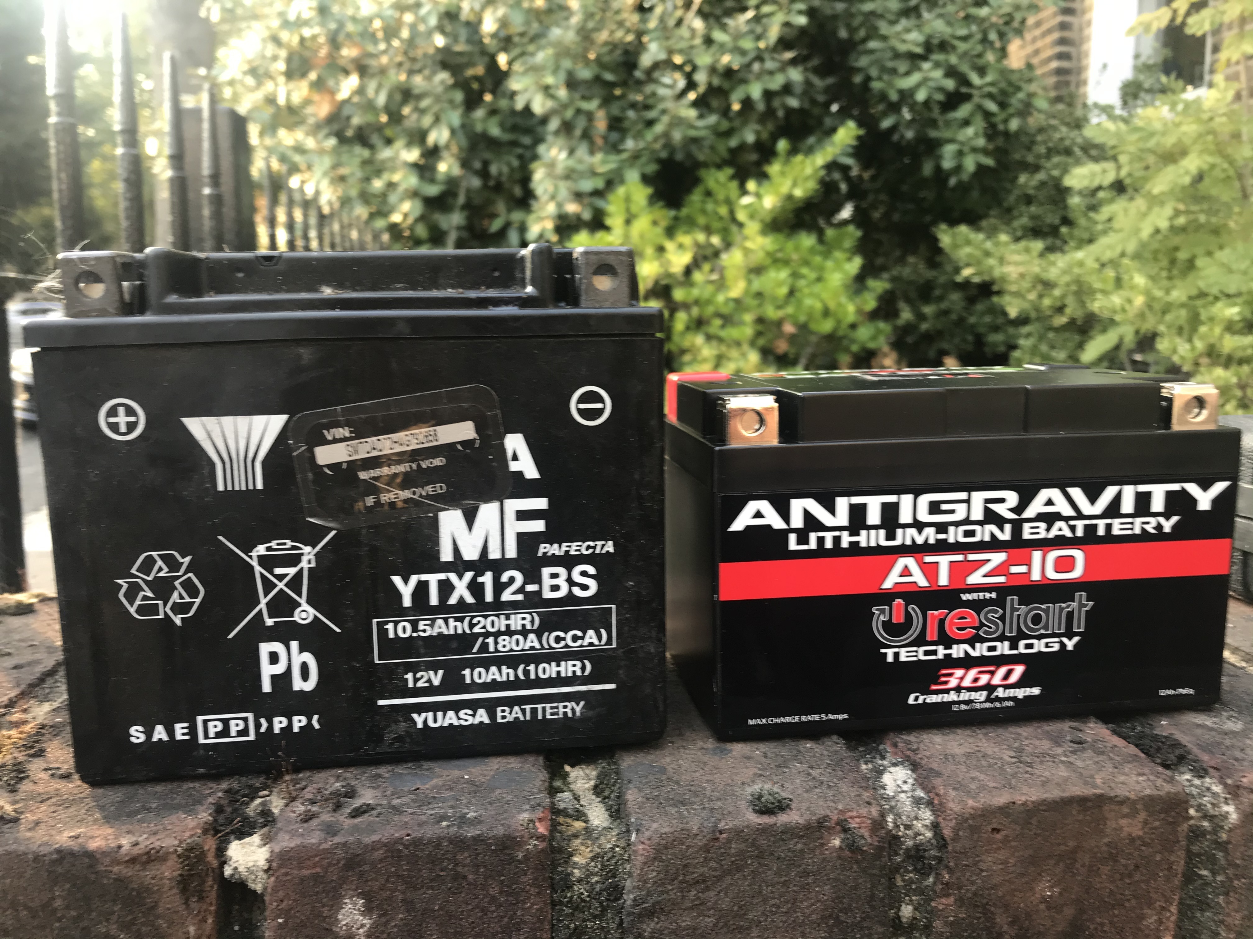

    Ive ordered an ATZ10 & Opi charger bundle from Antigavity UK. After reading the spec and USP of AG, I thought I’d give them a go as I had Shorai Lithium batteries On my last KTM, but Would also get DAT errors when it was cold. I will be reviewing the ATZ10 throughout the winter months to see how it goes.
    #5
  6. Heavymess’in
    Aug 9, 2020
    27
    45
    London, UK.
    Ok, so after speaking to Paul at Antigravity batteries UK, I went for the ATZ10. The USP Is the Re-Start fuunction which may come in handy for me as I tend not to condition my batteries over winter. It wiegted in at exactly 1kg on my bathroom scales as opposed to the Yuasa YTX12-BS which was 4kg. The AG went in easy, with a terminal post on each corner, so fitting is a doddle. There is now lots of room for the Power Commander 5 rather than sitting on top of the stock unit. Sub £200 for 3kg of wieght weight saving is ok in my book, and before I get any ‘go on a diet BS, im 6’1 and 79kg.

  7. capt
    capt Elite Member
    May 8, 2016
    2,140
    3,051
    western Australia
    I've had a lithium ion battery in my America for four years. No problems.
    Another advantage is much higher CCA's 290' as against 90 odd from original battery that was installed from new.

  8. Heavymess’in
    Aug 9, 2020
    27
    45
    London, UK.
    The Anti Gravity ATZ10 is 380
    odd CC! Much better than my old Shorai at around 180.

    Stuck it in straight out he box and left it for several days without starting the bike. The temp dropped to single digits and after the few days it cranked over no probs.
    It changes direction faster now. I really notice the difference when I have to dodge potholes and steel plates.
